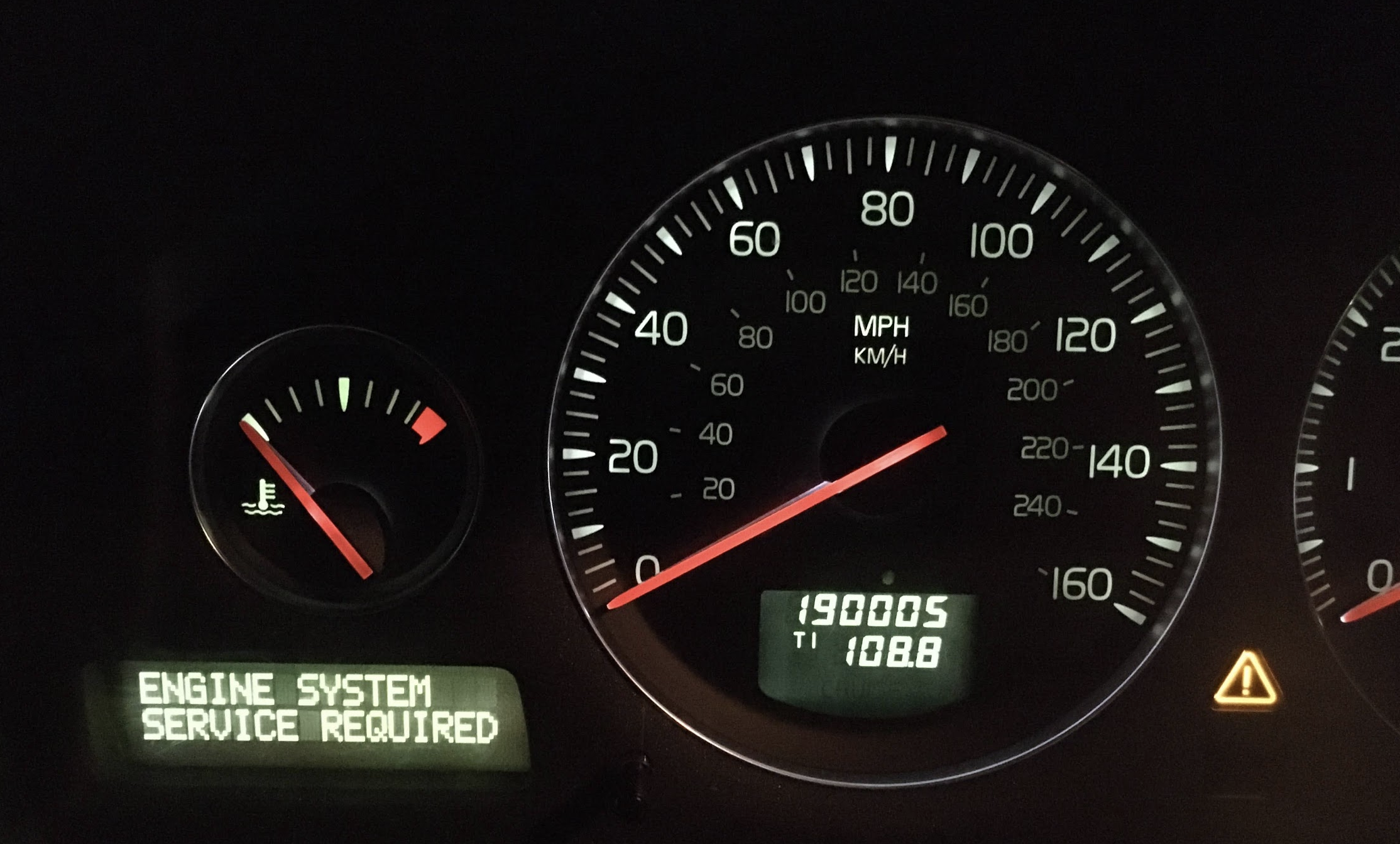

i went to check an hour later and it did strat but with this dash system service light, and the odometer on 190000...

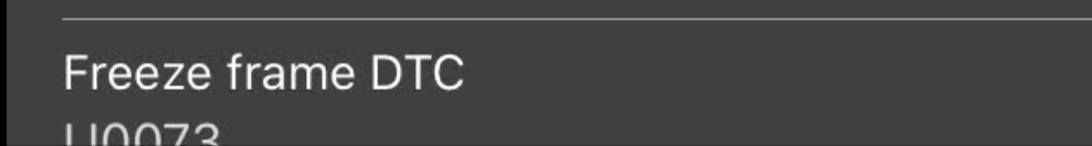

but I also checked codes and got U0073 code.

is this a built it 190000 error for service, I cant stop thinking its a built in "take it to garage' issue.
but probably not. what do you think ?

This may not be an easy one, careful with Volvo if they suggest replacing modules. Do you mean the odometer got reset to this new value? Being a 2004 I would look first at the CEM with a flash light for dry or wet traces of water (google up).
- Posts: 36137
- Been thanked: 4063 times
If it were 666,666 I would worry, otherwise it’s just another number.
xHeart
- Posts: 3321
- Joined: 03 Dec 2011, 08:05
- Year and Model: 2.0/3.2
- Location: Great Lakes - USA
- Has thanked: 116 times
- Been thanked: 119 times
Agree!abscate wrote: 07 Jul 2020, 05:24 If it were 666,666 I would worry, otherwise it’s just another number.
Start with a battery tester?
