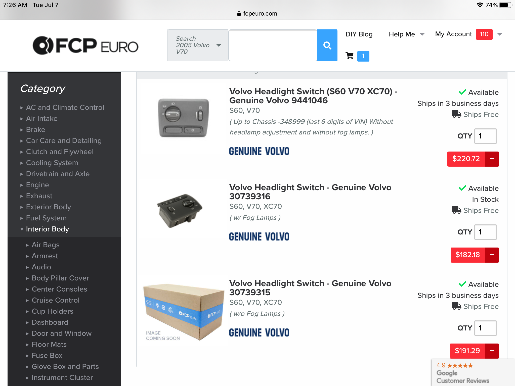

Three different part numbers for P2 LSM AND a chassis break
9441046
3073915
3073916
9441046
3073915
3073916

Kinda "spendy" as they say in Oregon.
Unfortunately, not something I'm likely to find at Harry's. Could be an Erie item.

Pop your out and post up your part number. I’ll be cruising by Erie twice monthly soon.

Volvo 3073916 should be what you need. They are $20-30 on eBay most of the time. Or find someone parting out an XC70/V70R/S60R or anything (P2) that has factory equipped fogs.
I’d send you my spare but it’s been repurposed.

I looked & I do have another LSM from a non-front-fog equipped P2 you can have just to verify if replacing the LSM will cease the flickering. To clarify, the LSM I’m talking about has rear fog light button only, no front fog light button. Or just grab the one out of your XC70 to see if it fixes the flickering.
