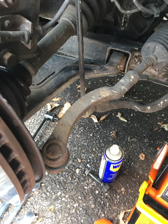

Today, I've decided to spend less energy to try to keep driving stable on the road, so I've changed my control arms. As you can see, there's a half bolt on place. That makes me think it hasn't been done recently...
The tie rod don't looks more happy , I'm a bit afraid to do that job for ne the first time but I 'm not gonna have the choice...

If you managed control arms then you'll find tie-rod ends to be very simple. Afterall, once the car is jacked up its only two bolts per side! A tip, if I may: make sure both sides of the car are jacked up. If not there will be a lot of tension on the ARB, making it harder to fit the new parts. It is still possible, but you'll need some serious leverage.
