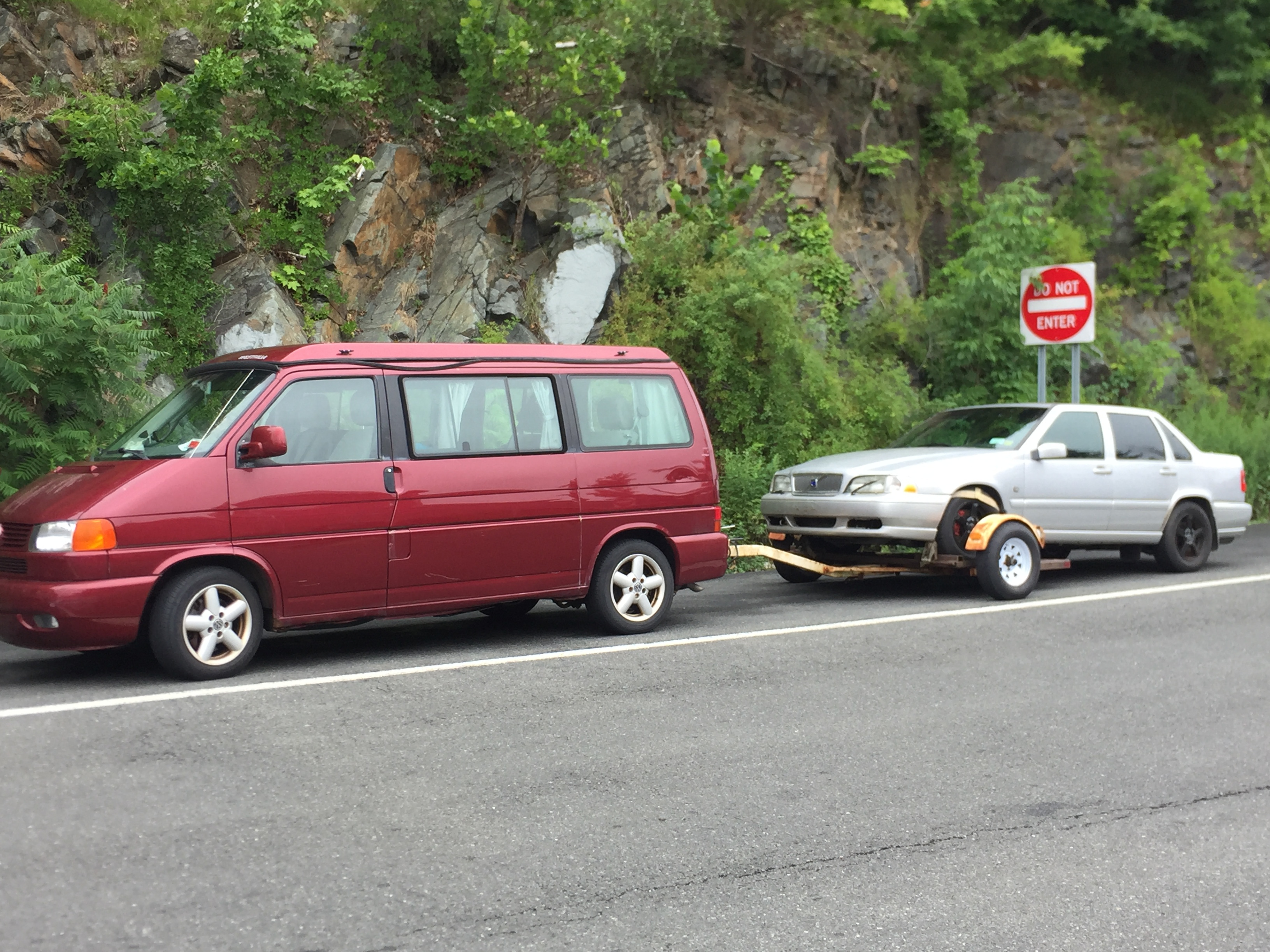

I had a good day though
It followed me home honey.....can I keep her? Can I keep her???

So what's the story with this one?
