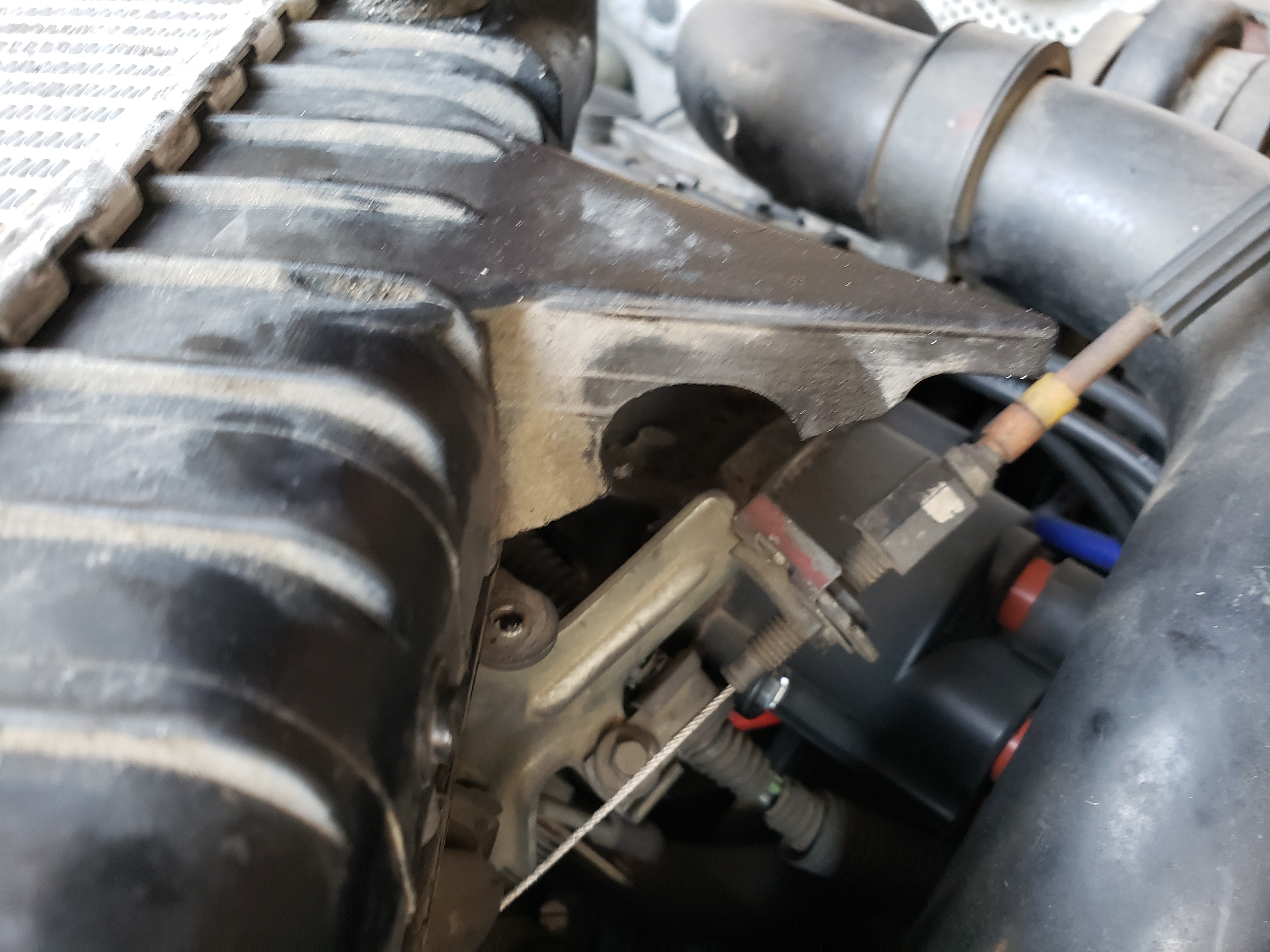

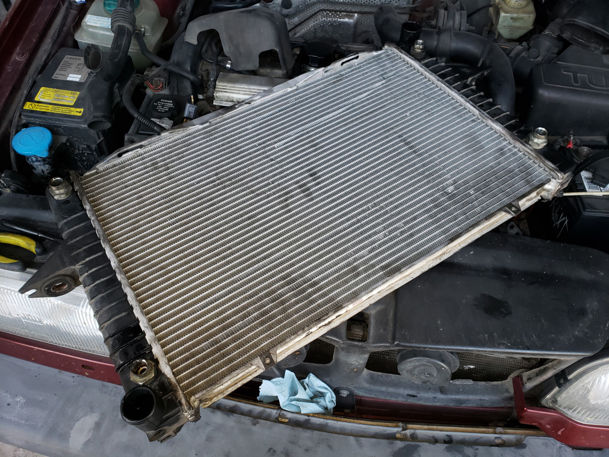

Made some progress on my radiator/AC compressor replacement. Discovered a deficit of various bolts. Driver side radiator mount was broken and the whole rad/IC/AC sandwich was leaning quite a bit. Turns out I have a Nissens radiator, it was replaced in 2009 after rear ending an expedition. Probably still has lots of life remaining but I'm not about to remove an old radiator and not replace as a preventive measure. The front engine mount looks about done.

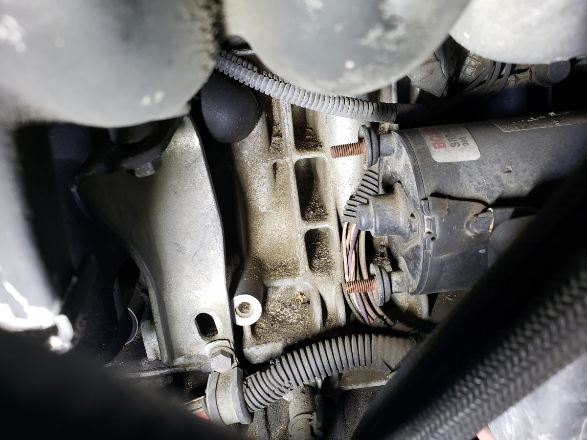

On a side note are these starter bolts suppose to be open and disconnected?

When those ears break on the radiator the plastic side cans take all the stress of the whole radiator intercooler and condensor sandwich bouncing up and down. This breaks them off, of course.
Those bolts on the starter are for the obsolete front starter mount ( towards front of engine, right side of car) that Volvo discontinued in 2003.
