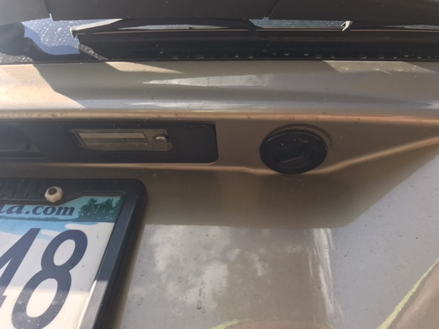

Nice. You might even have the last year with a key for the rear tailgate!Starbuck wrote: ↑02 Aug 2020, 21:04 I HAS VOLVO!

If it's a separate key for the tailgate, I did not get it. If it's a button on the fob, yes I have that.

The key-hole is to the right of the tailgate lever you pull on to open. It is covered with a black rubber plug (if you have one).

That’s actually not true. Some had them, some didn’t. My 2004 XC, 2004 V70 AWD both have them yet my 2004 V70R does not. I’ve never checked my 2001 XC.
