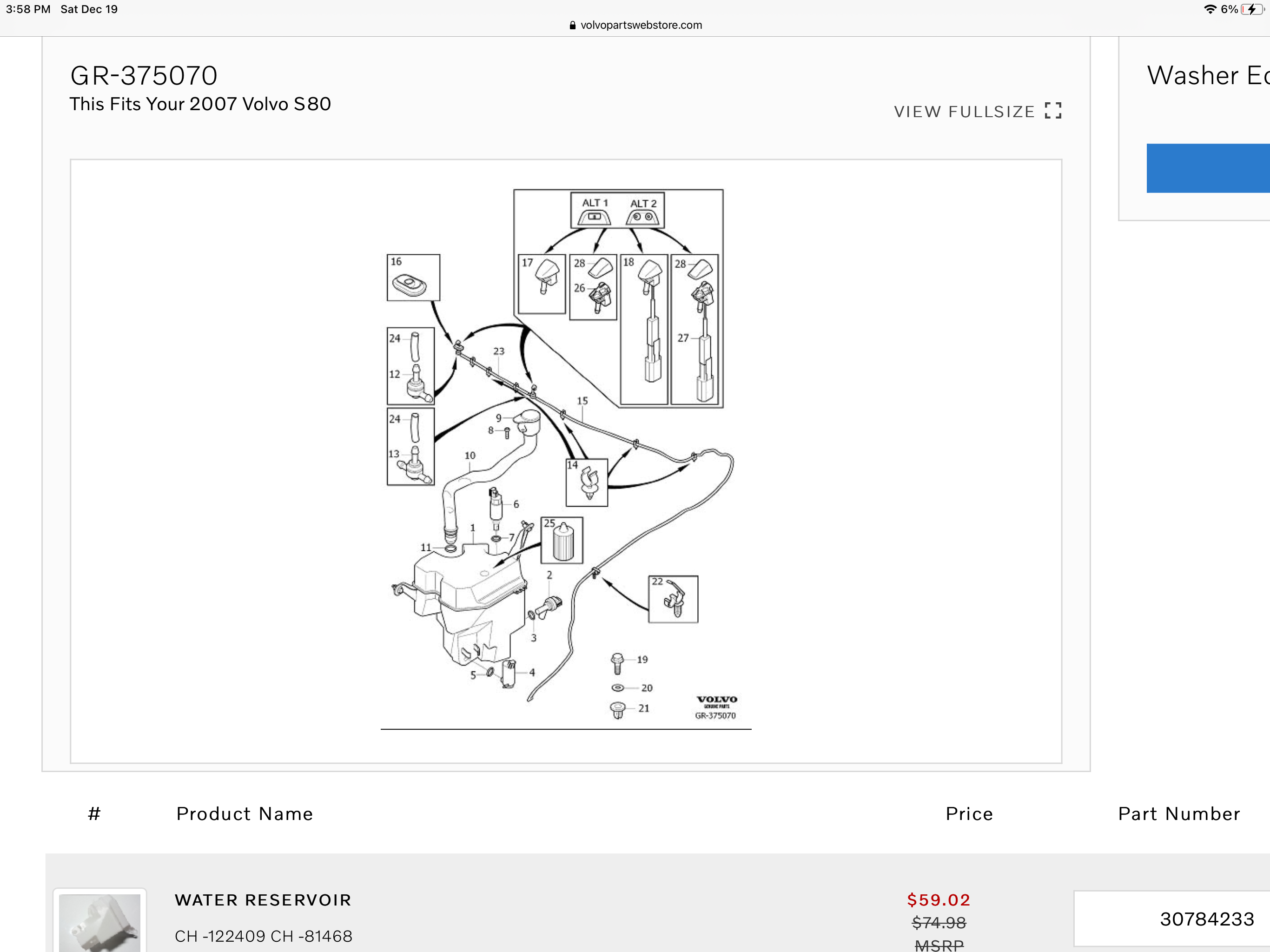

Parts 31425850 31425851
I think it’s part 15 here?

Steve, close but no cigar. I'm talking about the accordion, hardish plastic pipe that runs through the front bumper cover.

Is that “Sir Not Appearing in that Diagram?”

Correct.
