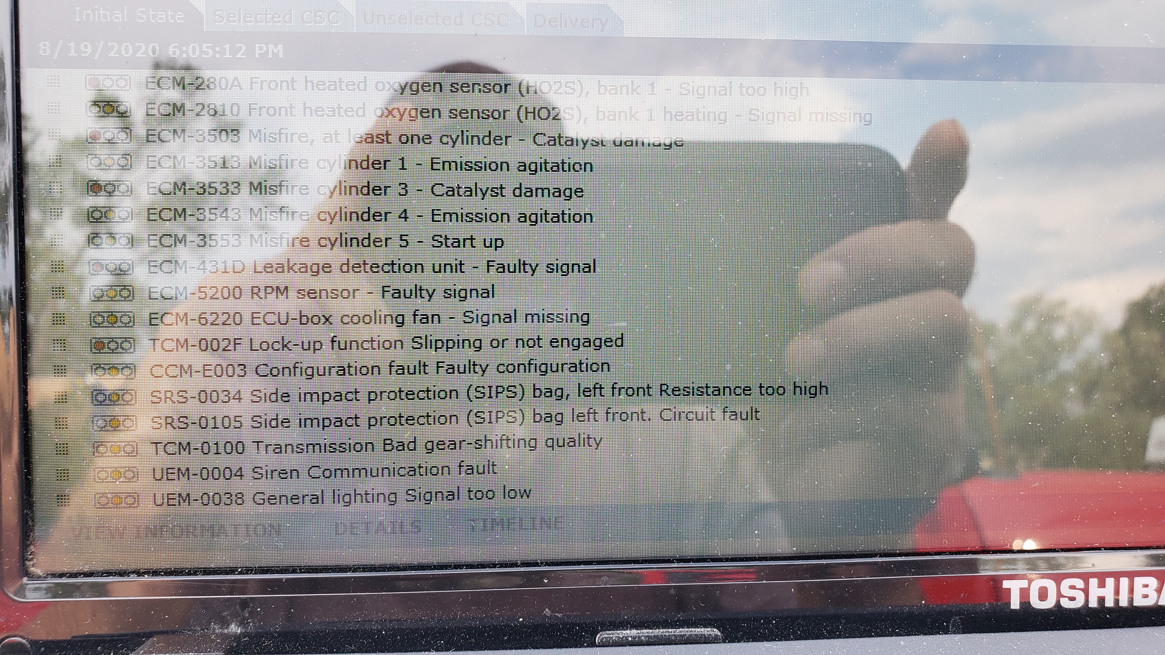

I hooked up the good ol' DICE (thanks again to 1MoreTech), and it really doesn't look good.
Does anyone know where I can rent the cam locking tool?
I'm sticking to the gasket plan, hopefully that will keep her going for a while.

Some or many of those codes are related to ecm cooling fan, if the fan fuse blows the computer overheats , goes nuts and throws codes from bumper to bumper. Fuse is in the engine bay.
Not sure you need the cam lock tool unless you want to remove the cam sprocket/hubs for some reason?
The cam cover compressor tool/s can be made from threaded rod from home depot.
I would order this cheapo kit.. $45 free shipping.

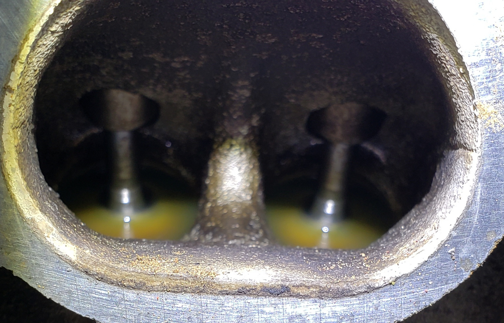

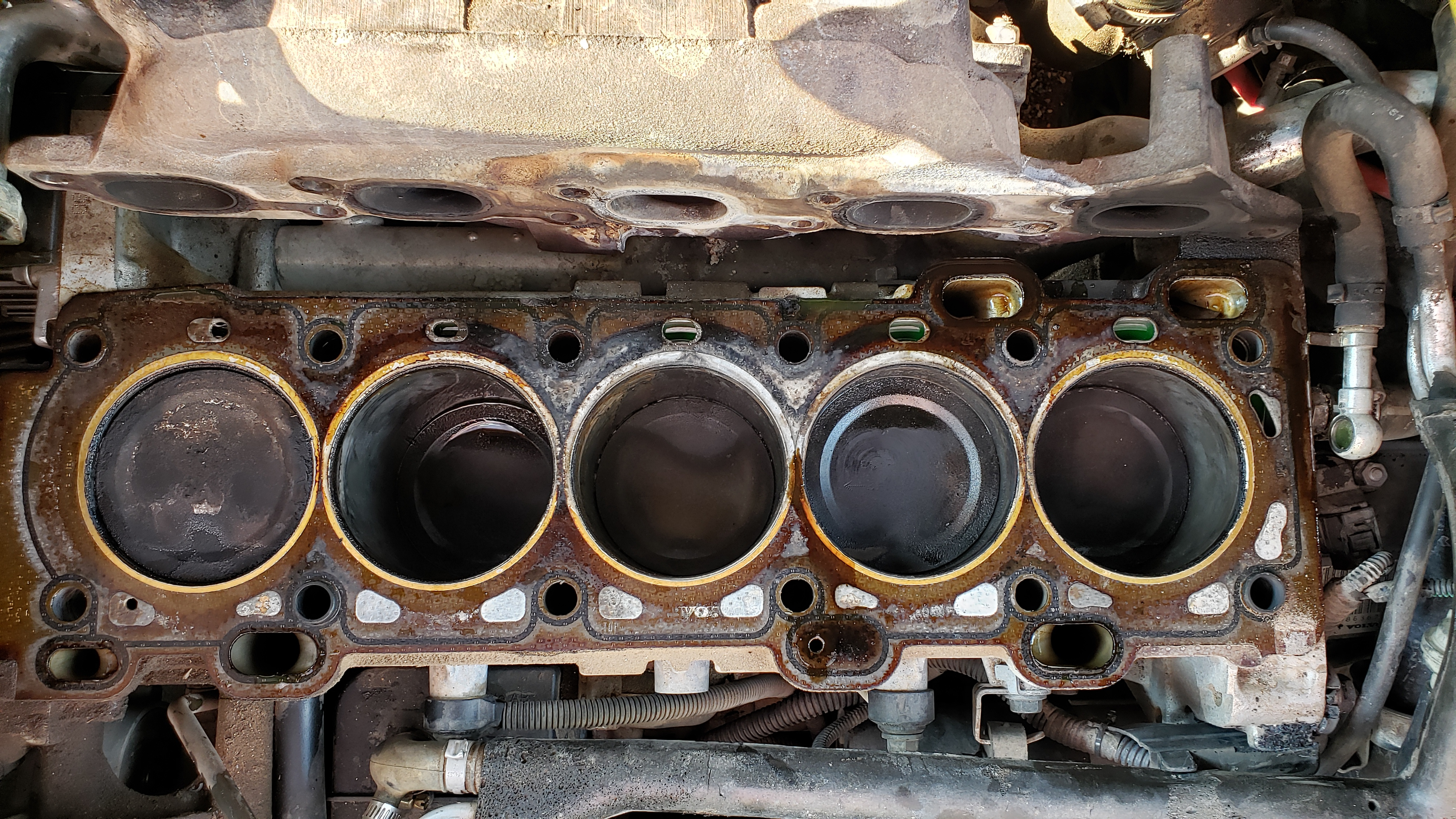

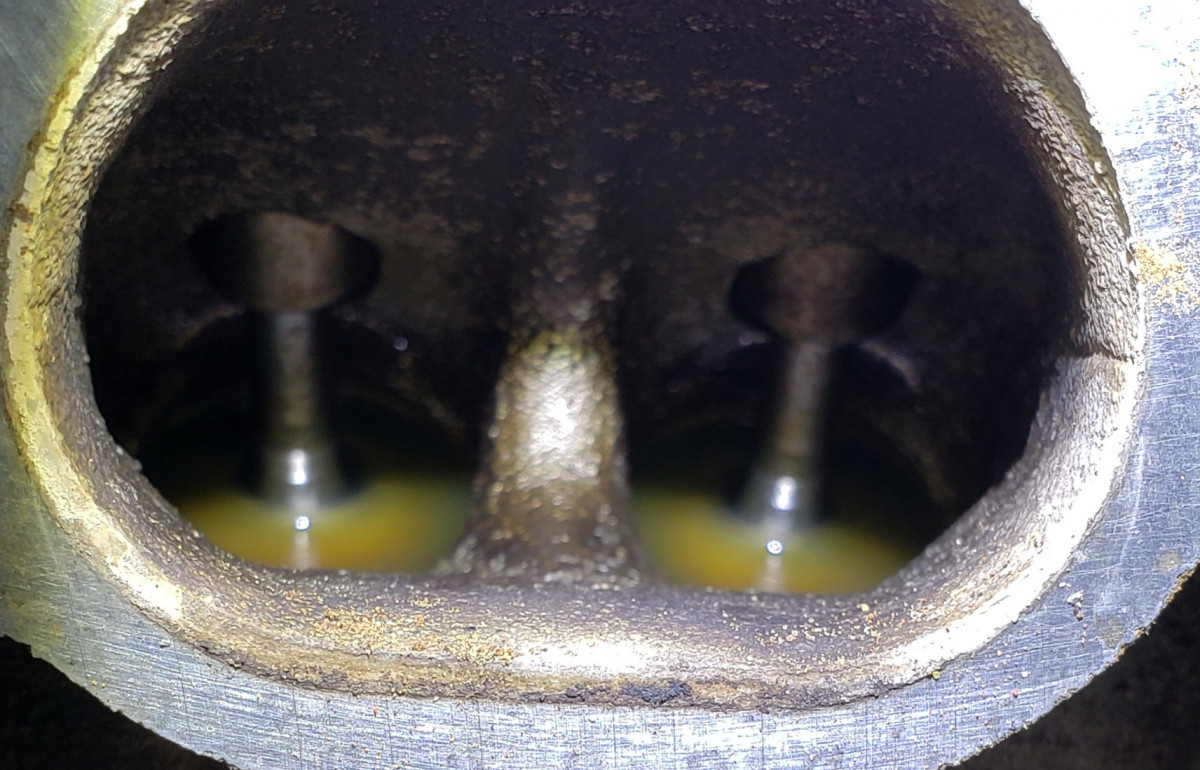

I got the head off.
Please tell me there is a reason other than a cracked head. I found coolant sitting on top of the #3 intake valves.
Also, would a 2004 2.5t work in my 2003 without changing ecm?

Probably cracked head or just head gasket
You can’t move ECM units in Volvo’s after 1998

I'd have a machine shop check the head, it might just need a quick shave.

I'm having a hard time rationalizing the coolant in the intake (only in the head) if it's a gasket problem. I can't see the path from the water jacket.
Yes the gasket looks to have failed, to me at least.
