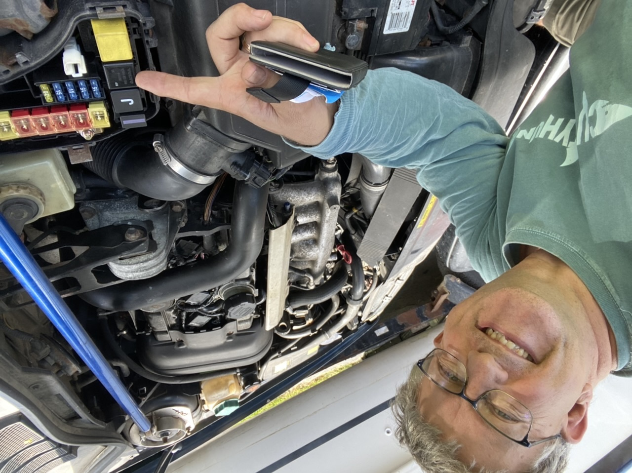

Was checking my fuses and relays and figured I'd investigate why I don't have an airpump relay. I also don't seem to have an air pump based on the diagrams I've looked at. I started a thread about it but I'm wondering if it means it was deleted, or never had one..

'99+ P80s never had air pumps. The relay is still shown on the fuse box, but it was never there from the factory. VVT took place of the air pump on RN engines.smacknab wrote: ↑20 Aug 2020, 08:28 Was checking my fuses and relays and figured I'd investigate why I don't have an airpump relay. I also don't seem to have an air pump based on the diagrams I've looked at. I started a thread about it but I'm wondering if it means it was deleted, or never had one..

Unless you are special....bmdubya1198 wrote: ↑20 Aug 2020, 09:09'99+ P80s never had air pumps. The relay is still shown on the fuse box, but it was never there from the factory. VVT took place of the air pump on RN engines.smacknab wrote: ↑20 Aug 2020, 08:28 Was checking my fuses and relays and figured I'd investigate why I don't have an airpump relay. I also don't seem to have an air pump based on the diagrams I've looked at. I started a thread about it but I'm wondering if it means it was deleted, or never had one..

I'm gonna need proof of the pump being there...
