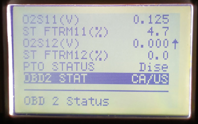

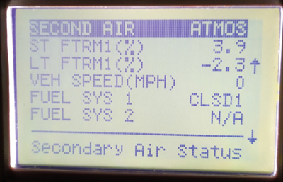

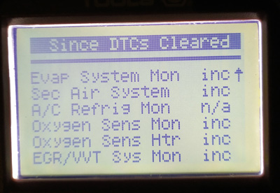

The SAS delete code will come the next start after the code is set,so two start cycles. It’s looking for very lean Oxygen leveksin the oxygen sensor ( OXS) during cold start indicating excess air is getting pumped in by the pump. The diode is lowering the OXS voltage , we are lucky the system doesn’t check that the level ones back up after it turns the pump off.
Your EGR will take a long time to go ready because you don’t have one
Post up your monitor list and status!

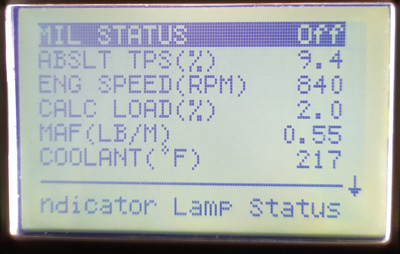

Here are my monitors:
And here's my data... seems like I'm getting no reading from my 02 sensor, bank2:
The fun doesn't stop... :)
