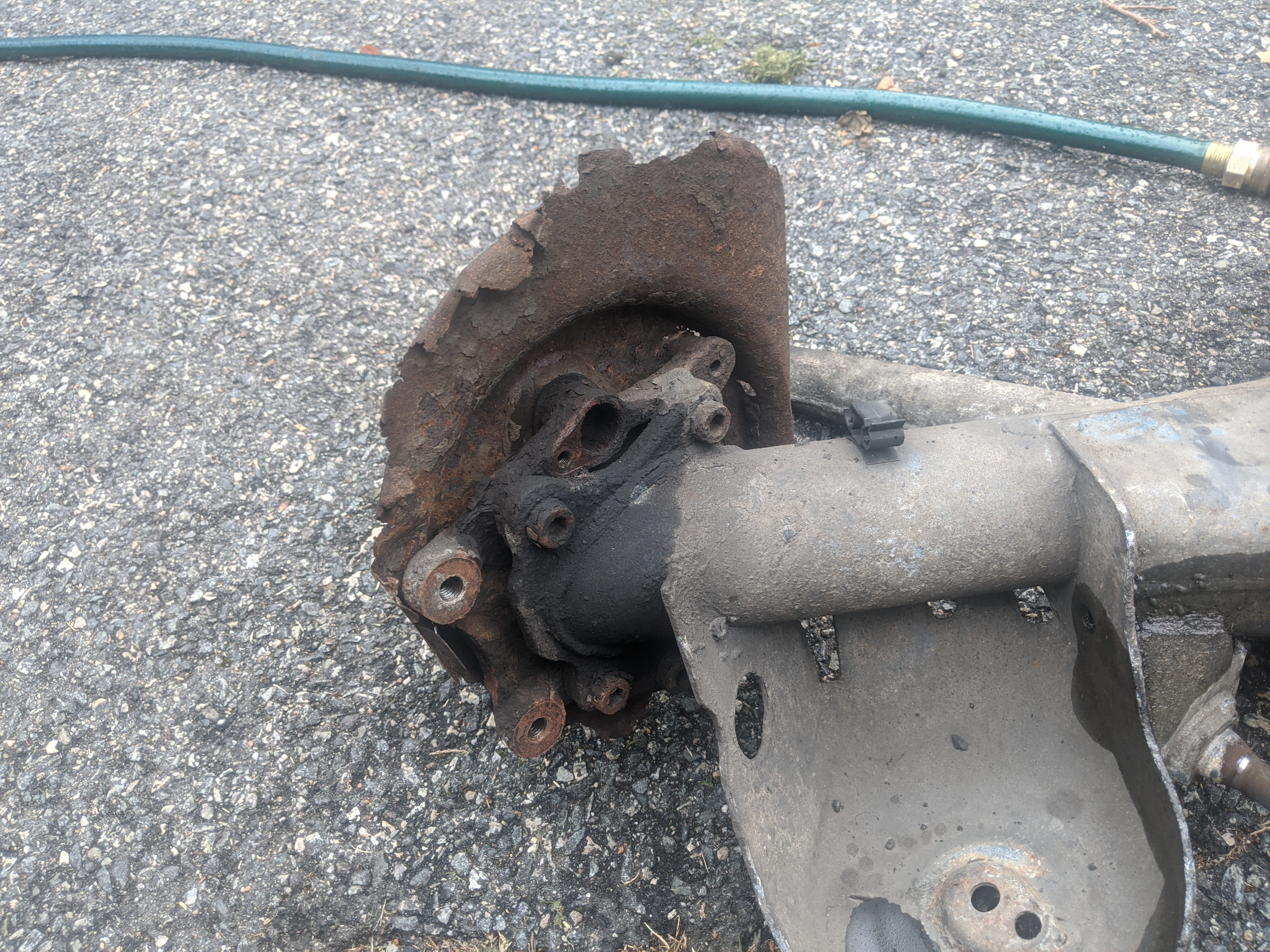

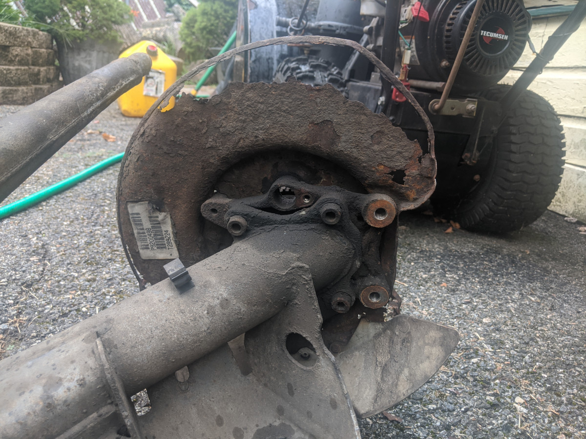

Pulled my old trailing arm off today and I'm 90% done putting the car back together. Pics to show how bad my brake dust shields were. I also replaced one of the metal plates at the top of the rear springs which has rusted through. And new parking brake cables because mine were seized and made it so I couldn't get the cable unhooked.bmdubya1198 wrote: ↑23 Aug 2020, 23:08 MAN that thing was rusty... probably the rustiest P80 I've ever seen! It had a small hole through the floor just behind a driver seat mounting bolt.
07 V50 T5 AWD M66 ~146k miles
- Posts: 6338
- Joined: 30 December 2014
- Has thanked: 304 times
- Been thanked: 517 times
Oh yeah, that's pretty crusty!
