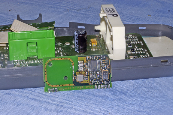

I had an intermittent problem with my key fob not working years ago and it turned out to be a bad component on the receiver board in the rear view mirror. My problem was temperature related, when very hot the key fob wouldn't work and I was able to pinpoint the exact component on the receiver board (crystal oscillator) using a heat gun.
I had originally took the car to the dealer and they said they couldn't determine the problem and thought it was either the CEM or UEM(in rear view mirror), both approximately $1000 a piece to replace at the time and they wanted me to pay for both if the first one didn't fix the problem. Disgusted with the dealer I found the problem in receiver board and purchased a used rear view mirror from the salvage yard for $50 and transferred the receiver board from the salvage part. Transferring only the receiver board eliminated the need to buy and reprogram the main UEM board in the rear view mirror. The receiver board is the small vertical board attached to the main UEM board (see photos). It's somewhat tricky to remove the soldered connections of the transmitter board but doable if you're careful and have a good solder sucker tool. What makes it difficult is getting all the solder off the connectors and the use of small individual connector clips for each soldered connections.
Not sure if your problem is the transmitter board or not but wanted to provide you with this information. If you have two key fob's and both don't work then there is possibility it's a problem with the receiver board. Does you sunroof work, which is controlled by the UEM? Have you done the reset of the UEM by unlocking and locking the front door with your key several times?
- UEM receiver removed from main board.jpg (132 KiB) Viewed 15816 times
- UEM receiver.jpg (137.92 KiB) Viewed 15816 times

nice pics, ive found on my 2001 xc70 and other Volvo's is the solder goes soft and just needs to be reflowed with new solder. I think you can test to see if its transmitting a signal using an analog TV if you know the frequency. Does anyone know??
