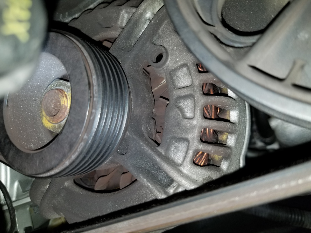

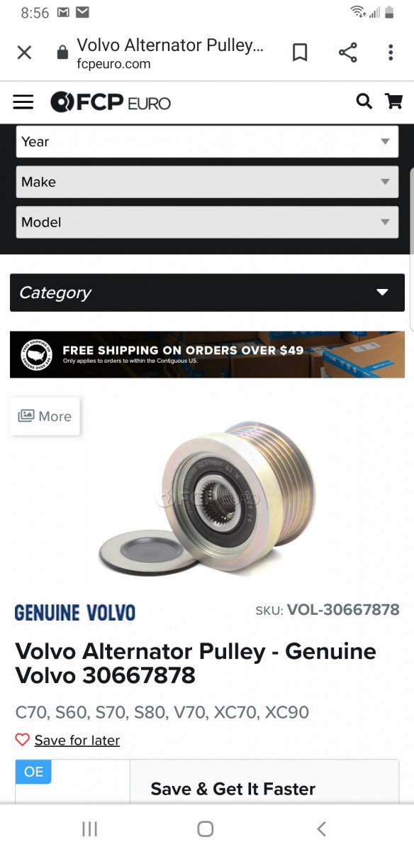

All you have to do is look at the pulley? Thank God Volvo did not put the freewheel style on my S80 T6. It's one less thing to go wrong and really Volvo wasn't going for mpg or worried about every ounce of power with the T6. Here is my pulley which is not freewheel type on my T6. Notice the difference between the picture of the Genuine Volvo replacement clutch pulley and my pulley on my T6. The clutch pulley does not have a open center. I've been lucky as my alternator is factory still at 203K June
