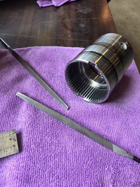

Update: I've been doing some late season camping so I just got back from the machine shop with my Bevel Gear with TIG welded sleeve. One of the things I wanted to mention that I did before I got the sleeve welded was to file the splines on the sleeve where they mate with the transmission output shaft such that I could slide the sleeve on and off the transmission to the depth that it needs to be with ease. My concern Is that with the Collar Sleeve welded to the BG input shaft, it would be difficult or impossible to overcome the resistance caused by the interference fit off the Sleeve and the transmission output shaft and it wouldn't go on all the way, worse yet you'd never be able to get it off once it was on.
Filing carefully and fitting took about 2 hours with 2 very high quality triangular Bastard cut files of varying coarseness. I didn't want to take any more material off than absolutely necessary.
Filed Sleeve.jpg (172.05 KiB) Viewed 2357 times

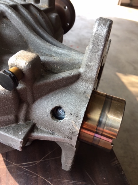

The welding was done with a TIG welder and the assemblage was cooled after each weld so as to not burn the seal for the input shaft which is about an inch away from the welding site. Also, the Bevel gear is full of gear oil which will help with cooling. Runout was checked at the end of the sleeve and found to be 1 1/2 thousands of an inch. I'm confident that the 3 inch lip seal on the transmission will forgive that amount of imperfection and provide an adequate seal.
Tig welds.jpg (118.91 KiB) Viewed 2357 times
All thats left to do is plug the hole in the Bevel gear case, polish up the sleeve where it meets the seal with 1500- 2000 grit sandpaper and install it tomorrow. I'm thinking I will seal the mating surfaces with a thin bead of viscous grease, reason being is that I would like to be able to see if it has any leaks from either the transmission or the bevel gear.

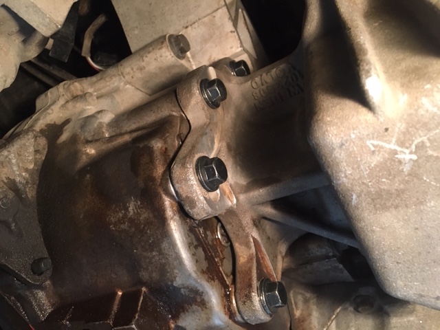

Bevel gear install: Bevel Gear went in fine today but I ran out of time and didn't get the propshaft reinstalled.
New Bolts.jpg (112.62 KiB) Viewed 2347 times
I learned something new regarding the top two 13mm bolts for the BG though: if you maneuver your hand through the exhaust/cat tunnel by the O2 sensor wire, you can easily access these bolts with a 13mm wrench. The remaining three are easily removed or installed with a standard ratchet or wrench.
Best Access.jpg (99.58 KiB) Viewed 2347 times

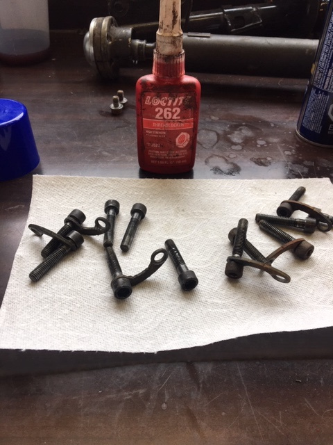

I like to drop the exhaust by disconnecting the 2 rubber hangers at the differential and the third rubber hanger on the muffler and then set the muffler on the floor, you'll also have to remove the propshaft bearing support and the brace just aft of the subframe. This step doesn't take long, about a dozen 12mm bolts, then swing the exhaust system out of the way towards the driver's side.
Make sure the 12 bolts are degreased and dry, and then use red Loctite when installing them. I probably should have bought new bolts but reused the old ones. The front six were a metric 8 size and the rear six were a metric 6. One of the front bolts had a slightly mangled Allen key hole and was a little sketchy to tighten. I'll probably get one next time I'm at the auto wreckers and replace it. The other tip I would give is to use a good quality Allen key to tighten both the front and back ones and tighten them in sequence. This step takes a long time because you can only reach about 3 bolts in the back and 2 in the front before having to put the car in drive, spin the front wheels, put it back in park, and then tighten a couple more. I would highly recommend marking the bolts on the final tightening with a Sharpie or similar marker so you know where you're at and don't accidentally miss one.
The best way to tighten the front bolts is with an Allen key, theres enough room to access the bolts through the exhaust hanger such that you can turn the Allen key about 110 degrees. A 6 or 8 inch Allen key will be of sufficient length to get enough torque on these bolts, similarly with the back.
Propshaft bolts.jpg (126.51 KiB) Viewed 2337 times
