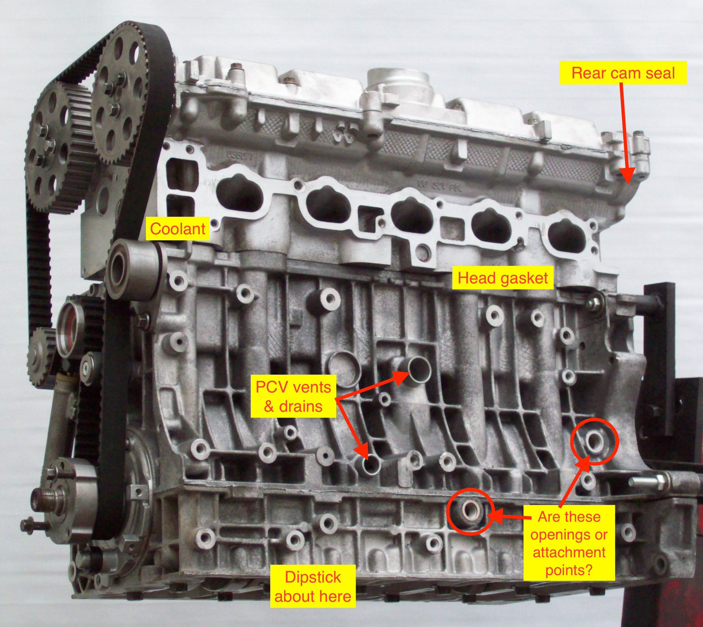

What is this T and fitting with the red arrow here off the long crank gallery? I found this in a very old MVS post.

I'm pretty sure that is for the oil pressure sensorBlackBart wrote: ↑20 Sep 2020, 13:21 I looked at that. Possibility. There's an oil drip on the bottom of the manifold - unless it's spraying from way down there...

That makes sense - it should be the lower one about in line with the crankshaft centerline.

The rearward port in that image is to insert a special crankshaft locking tool.

That looks like a high pressure oil bypass dumping back into the panBlackBart wrote: ↑20 Sep 2020, 13:21 I looked at that. Possibility. There's an oil drip on the bottom of the manifold - unless it's spraying from way down there...
I'll check the cam seal at the distributor. I've had a PCV elbow hose split on my P2 and it really sprayed oil all over the front side, so that's suspect as well.
There's an even sheet of oil running down the side of the pan - a long trail of drips, rather than a big spot.
