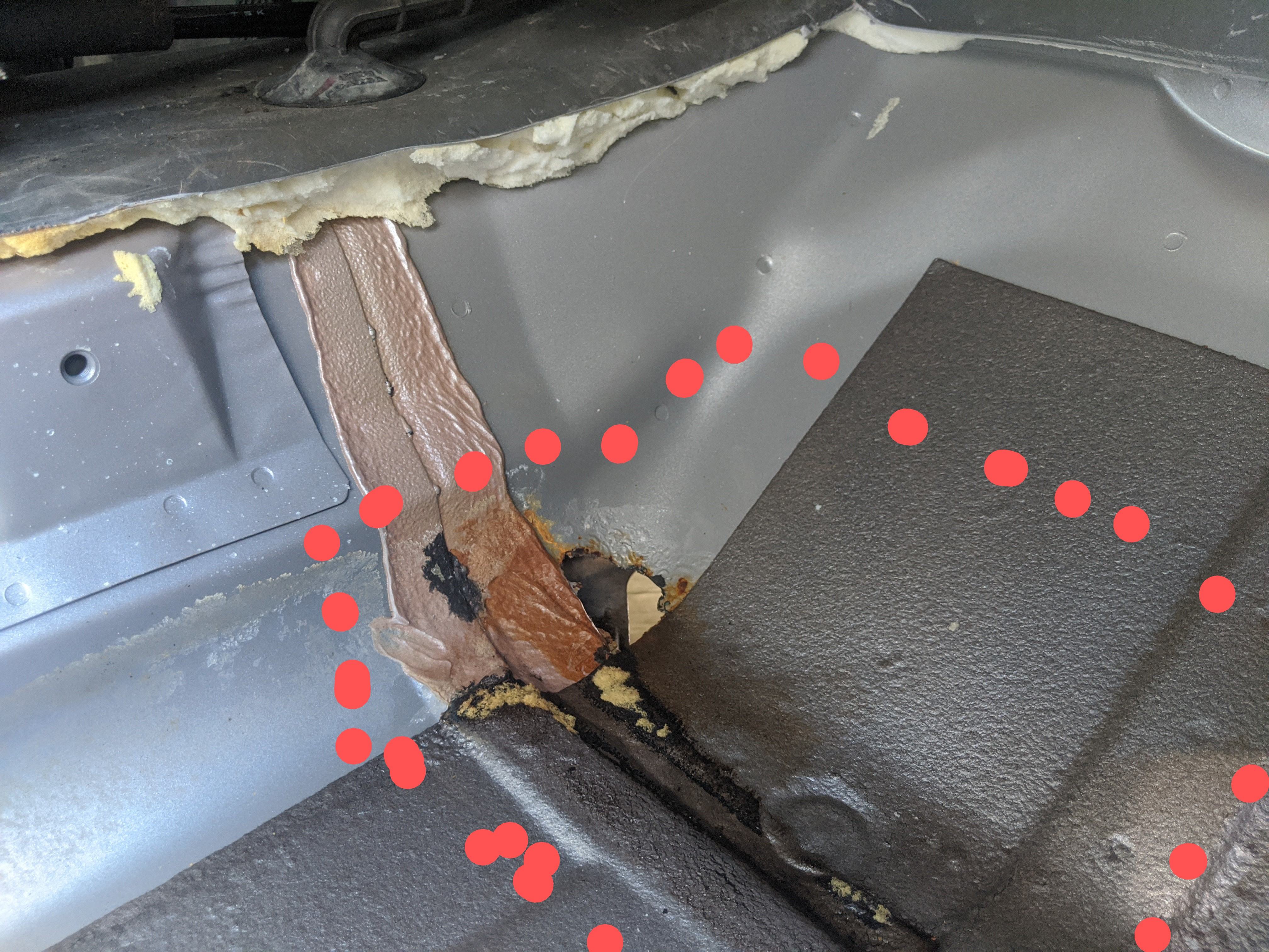

Installed my STB and lower rear brace on the 854 today.

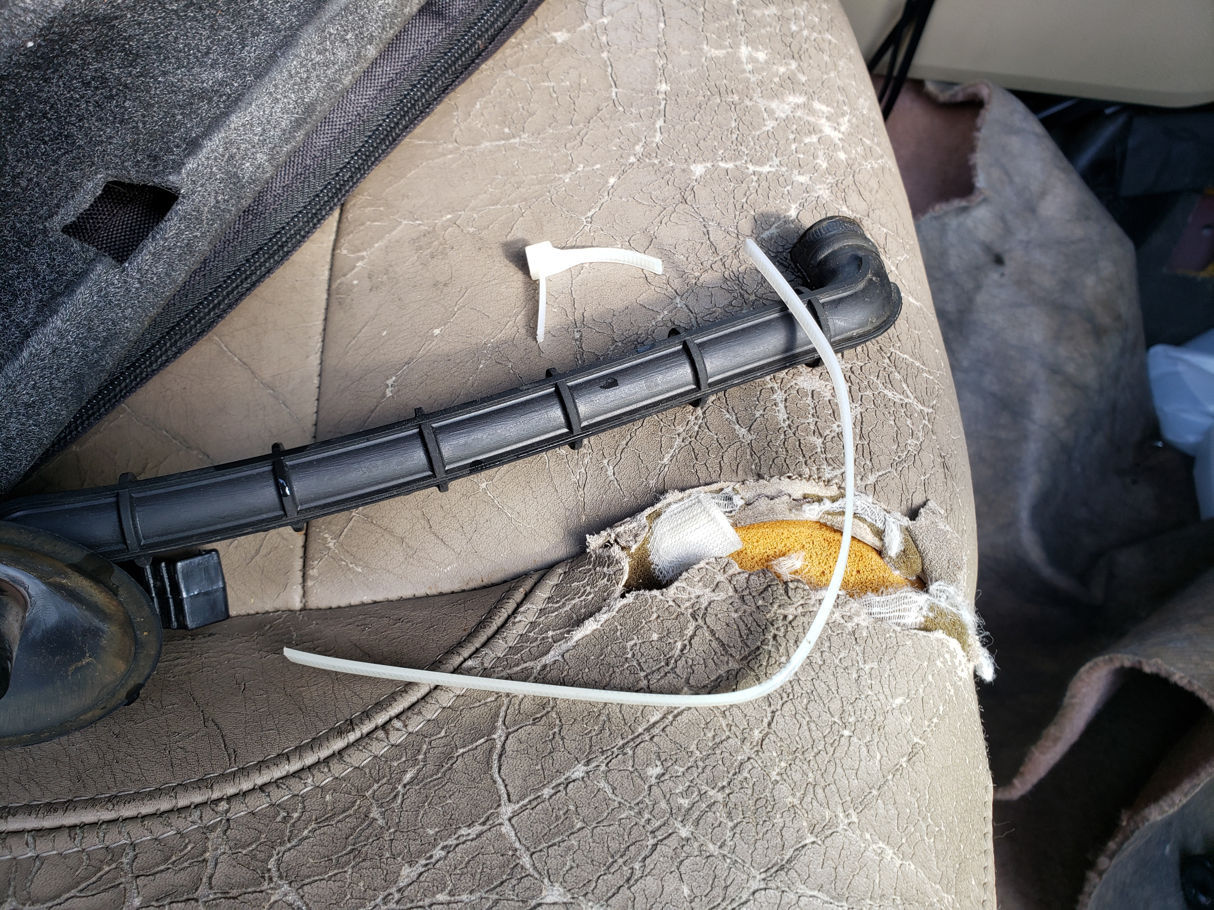

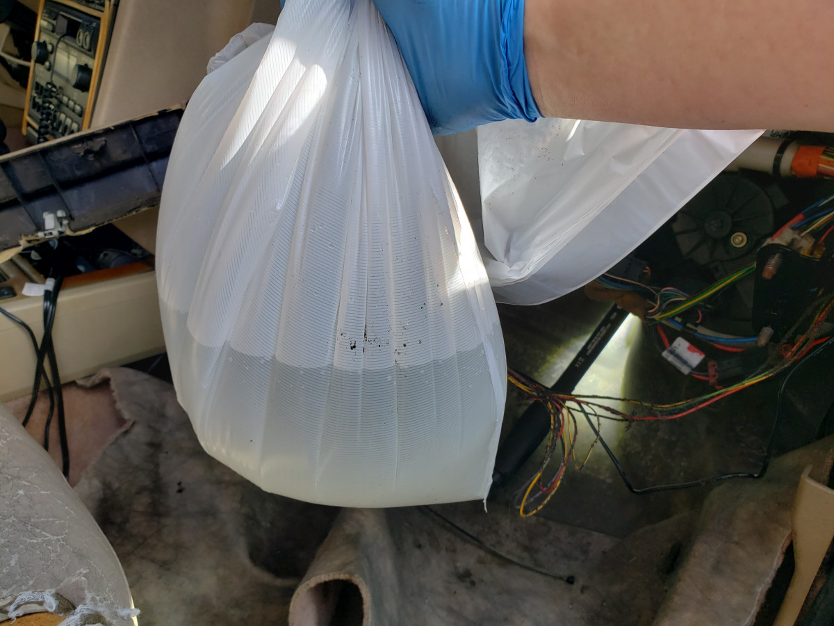

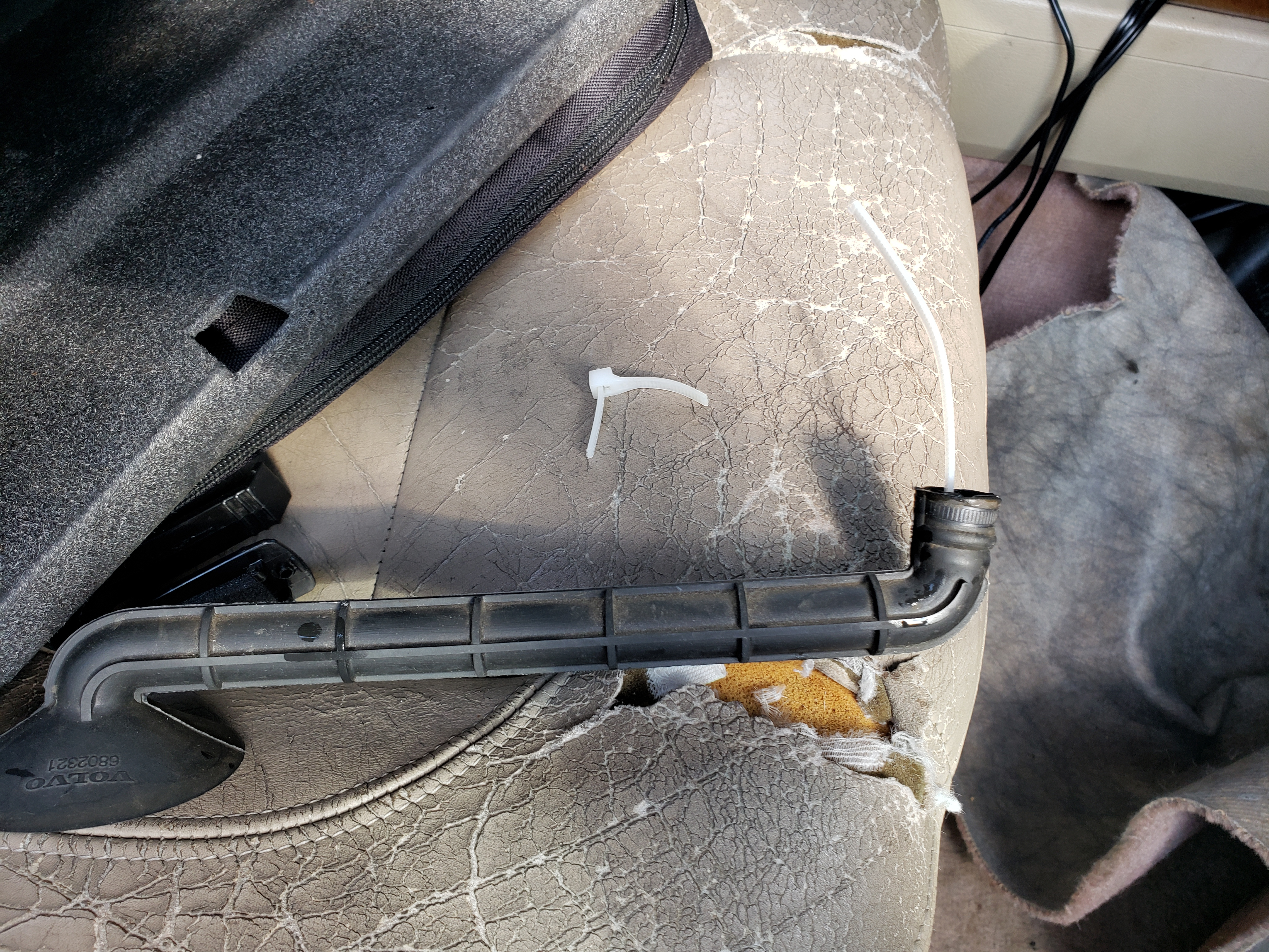

Today I found a zero cost temporary fix for my clogged AC drain. For years I've had the sloshing water sound when driving through tight turns and would have water spill onto the passenger floor. I usedto think rain was somehow leaking into the system. I know better now. This vehicle also did not come with a cabin filter. I fixed that problem last year when I spent 2 hours cleaning debris out of the evaporator after replacing the fan motor and resistor.
Since I finally have the AC working again the familiar water sloshing and spilling has returned. Cleaning the AC drain hose made no difference. Barely poking through with a zip tie unleashes the floodgates. I think something is trapped in there acting like a 1 way valve. The zip tie has zero resistance going into the drain but is very difficult to remove. Not sure if that is normal.
My fix involved placing the zip tie in the drain hose and leaving it there. So far today its never worked better.

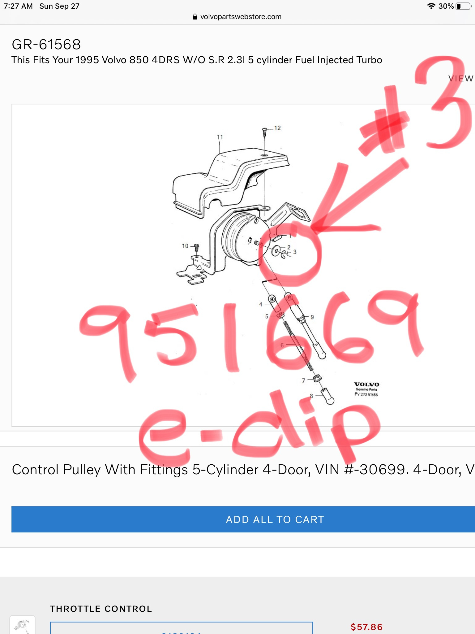

I've discovered that my throttle pulley is missing its retaining clip. The only thing that prevents the pulley from coming off the body entirely is the plastic cover over the assembly.
Does anyone know what this retaining clip is, and its size? E-clip, circlip?
Posts: 35268
Has thanked: 1497 times
Been thanked: 3810 times
Eclip 951669. You can probably make a non Volvo one fit by mashing it down a bit

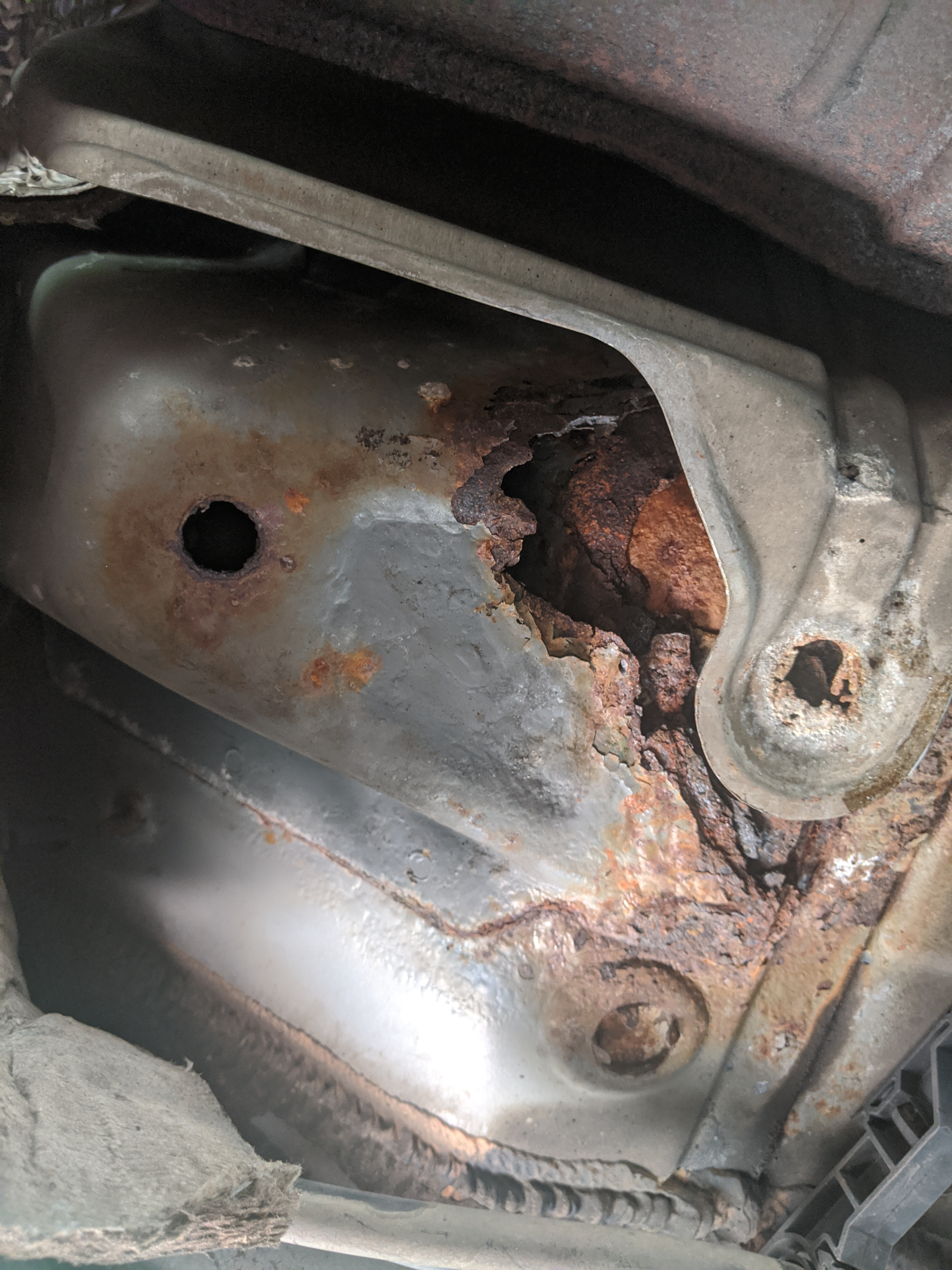

You should check for rust at the bolt points where the heat sheild above the catalytic converter bolts into the inner footwells. Mine seems to spill over and drain into those holes and one of them rusted out pretty bad. My indie said it's a problem he sees alot with these cars too.

abscate wrote: 27 Sep 2020, 05:34 Eclip 951669. You can probably make a non Volvo one fit by mashing it down a bit
Many thanks. I raided my e-clip spares and found one that is holding. Unsurprisingly I have a more responsive and lighter throttle now.
