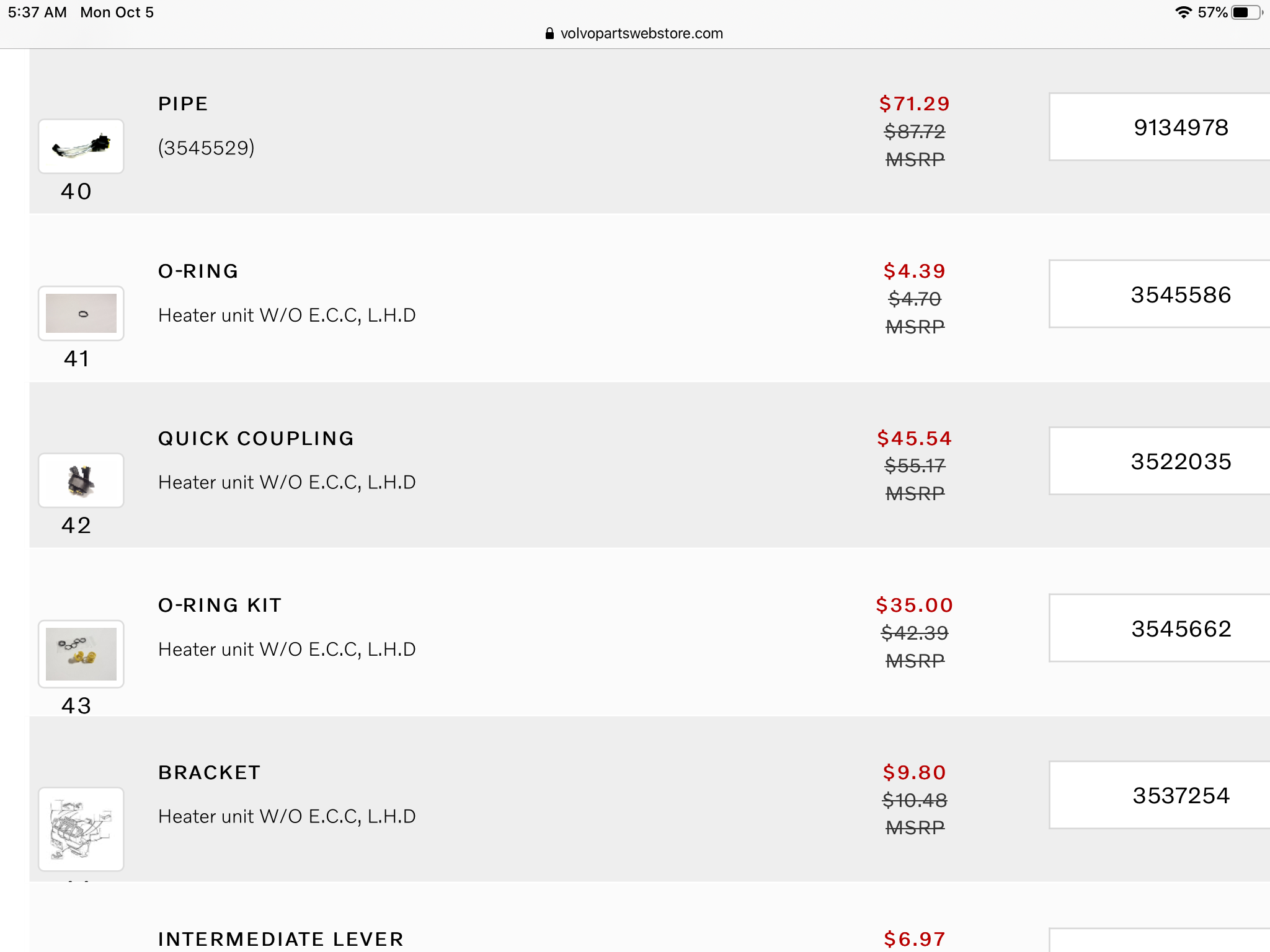

They show the same part number for the internal o rings on the heater core and the firewall bulkhead on volvowebstore.
I do have a broken one I can cannibalise to sort this out.

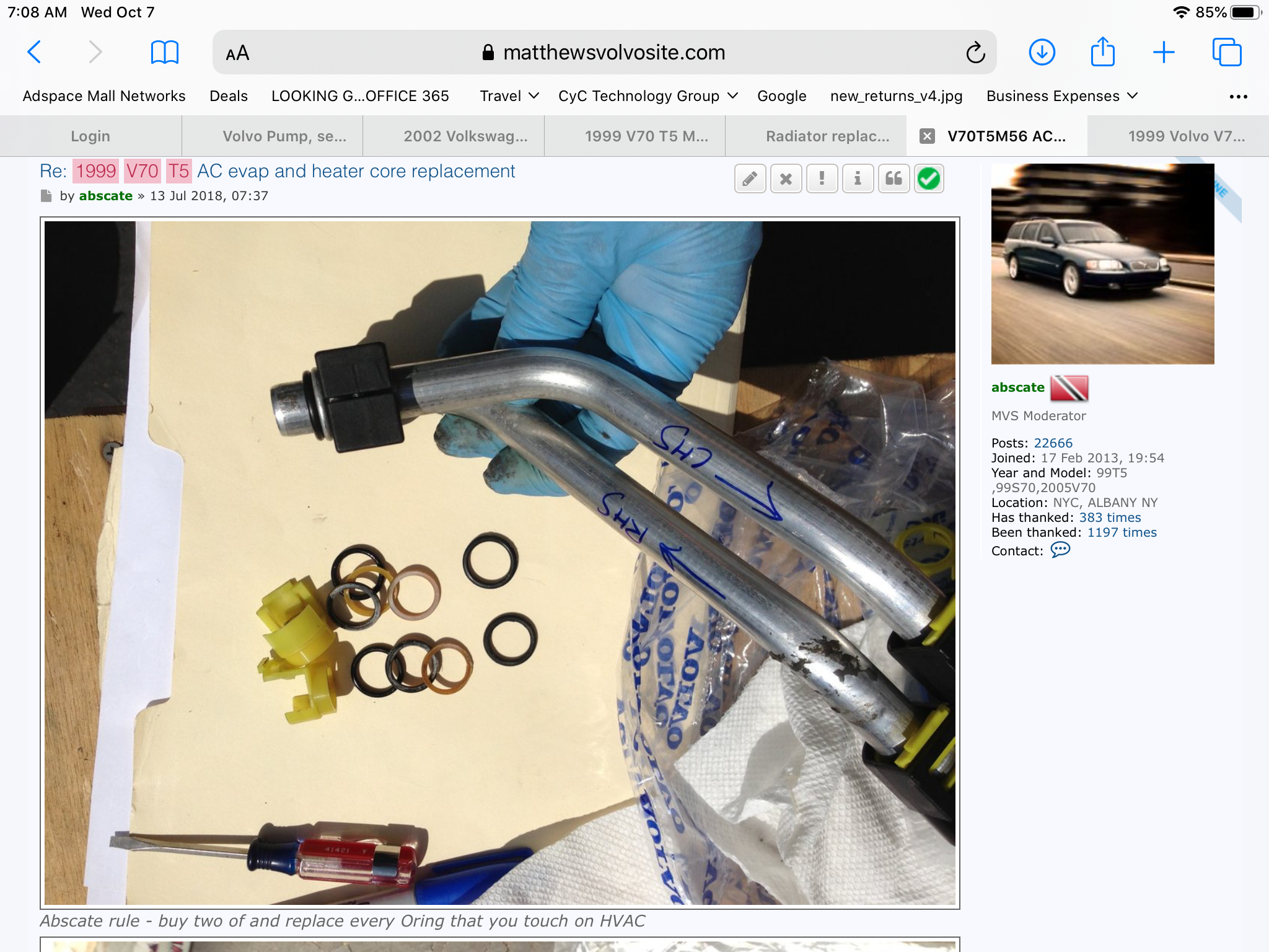

When I did my first radiator in 2013 I had the same issue with the clips, the supplied ones did not latch. I’m still using the 1999 ones in my T5.
- Posts: 36137
- Been thanked: 4063 times
Here’s the picture from that thread
