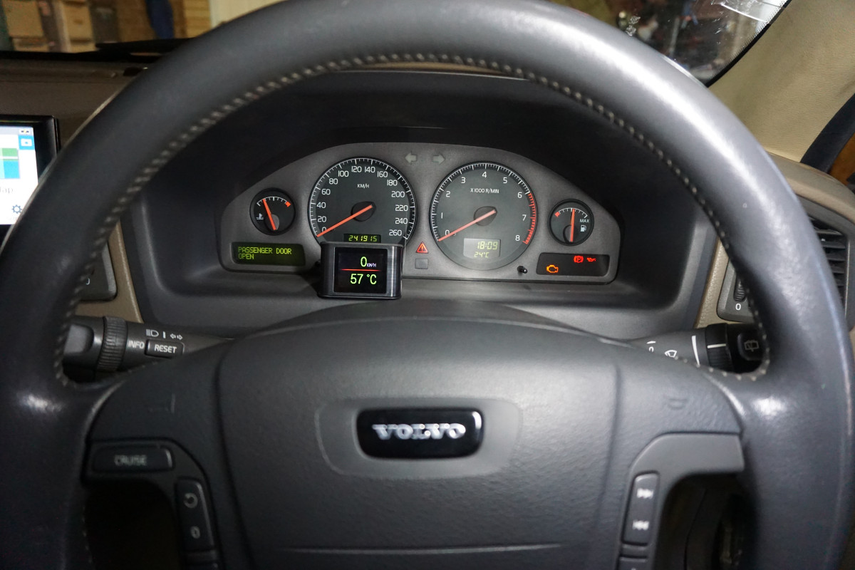

i bought this cheap OBD2 dashboard display to warn me when the coolant temp gets to a dangerous level. I was originally going to hide it, early testing of this unit is good, its plug and play with my 2001 xc70 turns on and off with the engine and beeps every 30s when it reaches the user adjustable values.

its interesting seeing the coolant temp rising and falling depending on car movement and gear selection, mine went from 86c moving in lower gears to 91c in high gear and up to 96c when i was stopped. There was a recent discussion on here about the "idiot" /driver comfort gauge that doesnt move from 12oclock when steam starts pouring from the bonnet (hood)
