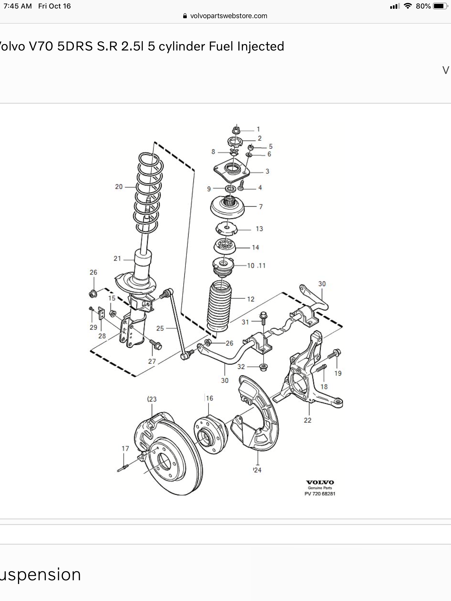

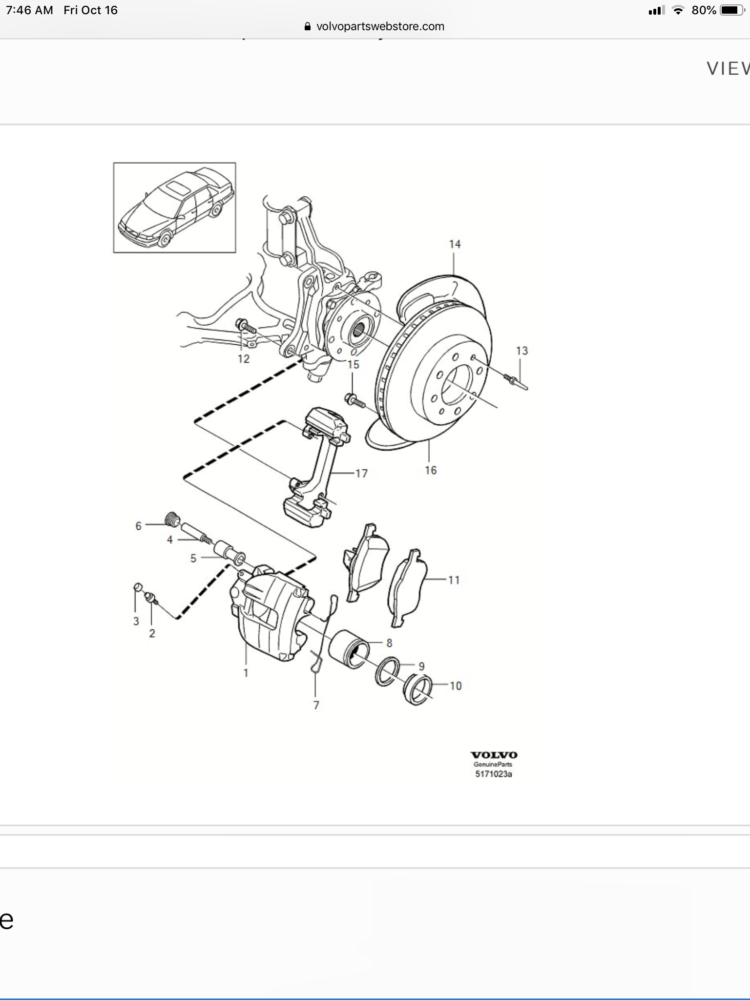

Have part numbers for the plates but can’t find the 3 m6 small flange bolt part numbers or their dimensions??
P80 front protector brake plate And hardware 982755 ?? ..9140388 9140389

I'm coming up with Part number 982755 M6X12 pitch? Same bolt used to bolt the hood latch to the hood.

Figured out why I couldn’t find it until I got Ricks part number, thanks again.
The diagram shows it completely out of place. They thread in from outside in , through the brake protecting plate into the steering knuckle
