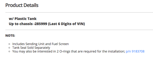

- When I ordered the fuel pump from FCP, their website said that the fuel screen was included; however, when the part arrived, Bosch's packaging said that it was not included, but must be installed or the factory warranty was void. As I understand it, the screen is supposed to be the first line of defense to protect the pump from failure should crud get into the tank, since the pump is before the fuel filter. I went ahead and installed the pump anyway, considering that FCP has their own lifetime guarantee and would replace the pump if it failed. I also contacted FCP and they said that the pumps had at one point included the screen, but this may have changed since they made the note on their website, and so they're going to send one out to me at no charge. I feel comfortable enough with the procedure at this point that it shouldn't be a big deal to get in there and put it on.

There is a fuel pump inlet screen made onto the bottom of the pump. You would likely break stuff taking it apart to put that screen on it if they provided one. The screen containing part is the black plastic circular pump mount that has "fingers" with latching tabs that holds fuel pump into the white plastic cup. The fuel filter is under the car but it is downstream of pump and catches pump wear particles so they do not foul the fuel injectors and fuel pressure regulator. That is just some standard statement for fuel pump boxes as some are a pump and not an assembly that includes the inlet strainer.

Yup, in fact I just heard back from FCP that they checked the parts they had on the shelf and in fact this part does not require a strainer to be added, and that as you said, the statement on the box is generic. Phew!jimmy57 wrote: 26 Feb 2019, 07:56 That is just some standard statement for fuel pump boxes as some are a pump and not an assembly that includes the inlet strainer.
