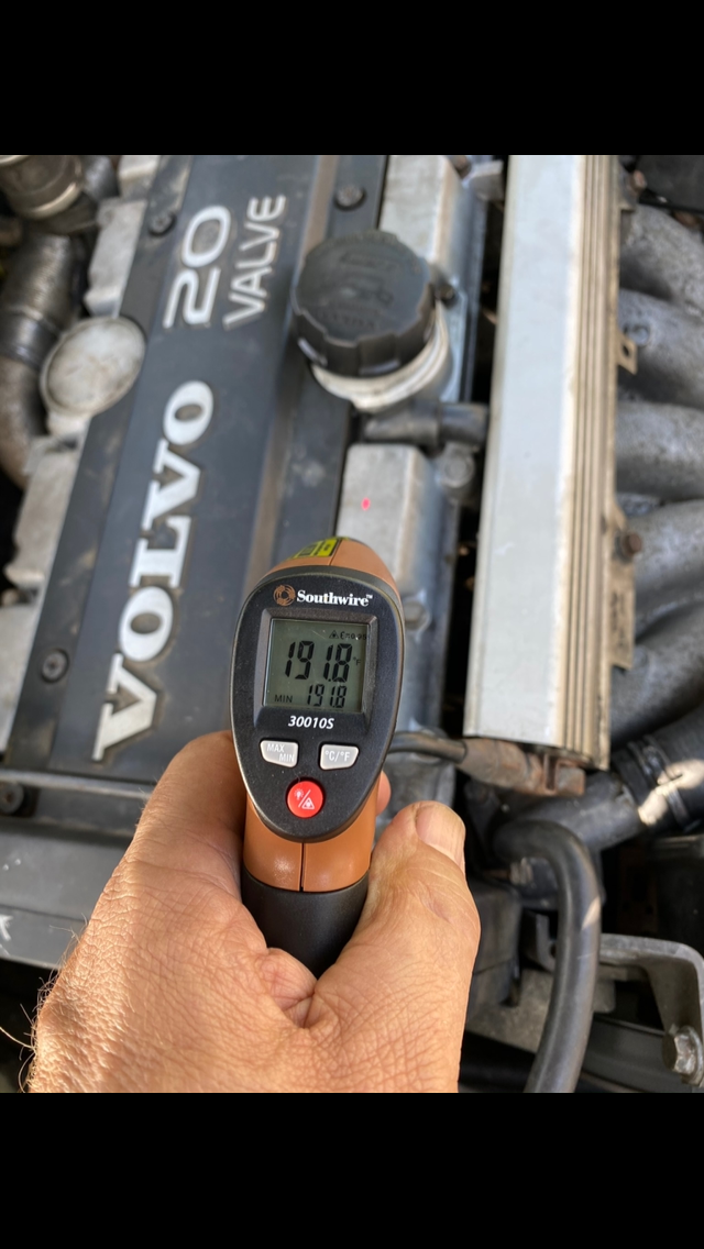

28 seconds of heat
If you really are nervous you can use a IR temperature probe to monitor the head for excessive heat beyond the running temp
I've already done that for you, though. Keep it under 200F and it will be fine
