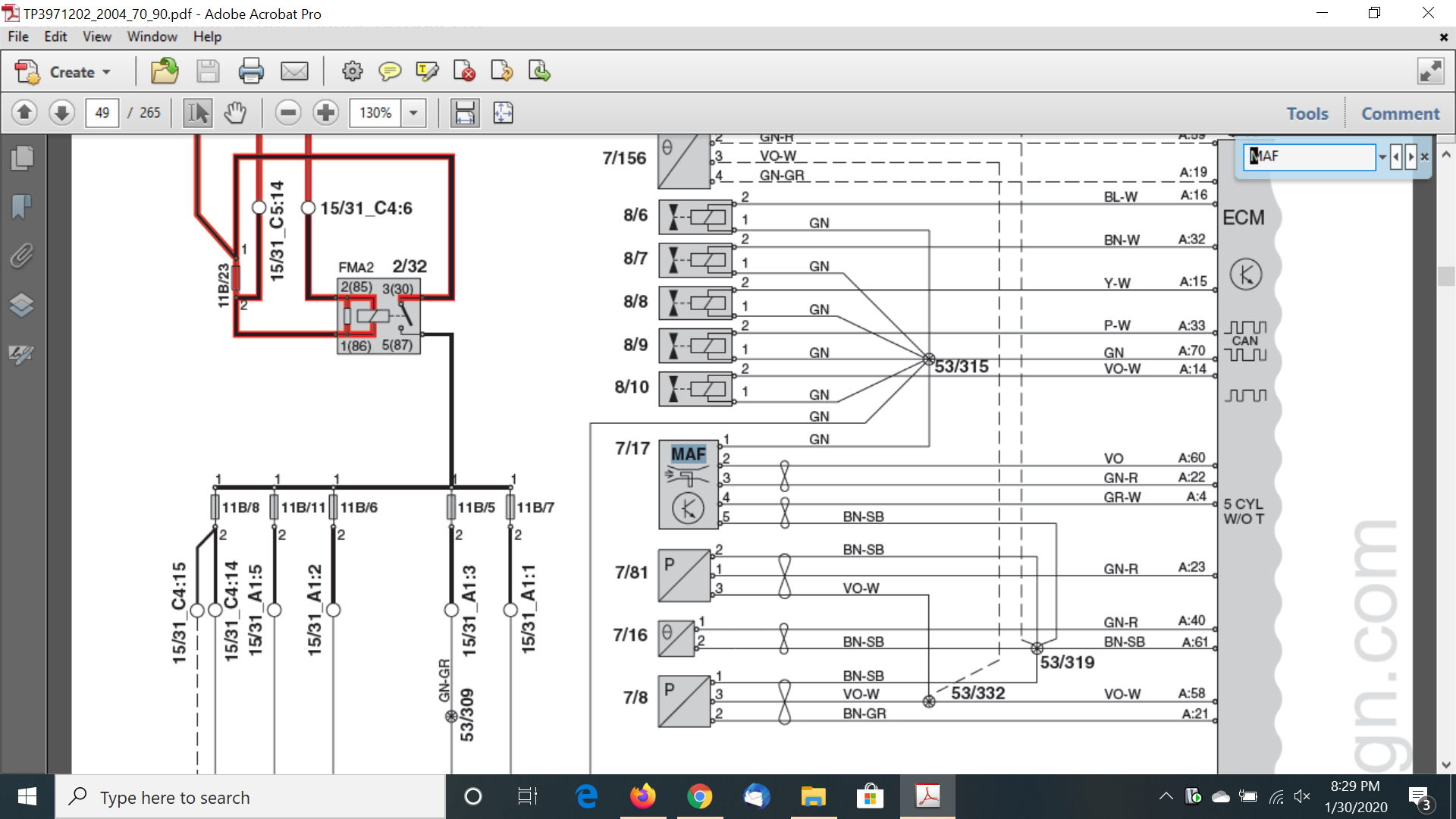

Here is the most recent thing I have noticed after clearing the code. I am only getting signal when the motor is cold. Just shut her off and I am going to run the tuner once again after cool down to see if the MAF functions. Have had varying times that the MAF is functional from 7 min up to 20 min.. The common denominator I have noticed so far is that it cuts out around the time the engine warms up to operating temp. I am going to run a continuity test on the wires in order to see if a short does exist but I have checked them once already. Could this be heat related or maybe a malfunction with the computer?

ECM-121D (P0102) Mass air flow (MAF) sensor. Signal too low
Diagnostic trouble code (DTC) information ECM-121D

Metal expands when it warms up. Hum .. Electrical connectors marginally loose when cold loosen up and lose contact when warmed up? It would not be the first time tightening the metal contacts in a electrical connector did the trick.diydad wrote: 30 Jan 2020, 17:50 The common denominator I have noticed so far is that it cuts out around the time the engine warms up to operating temp.

Thanks guys for all the great advice! I am happy to say that the issue is finally resolved. After I retraced all the wiring and tested, I still could find no fault in the wiring or the connectors. After process of elimination I decided that it was worth a shot to put in a an oem MAF Sensor. Bosch sensor came in yesterday and after it was installed the motor ran perfectly. It has run perfectly without stalling issues since then. Note to self: NEVER put an aftermarket MAF Sensor in this vehicle. I thought that I would get a reputable part from Oreilly Auto Parts and they sell a MAF by a company named Blue Streak (JUNK). Tried multiple times to call Blue Streak to as questions about the design of the product. Never received a return call or any explanation as to how their MAF sensors work. Hopefully this helps someone who is banging their head against the wall with same problem. Go OEM
