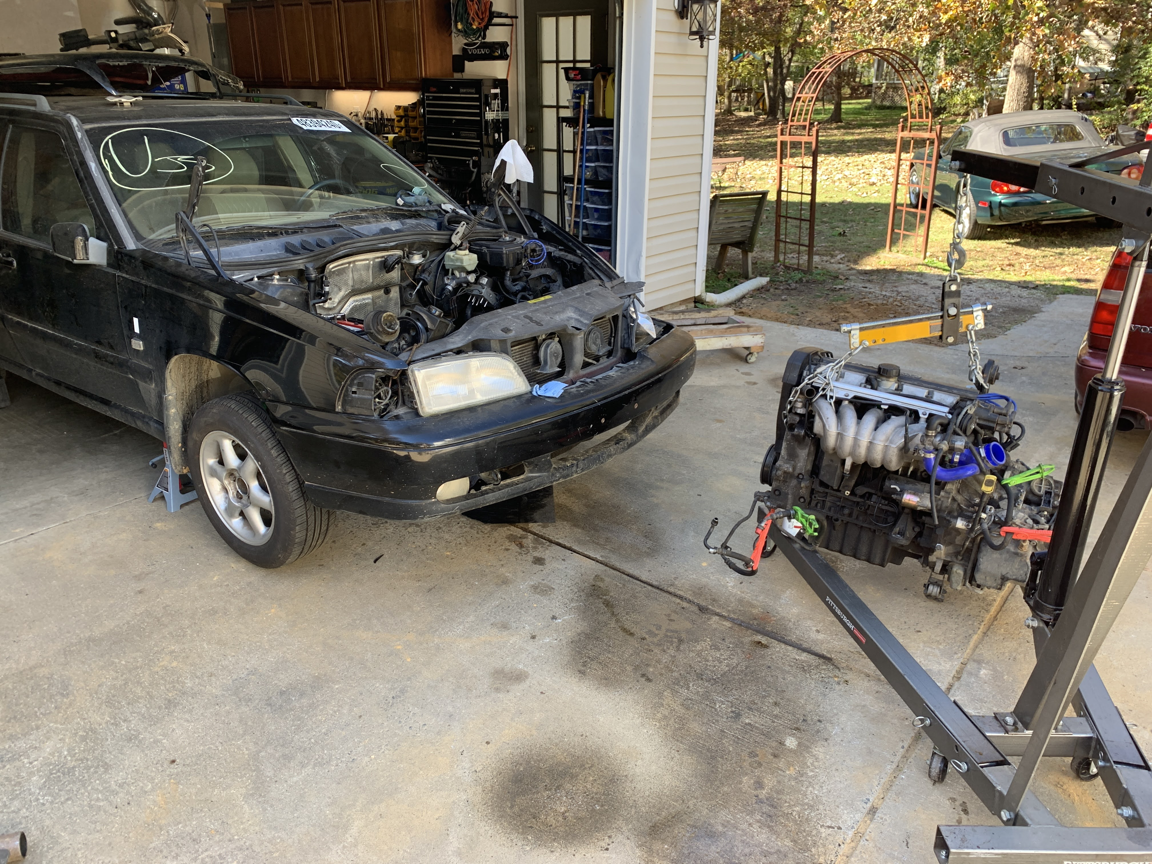

This is becoming a regular thing...
Believe it or not, this is the first time the engine is out of this car.
