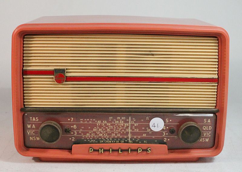

Not sure it'll fit.....

But at least they tell you which screwdriver to try, in a plot twist.
