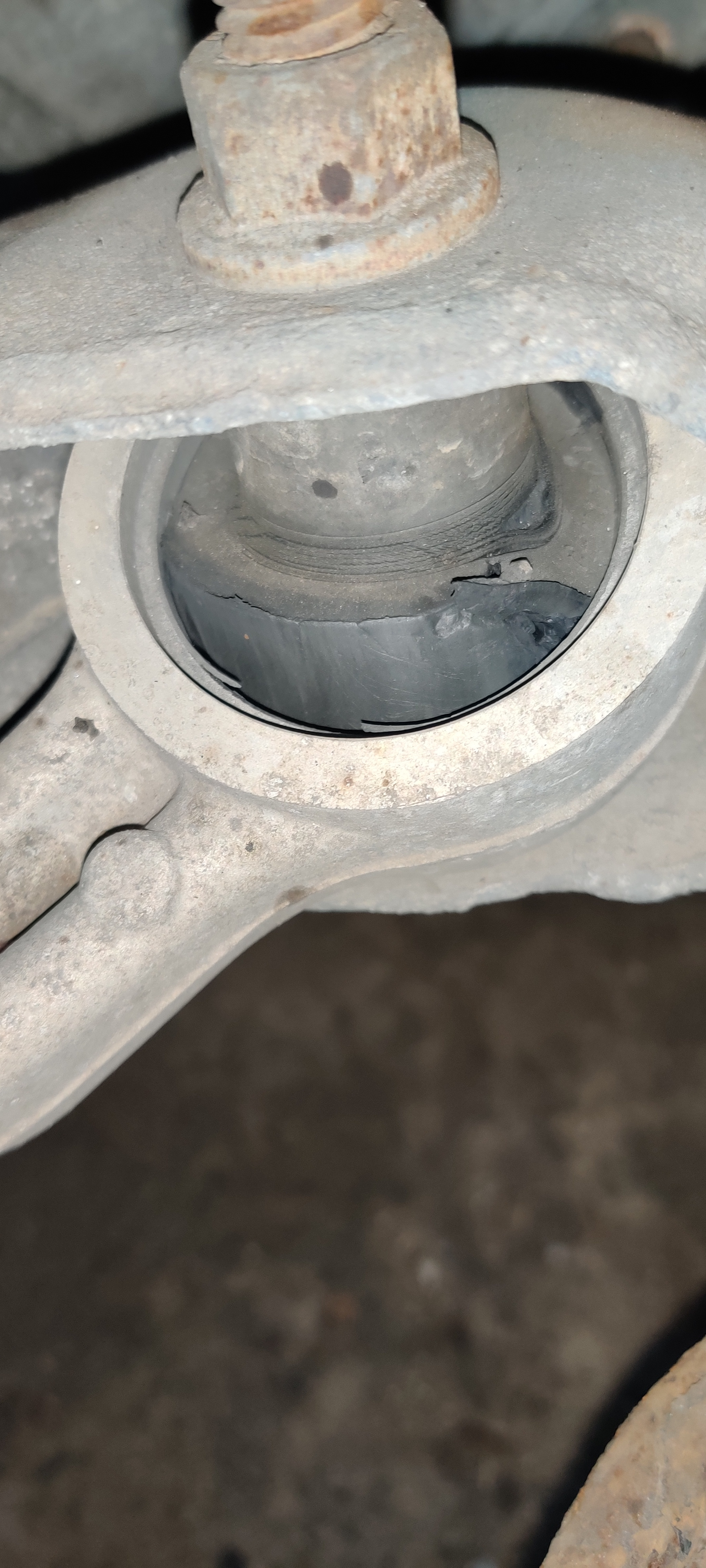

Post by gnalan »
This is the driver's side rear bushing. Instead of the rubber tearing off of the center metal piece like the passenger side did, the driver's side ripped the rubber off of the outer edge of the bushing.
