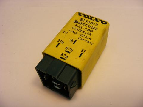

Here is the yellow one:
Green: Red:
Green: Red:

- Posts: 35316
- Has thanked: 1507 times
- Been thanked: 3823 times
Little boxes, little boxes,
There’s a red one and a green one and a yellow one....there all look like boxes and they all look just the same ....
Except.....
That yellow has an extra NC triggered terminal that might be important
Except.....

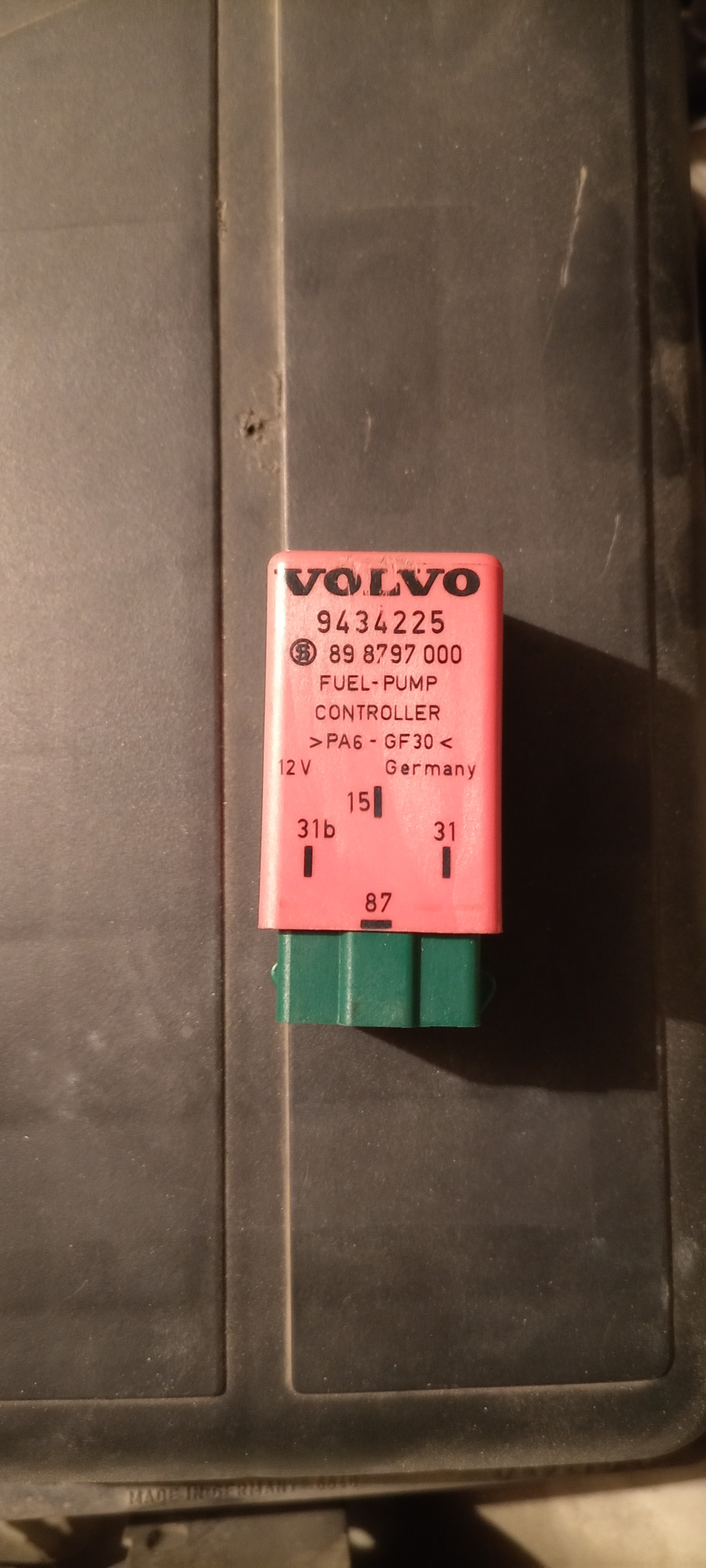

OK! So good news and bad news! Changed out my spark plugs to factory Volvo plugs and BOY what a difference (compared to the worn out ngk's that were in there). After putting that back together (and wrecking that accordion like aluminum pipe from air box to exhaust pipe in back of engine) I decided to check what was up with my fuel pump relay. Surprise, surprise all that's there is a jumper!
I do not have any relays across the top row. I remember when I bought the car, the po said there was a bag in the spare tire wheel well with spare parts. Lo and behold, there's the relay! Dated end of 1994. No time to put it back in the fuse panel (too dark). I'll try this weekend. Now I need to do the capacitor mod on mine if it's not working.

Progress!
misha called it exactly - permanently hotwired.

Ok....now....your signature says 1995 850 GLE.
GLE in EU market means that you have 10v engine.
Post a picture of engine bay and a spare relay you have.
There is a possibility that you have(need) a yellow relay since 10v cars have Siemens management.
