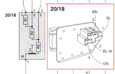

I'm starting to think it may actually be that switch pack - what else would burn out the 'Fan Motor Speed 4 30a Fuse' if that fuse is bypassing the Resistor pack, straight to a "good" motor? Don't tell me I gotta pull out and test the relay that moderates the "Speeds 1-3 or Speed 4" pathway..
On troubleshooting the resistor..
From my novice understanding of circuit diagrams, it LOOKS like there should be continuity across any of the 4 prongs, since they're all connecting to the same pathway of resistors.
However, my resistor pack only has continuity across prongs 2 & 3, and nothing else. Does that mean both Resistor 1 and Resistor 3 are shot?

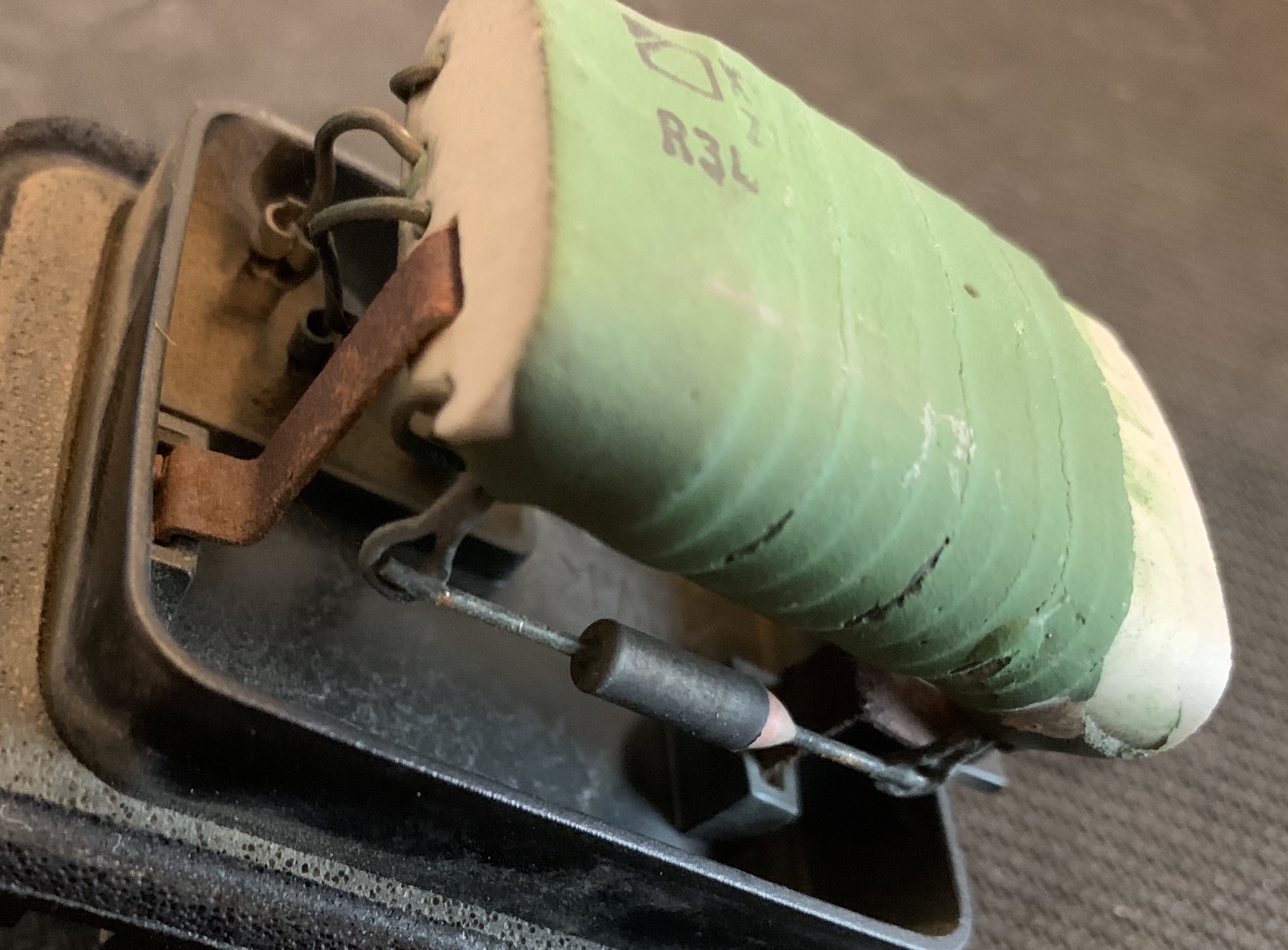

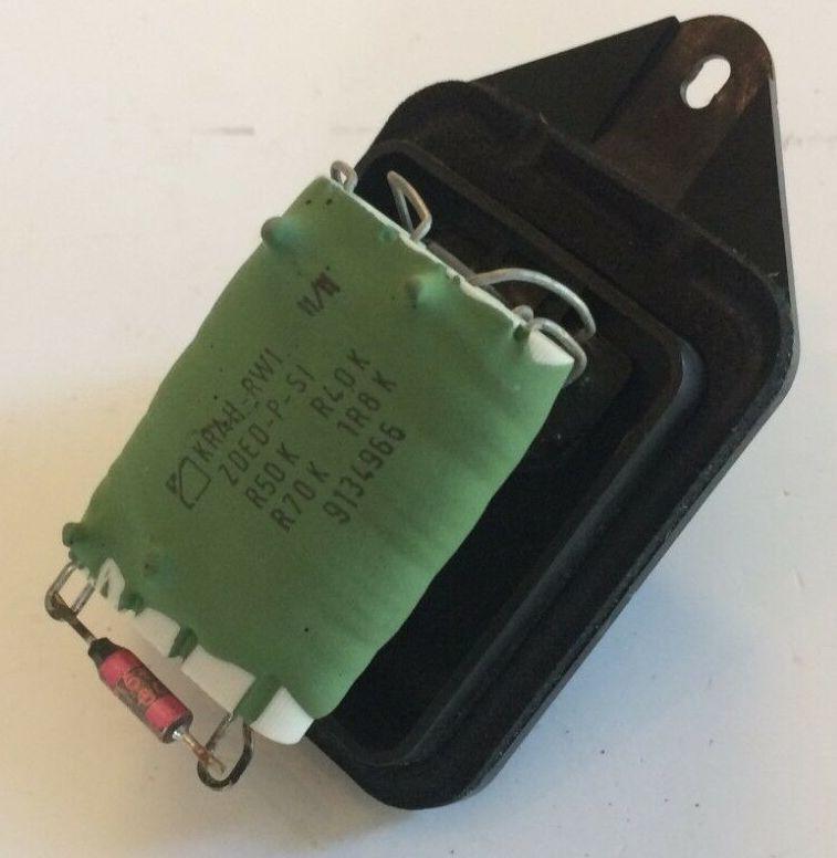

One other thing to look at while you have a meter out is the thermal fuse.
It's the small cylinder with a cone shaped nose on one end on the
resistor pack. If it's OK, it should show continuity.
MCC Blower Resistor Thermal Fuse.jpg (13.65 KiB) Viewed 1428 times
MCC Blower Resistor.jpg (106.68 KiB) Viewed 1428 times

BEJinFbk wrote: 12 Apr 2020, 15:36 One other thing to look at while you have a meter out is the thermal fuse.
No continuity! The wire was pretty badly tarnished, couldnt even get a continuity read on a stretch of copper either side of the resistor without some serious scratching.. but even when I got my probes on some live wire, no dice. Seeing your pictures of a presumably 'good' resistor pack.. mine does look a little more 'cooked' in comparison..

I want to test the recirculation & 'Snowflake mode' switchpack, since it connects to whatever the heck 6/48 is in the wiring diagram, and 6/48 connects to (and controls?) 2/24, which looks like the relay that controls between 'Speed 1-3' and 'Speed 4'. My best guess is that the relay's not being switched out of 'Speeds 1-3' mode, and speeds 1-3 aren't a complete loop right now because there's no resistor pack.
