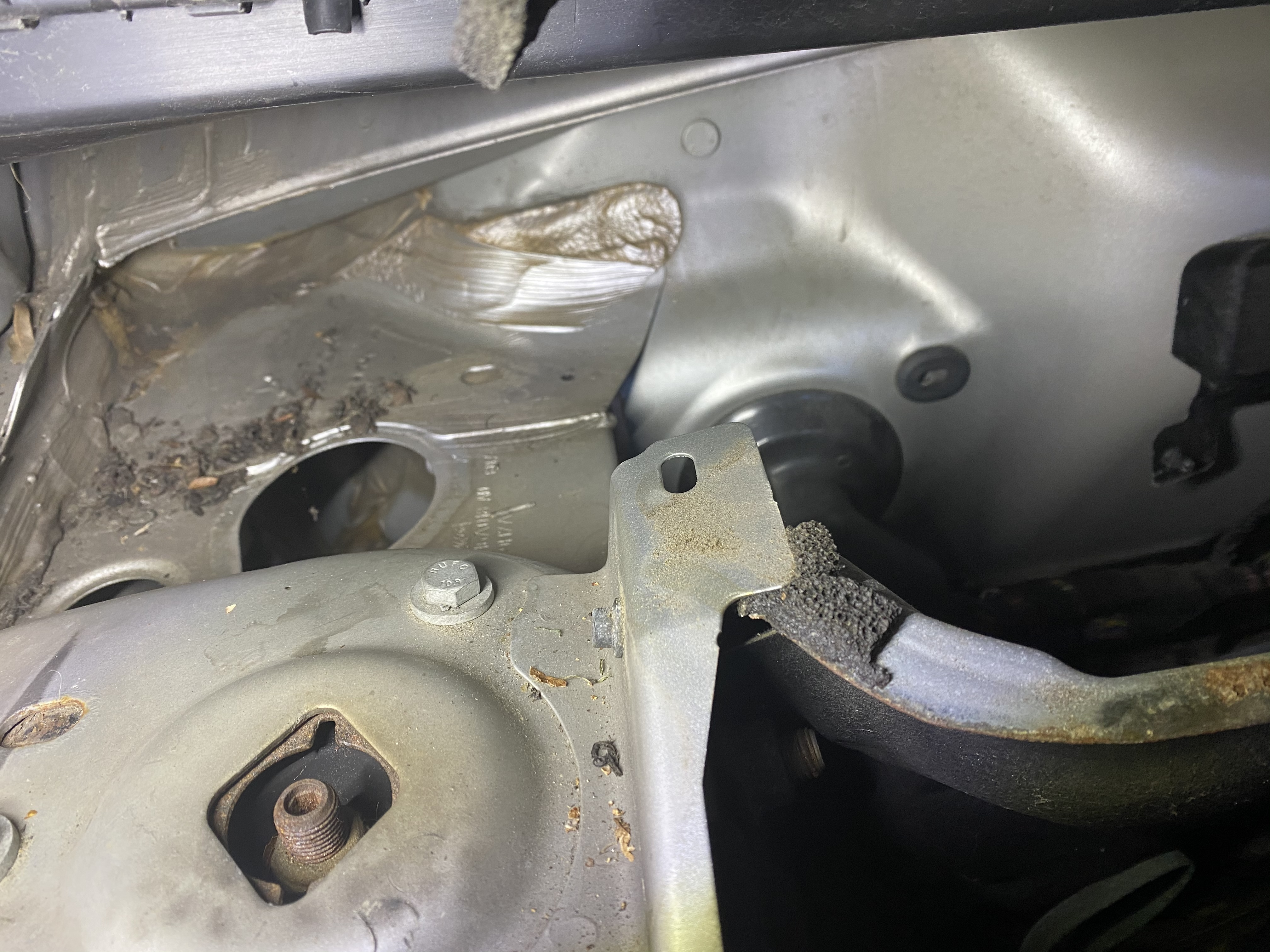

I can’t find the location of the tube on the passenger A pillar once it goes below the dash. It’s also not obvious where is comes out below as I can’t locate it in the cowl.
I see damp insulation near the A pillar passenger side so right now leading clue is it’s the right side sunroof drain. But it’s not simple to find it.

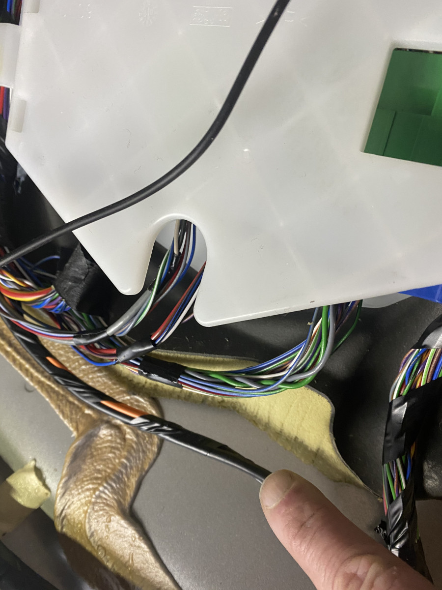

I realised this whole thing when pulling the carpets to change out my blower motor. Scary with all the wiring passing through the passenger side to see water in there.
May have to just leave everything out after getting the blower going again and have the dealer fix it. If it does end up as class action I want record of it through Volvo.
Even the drain up by the roof is off it’s not a hole but a tube that connects to the rail the sunroof retracts on. I’ll post what I can so hopefully others with the S80 can see the solution.

I would like to just tear out the insulation behind the glove box but ironically it’s on the the things keep the CEM and other items dry as it creates a barrier to the water.
