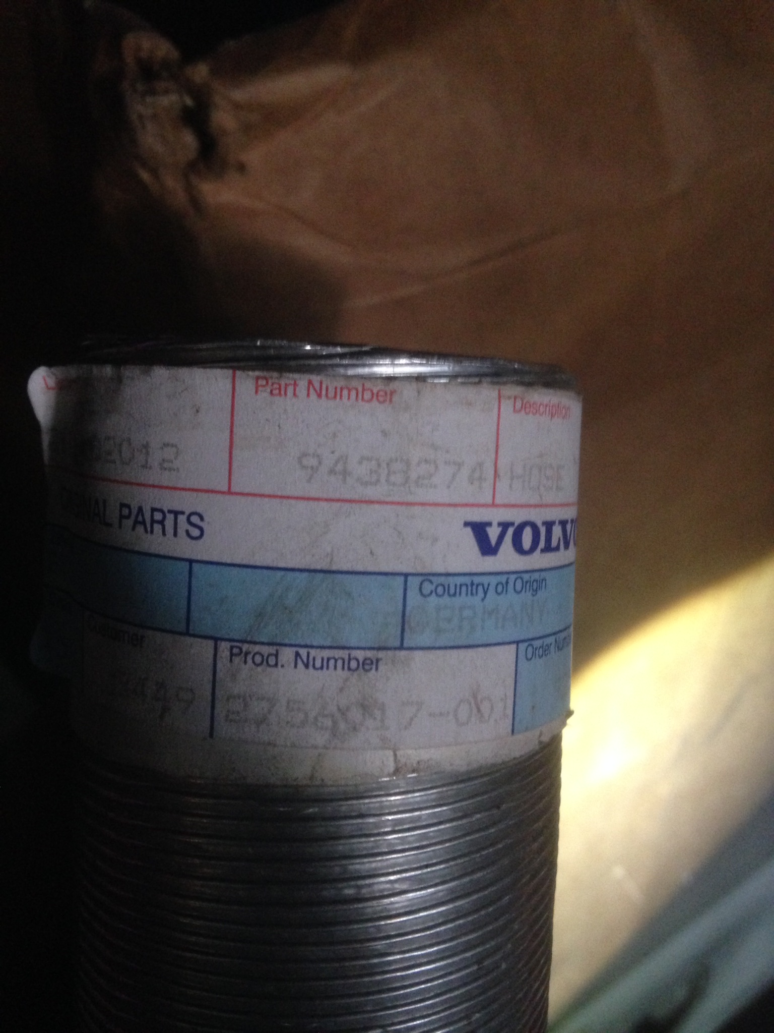

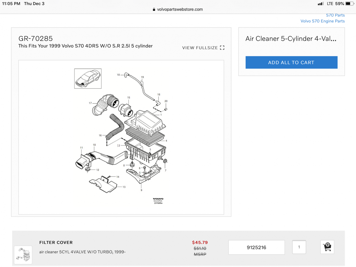

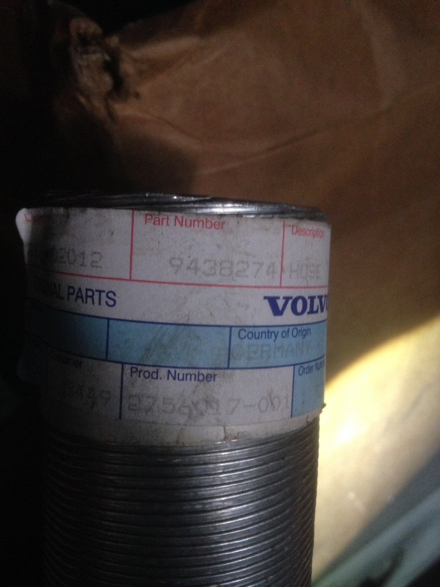

I’ve looked for that part number unsuccessfully but have a new Volvo one in my parts bin, I can pull number tomorrow
It’s part “ 16 “ here
Naturally , the correct technical name for it is obviously “ elephant hose”
Part number is 9438274
