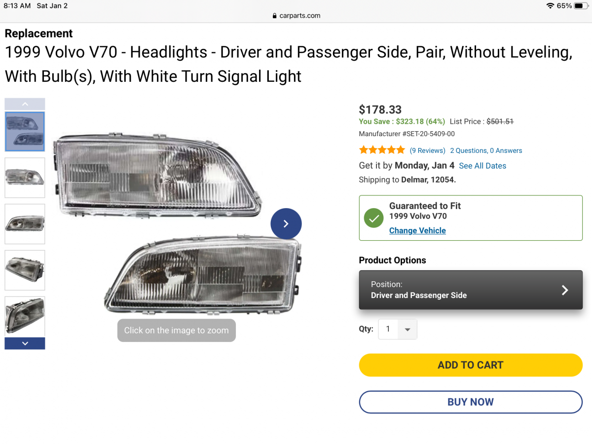

Car parts.com has a pair of P80 headlights off brand for +$160FireFox31 wrote: 31 Dec 2020, 10:55 I have decided to invest in the new-to-me green 2000 V70 which I bought for $500. A careful visual review showed two small leaks, worn out shocks/springs, but nothing else major. I installed the new front brake parts which I moved off the V70 I donated and I'm pretty sure the rear brakes are fine, but there's still a major vibration when breaking. Next, to replace faded headlights, I must either take a chance on junkyard jewels or buy new ones. But the transmission seems to shift a little oddly...
Abscate, I'll message you info about the engine shut off.
