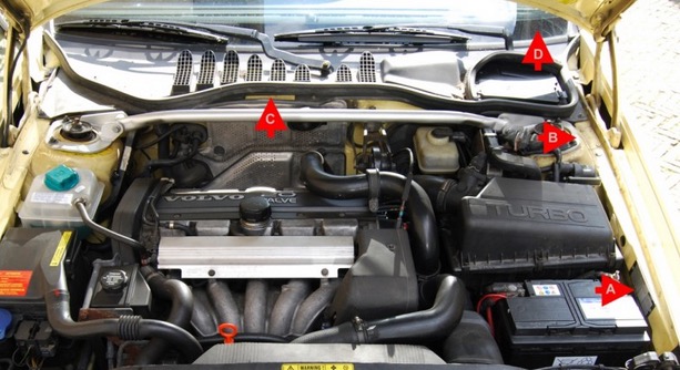

You may not forget that your guideline is the vehicle's VIN : have an eye at this post on the site, everythong is explained. From there, easy to fine right parts.
https://www.matthewsvolvosite.com/volvo ... 6-example/
Where are those VIN on your car ? they are here : I hope it will be helpful.
Manov
Manov
