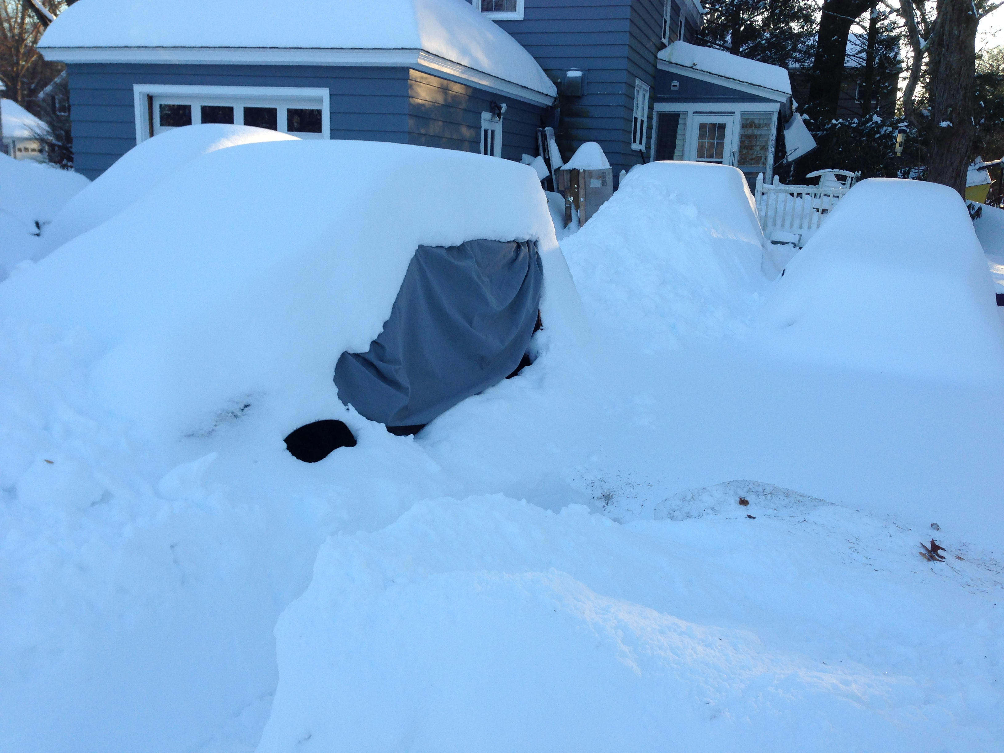

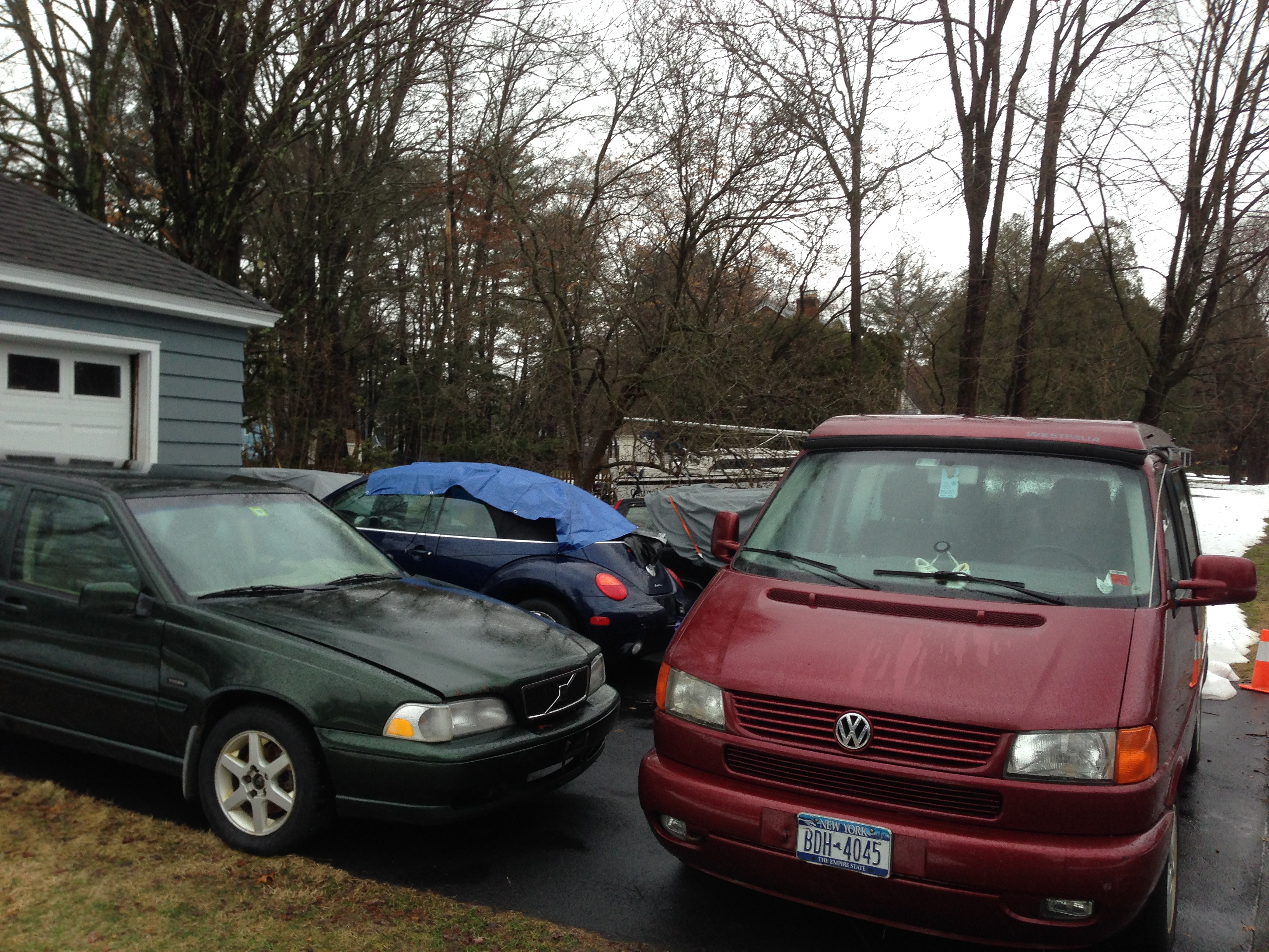

Volvoloo is more fun to say. Or maybe T5 Volvoloo. Later photos appear to confirm it was not the Transporter.
Thanks for all the photos. I hope to never see that much snow again in person.

Milehighv70xc2 wrote: 18 Dec 2020, 07:34 That is just crazy, I new you were supposed to get a sever winter storm , but I never imagined that!! We sure could use that snow out here in CO. I really appreciate all the help and the offer for a pump. Just let me know whenever you get a chance to dig it out. Looks like maybe early January, haha
Got your PM, and nature came and dumped 2-3 inches of rain and 60F to clear my shed, will dig for parts today
Weather change in one day!!

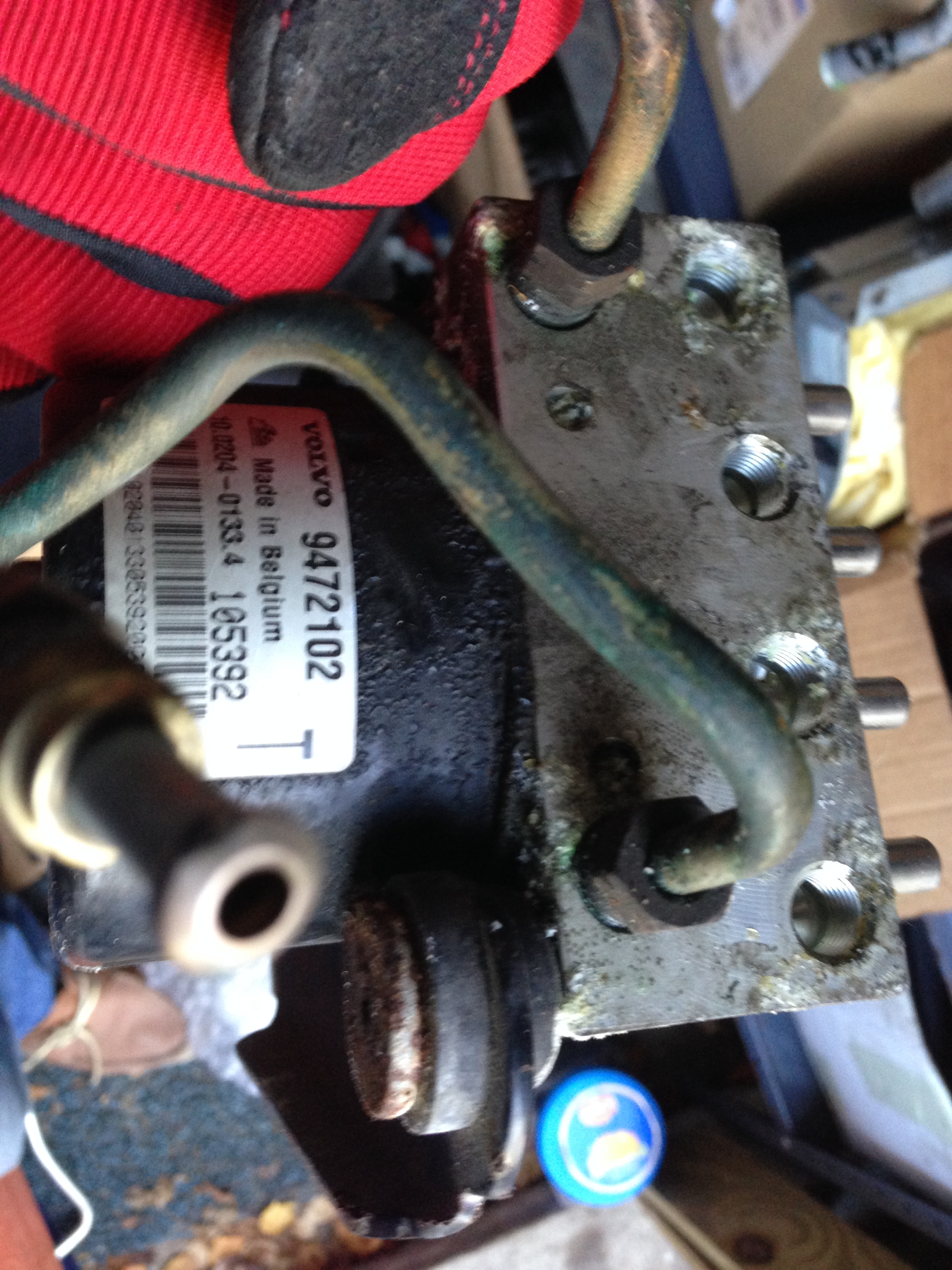

Found mine

UPDATE--
It was the return line piston in the abs block that was seized.
Replaced the pump and block, because they are a unit, bleed the brakes and everything is back to normal.
Thank you to everyone who helped diagnose the problem.
