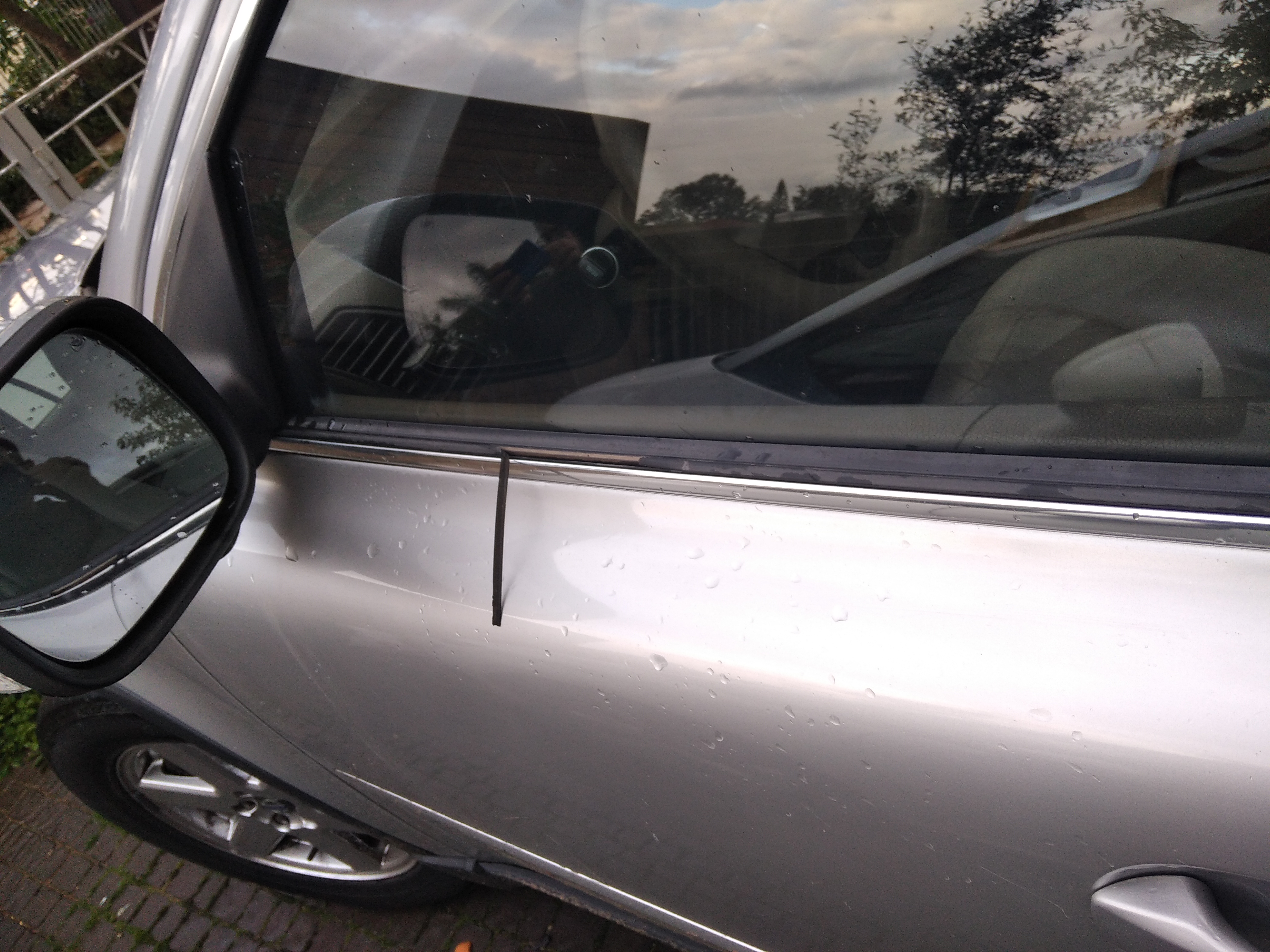

The exterior rubber seal that goes underneath the silver window trim is starting to disintegrate on my 2007 2.5T :cry:
I've attached a picture of the driver's side and that black part that's stickng out is part of the rubber fading away and breaking loose.
No problem I thought and was set on ordering the rubber part from fcpeuro, but they don't carry it and they have no idea what the part number is.
So does anyone know what the part number for it is? Or should I just go buy some rubber made for a different car , cut it to length and install it?

I get 30753850.
