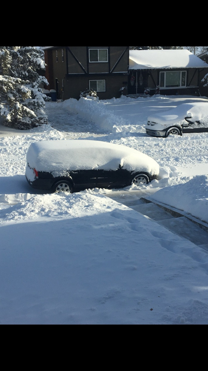

There are a great many XC 70 and XC 90 vehicles on the road today with non functioning AWD systems, probably the majority of them are in this condition. It is certainly feasible and possible to DIY repair these systems where time and money are available, especially given that the salvage yards are full of P-2's and new parts are readily available from various suppliers.
These cars are not adequate when "converted" to FWD, nor should that be accepted as a permanent solution. Among the drivability problems encountered, excessive wheel spin even in dry conditions tops the list. Pulling away from a stop and encountering wheel spin on road paint, and then gaining traction on dry asphalt is annoying at the least and definitely harder on driveline parts. This issue becomes even worse when slippery or icy conditions prevail. The final drive ratio is different on an AWD Volvo than it's FWD counterpart. Your broken XC 70 or 90 was not designed or engineered to be a FWD vehicle, even with good ice or studded winter tires. I drove my XC 70 for about a year with a failed system, both summer and winter. As such, I wouldn't even consider permanently disabling the AOD AWD, add to that that it might be near impossible to sell a vehicle pending disclosure of the condition.
I would also add that these vehicles are such a pleasure to blast around on deep snow when working properly! Everyone else getting stuck while you're enjoying the fruits of you're labor, having accepted the challenge of resurrecting and repairing your car to it's proper condition.
This was our first snowfall of the winter, December 23. A FWD Volvo wouldn't have gotten out of it's parking space!
