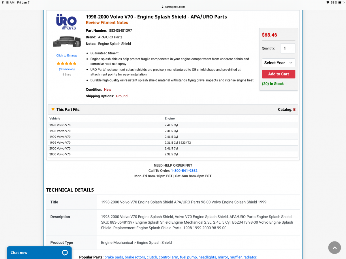

Thanks for the info. I don't trust URO (because the Internet says not to), but I'll consider it since you recommend it. First, I'll check out some P80's at local junkyards to see if I can get an original one.

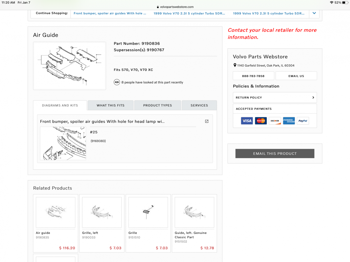

Adding to this thread, relevant for 1998-2000 P80s only
I’ve accumulated three of these now with broken tabs
Part numbers are 9190835 9190769 9169558
The new one is now NLA FROM Volvo
Parts geek sells the URO for $68
I want to ID the plastic and see if I can repair the hanging tabs, which is what breaks when you hit the curb

I do have one of the URO ones on my P2 and fitment was good, quality 8/10

The internets are right.
But....this is a loosely fitting plastic tray on the bottom of the car, gets blasted by water and muck, and is not really a critical part. If it gets broken, they're not so expensive.
My Audi A4 (which even sits up higher) has been through three of these plastic "air trays." In a snowbank once, it literally tore off. On my XC70, I'm installing the aluminum skid plate from IPD.
