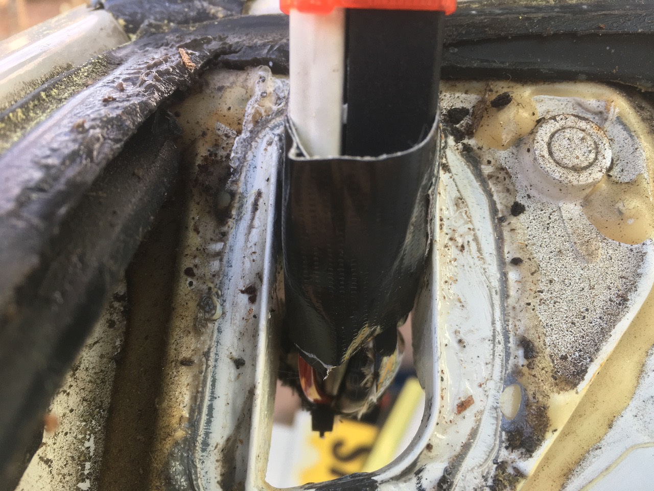

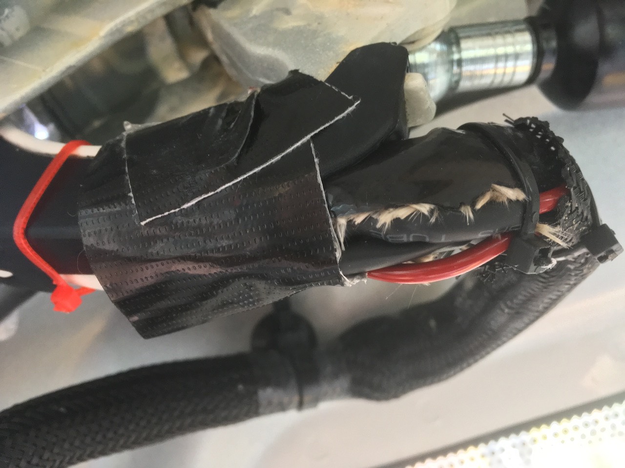

I'm doing a similar repair now on my 855 tailgate wiring, where the large diameter yellow/red wire powering the rear defroster broke. I soldered in a splice and taped the extra wire to the bundle... will post a picture here. I've got the trim off for now and am testing to make sure it works well and is a stable repair before reinstalling the trim.

Here are some images of the defrost circuit wiring repair on my '97 855 GLT, showing a red wire spliced in with solder/heatshrink to repair the broken original yellow/red defrost power wire. I wrapped the splice to the original harness using "gorilla" tape (super sticky duct tape).

The small red tie-wrap is not necessary... it's just a visible reminder for me to keep an eye on the hinge and make sure the repair is holding up.
