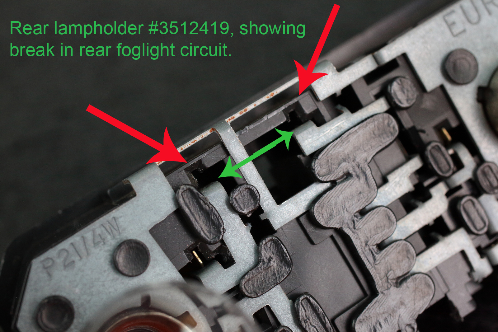

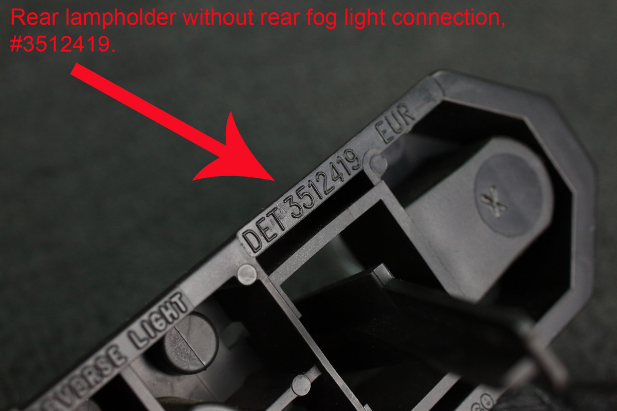

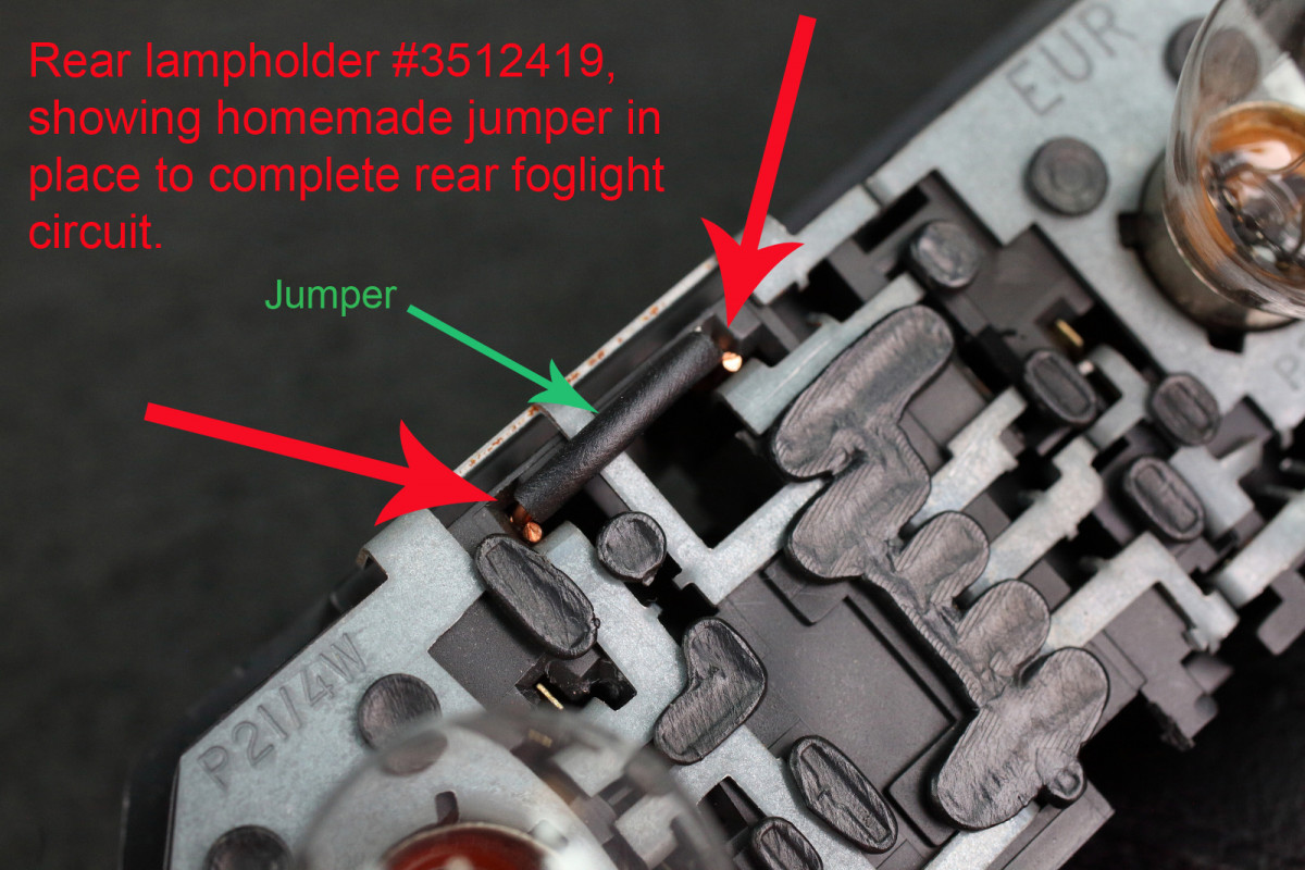

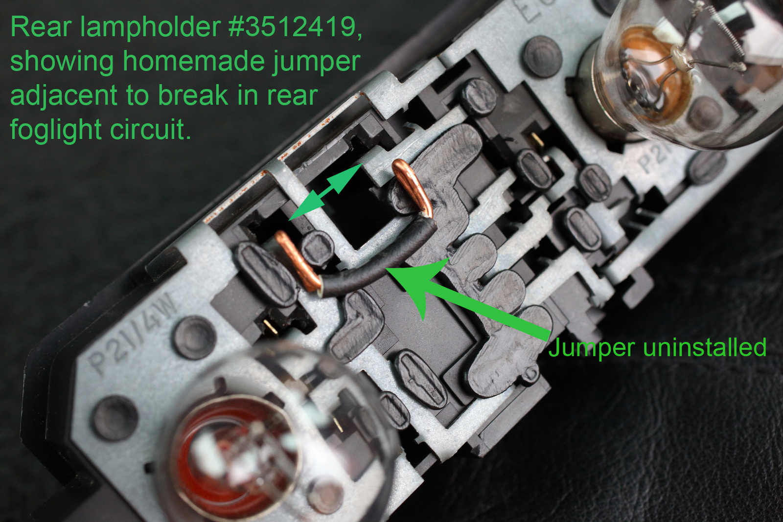

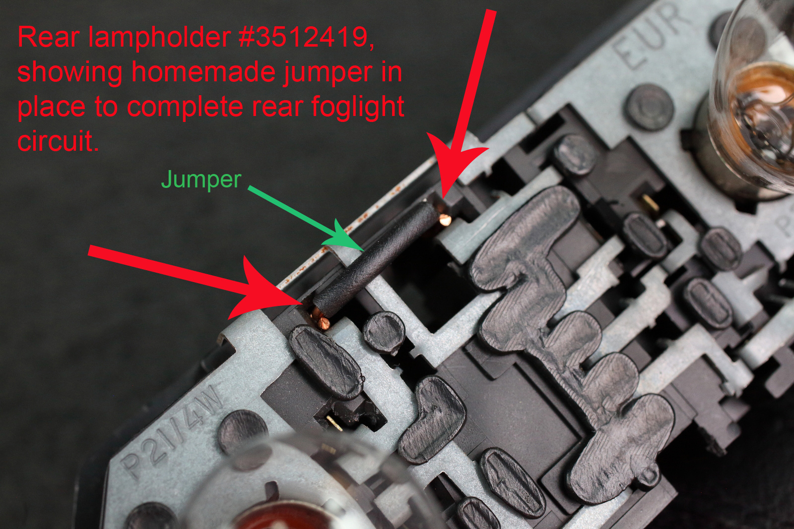

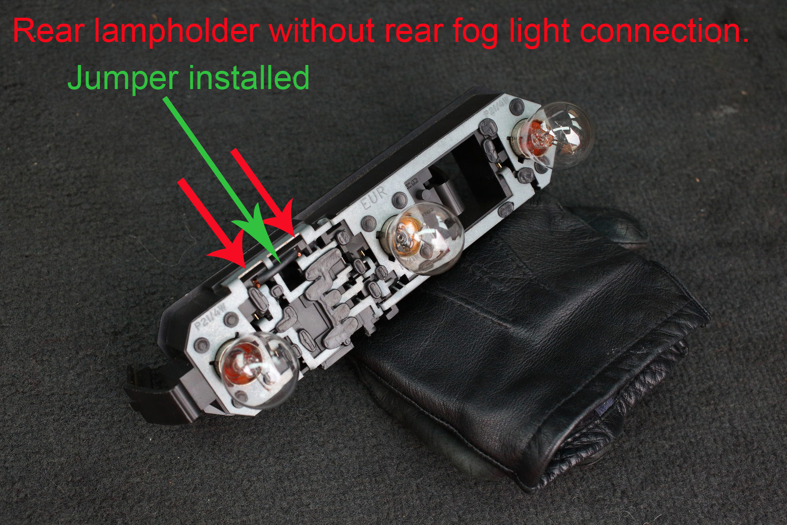

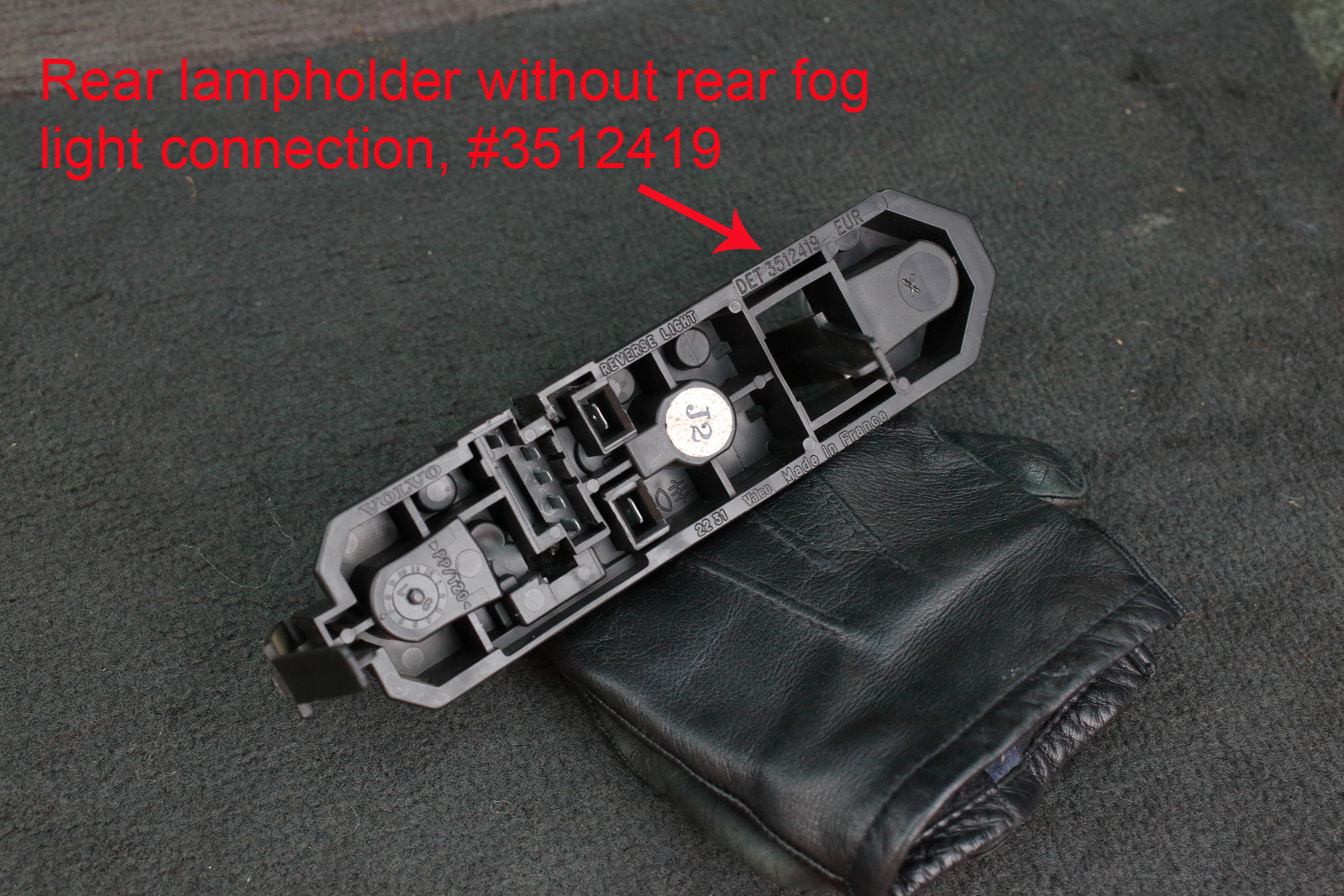

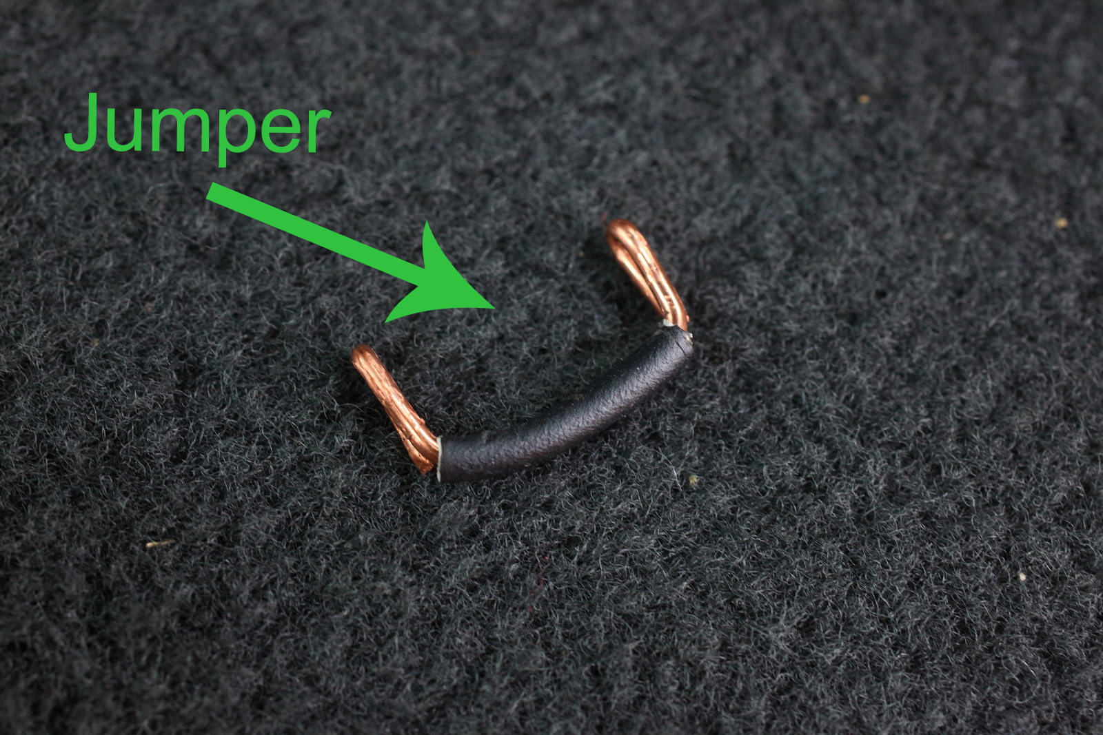

I offer my sincerest apologies for a gross oversight, particularly to Abscate & retriever! Back in Oct/Nov 2018, I promised to post photos relating to the resolution of my "No rear fog light" topic. No excuse, just mad 'life'.
This only came to light just now because I went to search for a solution to another problem... So, here are the belated snaps, newly annotated. For your information, the lower, rear lampholder part numbers are;
#3512418 = with rear foglight circuit.
#3512419 = without rear foglight ccircuit.
