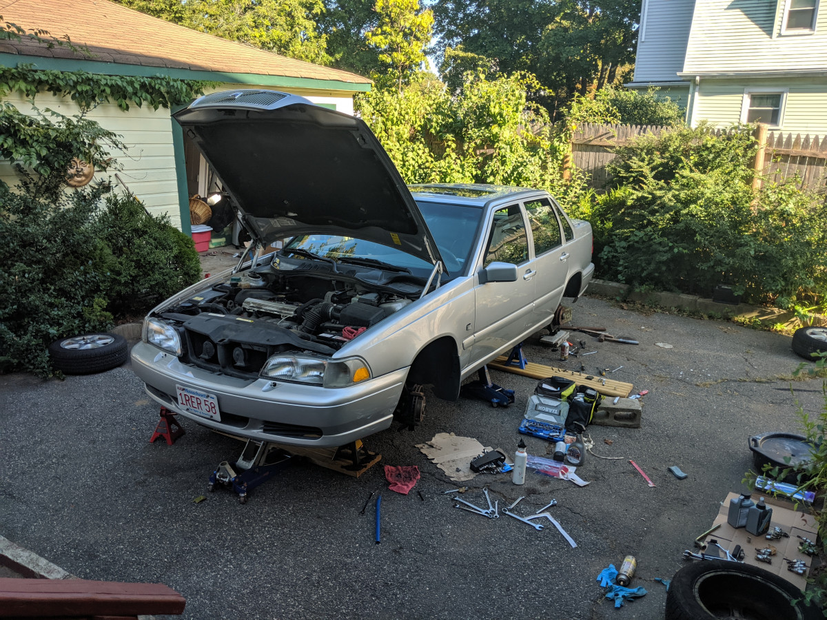

I'm writing this to have a proper maintenance log of my 99 S70 - NA m56 transmission. I've made plenty of panic threads where I've learned a lot from the community, and a couple where I've shared what I've done. It's also an exercise in sharing my own experience in sunk-cost bias, and naive obsessive tendencies to try to make a 20+ year old, 200k mile car 'perfect'. I just saw the $10k / 10yr / 100k mile s80 thread and it inspired me because I've been doing a lot of mental math trying to figure out how long or for how many miles I could drive the s70 before it becomes 'worth it'. I've spent the last couple years since graduating college on a crash course in personal finance while I tackled my student loans and set myself up for long term financial health. Below I'll copy in my phone note where I list everything I've done to the car, try to update it with what this endeavor has cost me, and add links to other threads that have stemmed from this car.
In 2019 I went to Greece with my fiancé to visit her parents' village and meet her grandparents and the other half of her aunts/uncles/cousins that hadn't immigrated to the USA. Since we'd be spending almost a month there I figured at some point we might be able to borrow a car and tour around, and since it was Greece I figured that car would likely be a manual transmission. I had had a few attempts to drive stick before from friends but i never got serious practice with it, so before we left for Greece I asked a friend to give me a proper lesson til i felt confident enough. When we got to her family village I realized nobody had a car to lend (makes sense, not many people i've met in life have an expensive machine sitting around for some cousin you just met to joy ride around the Peloponnese in). We ended up deciding to rent a car last minute and the only car they had was a manual transmission toyota hatchback, the first drive was a narrow winding mountain road between Kalamata and her village outside of Sparta. I did not yet know how to hill-start. It was incredibly dumb but incredibly fun.
Anyway so I get home and decide I want a manual car, and due to my financial independence quest i had a mission to teach myself how to fix a car. I always had a fondness for Volvos so i found a 99 s70 with 205k miles and a stick, professor owned with good maintenance records and bought it for $1000. I did not know at that point that all Volvos are worth $500. I did a ton of research on p80s (thanks RobertDIY) and how to inspect a car (thanks ChrisFix) but missed some big issues. This is where the cost of all of this comes in and i think boils down to a couple of key points.
Sunk cost bias: Every issue which I found along the way was all after I had put some money into the car, so i decided to keep going.
Lifetime Warranty: Bless FCP, and one day the lifetime warranty might bring me back into the black on this car, but I went to them for almost every part with the understanding that I would never have to pay for that part again. I did get junkyard parts for some stuff, but much of it was FCP.
Do it right, all of it: I also subscribed to the school of thought that if you're down there messing with one part, why not replace the associated parts, or the other side, so you know its all refreshed.
I Became Obsessed This plays into the last point above, but fixing the car became my new hobby so i was constantly thinking about it and this led to me justifying things that probably didn't need to be justified. 'if i'm doing the tie rods i might as well do the control arms, if i'm doing those, they're going to get ruined quickly by the old suspension, if i'm refreshing the suspension i should do all the associated subframe bushings, since I've done all this I should probably replace the clutch which as seen ~215k miles, etc'
So anyway, I'd guess I'm in just about $9000 on this car, including things like tires, craigslist set of mounted winter tires, oil+fluids, and maybe like $400 of labor fees of when i had to bring it into a shop. I've owned for 1.5 years and driven about 25k miles. Below is the list as I added it to my phone notes, but the big things i've done to the car, in chronological order, are:
Brake refresh (calipers, rotors, pads, fluid)
Timing Belt + tune up (tb, fuel filter, sparks, coils, etc)

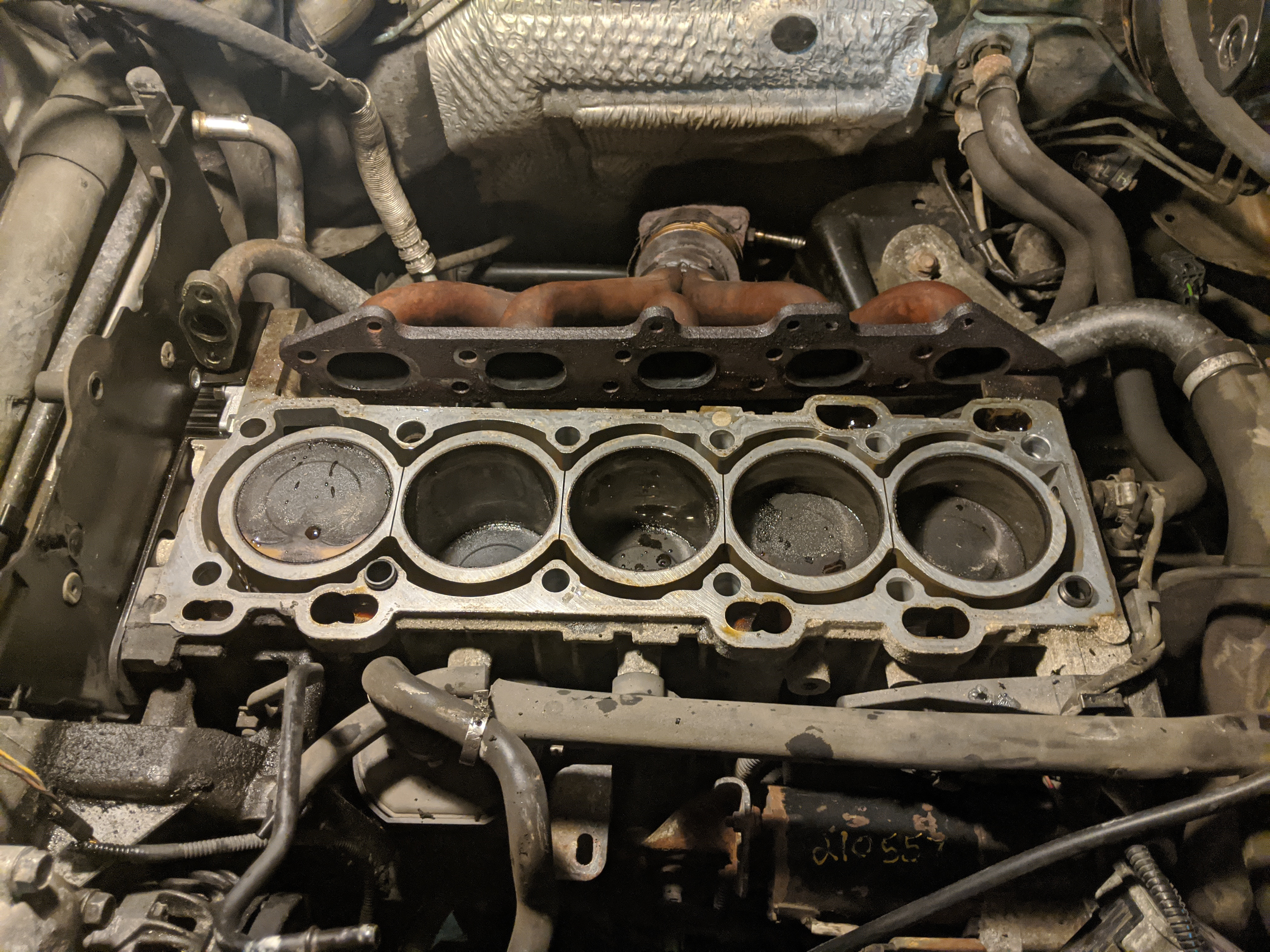

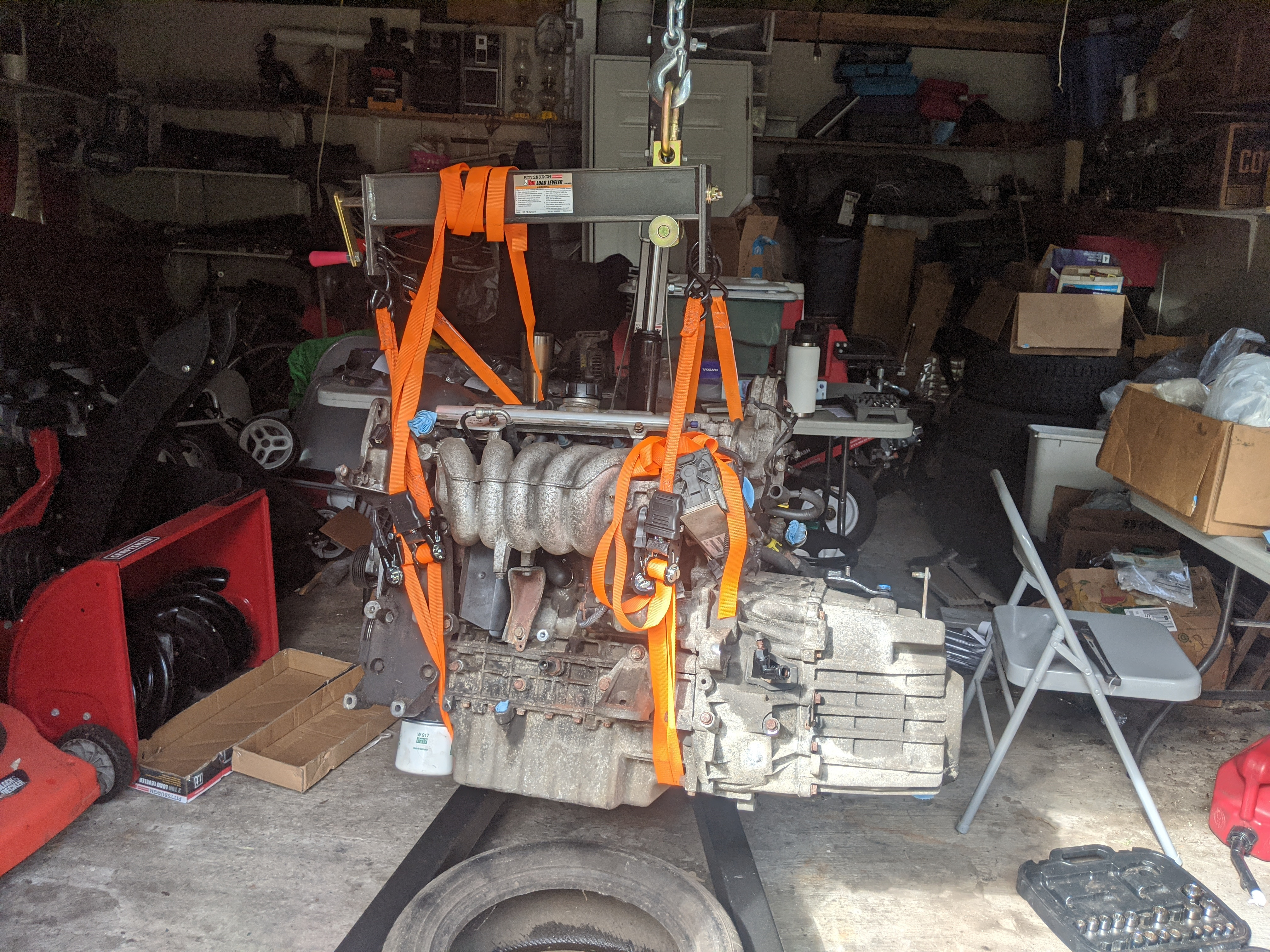

Head gasket + top end (i had low compression on two adjacent cylinders, turned out to more likely be burnt valves)

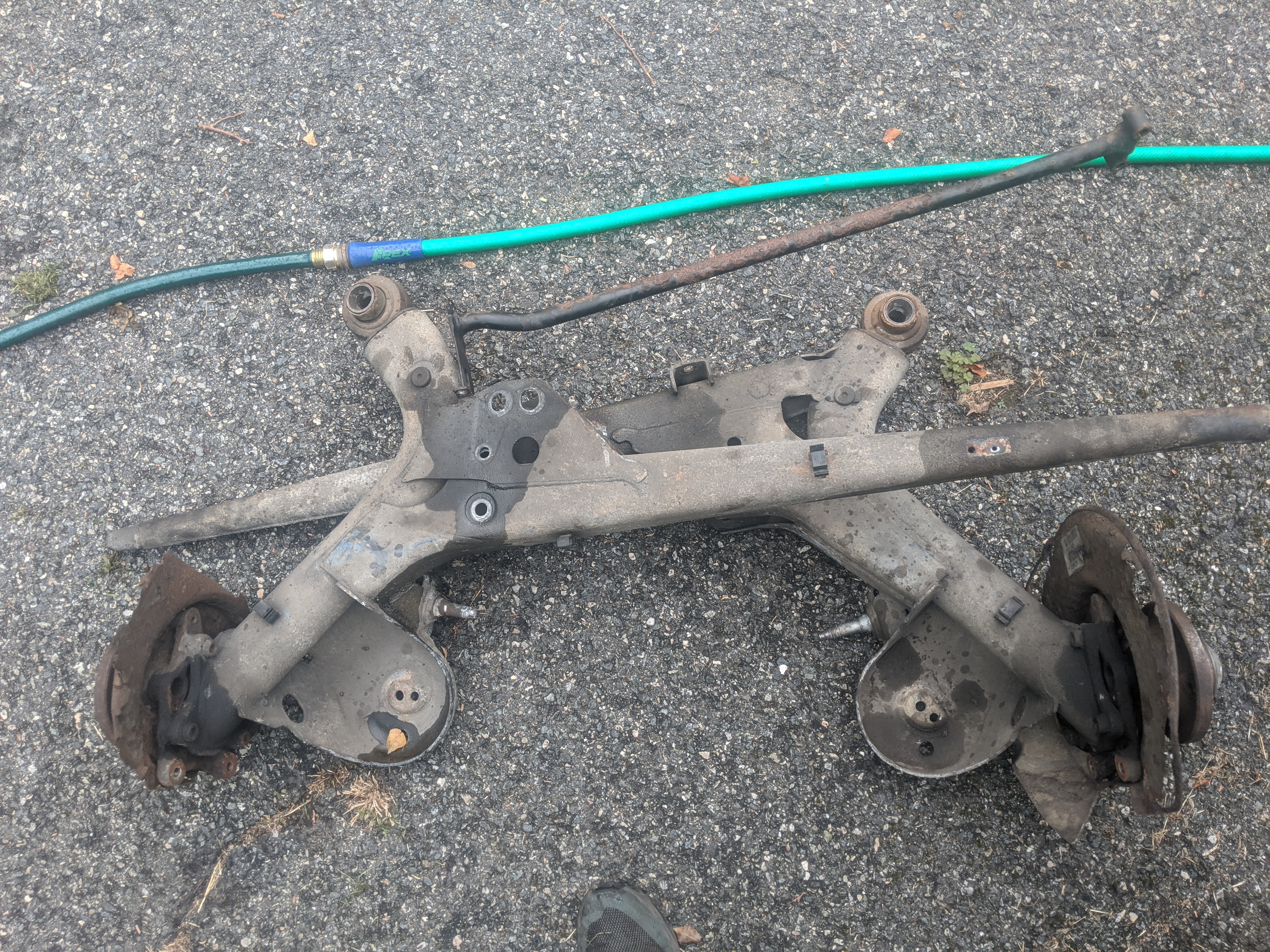

Suspension pt1 (rods, arms, struts+shocks, front+rear springs, subframe bushings, motor mounts)
Suspension pt2 (i broke a shock mount bolt, so i pulled a delta link off a c70 and replaced the inner bushings and outer endlinks, also replaced the frozen ebrake cables with volvo units (ouch))

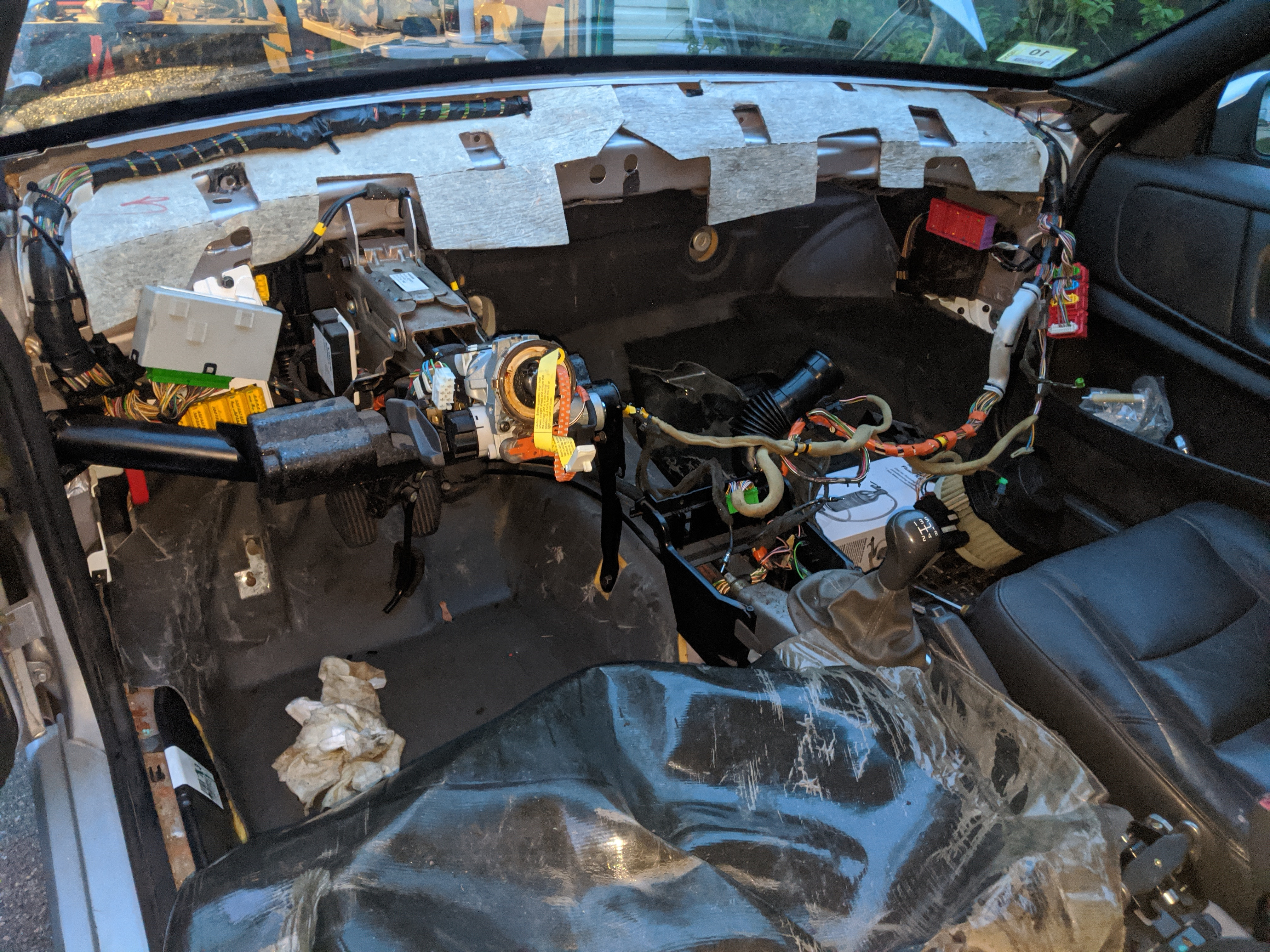

AC system + heating (compressor froze soon after I bought it so I deleted the ac, then later redid the entire system - compressor, condensor, evaporator, rebuilt the dash mounts, replaced the leaking heater core)
Clutch (I found a lightly used clutch and flywheel on the forum here for $400, so i pulled the engine to do that but also did all the associated hydraulic clutch parts)

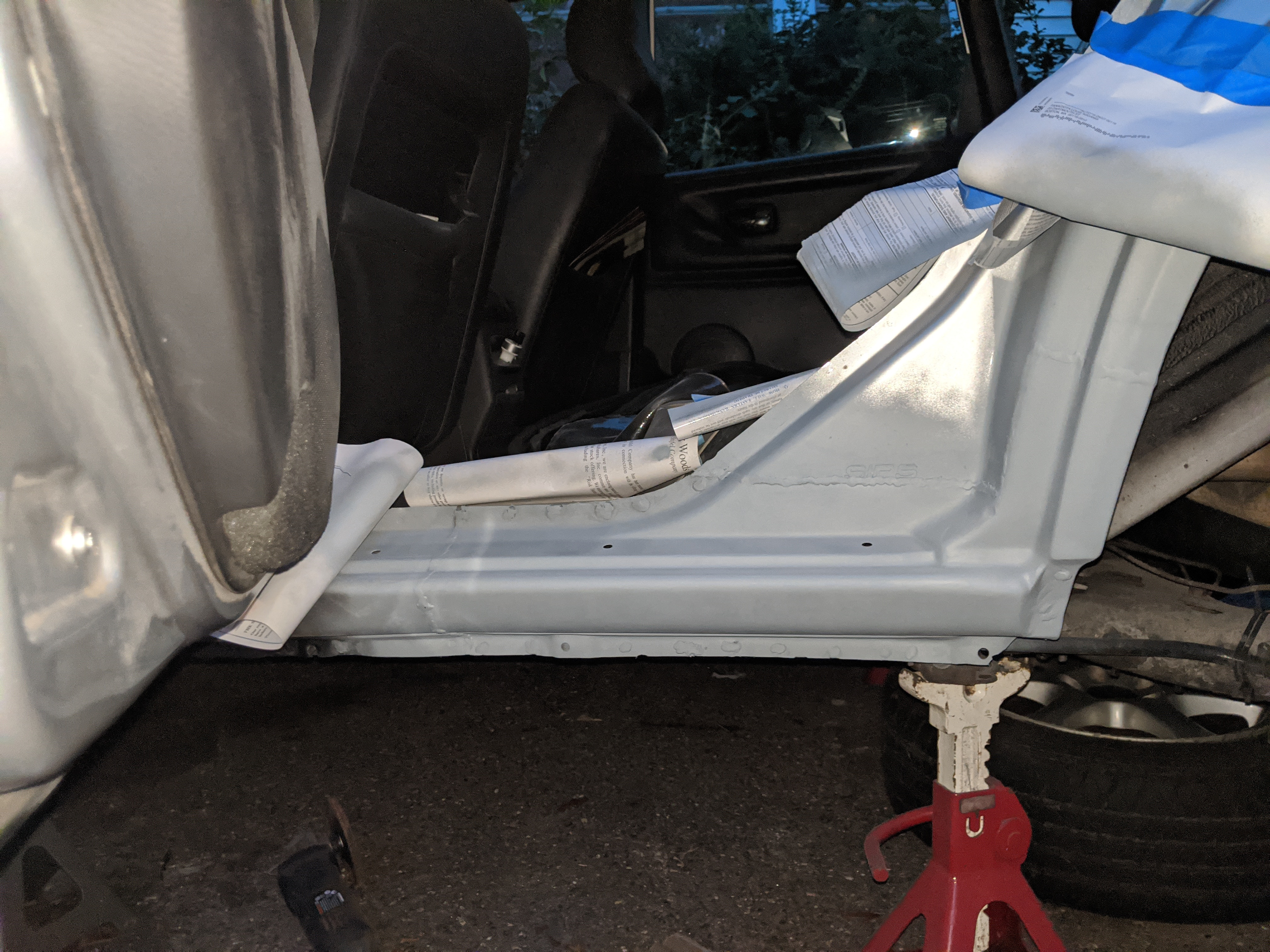

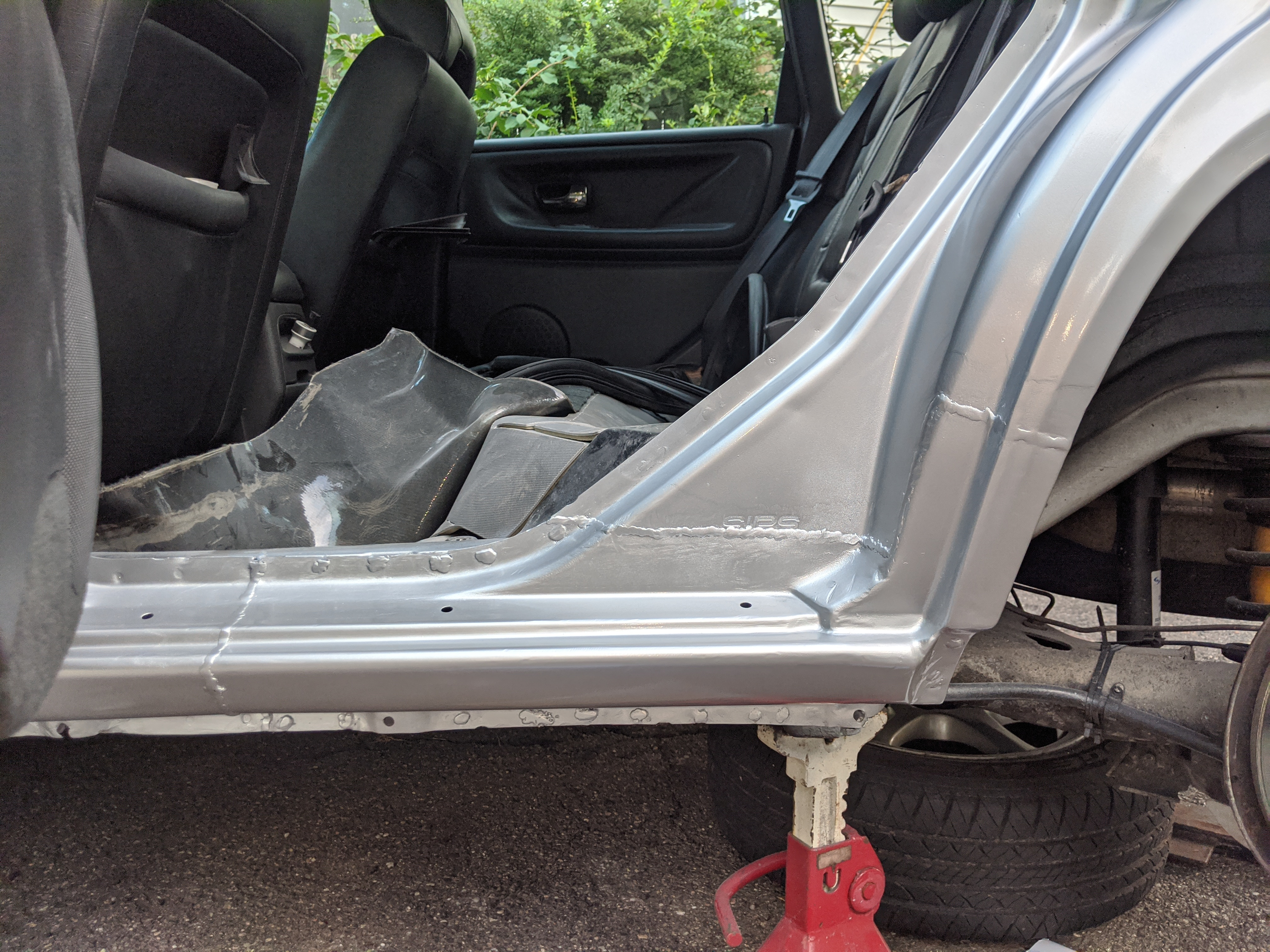

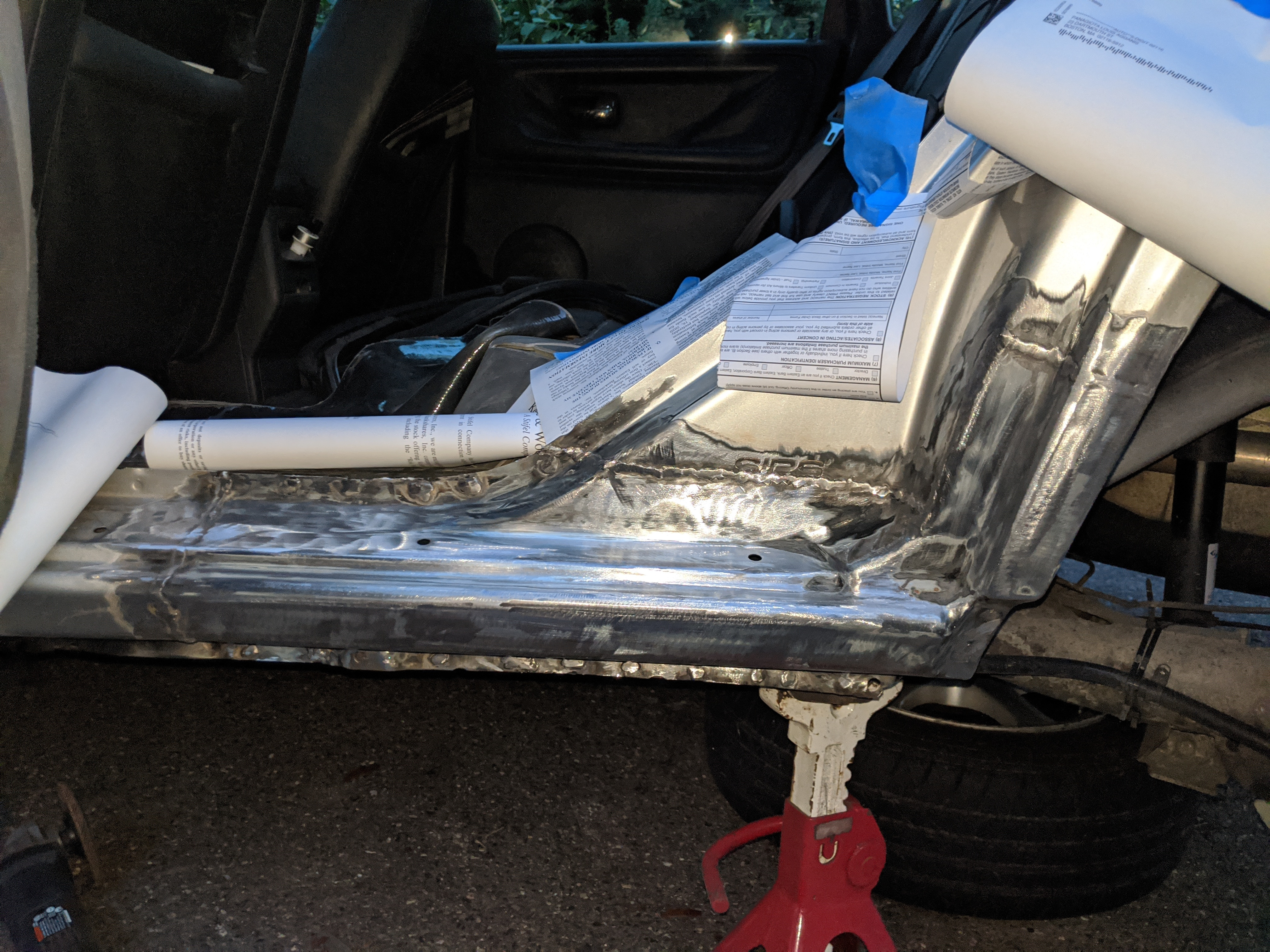

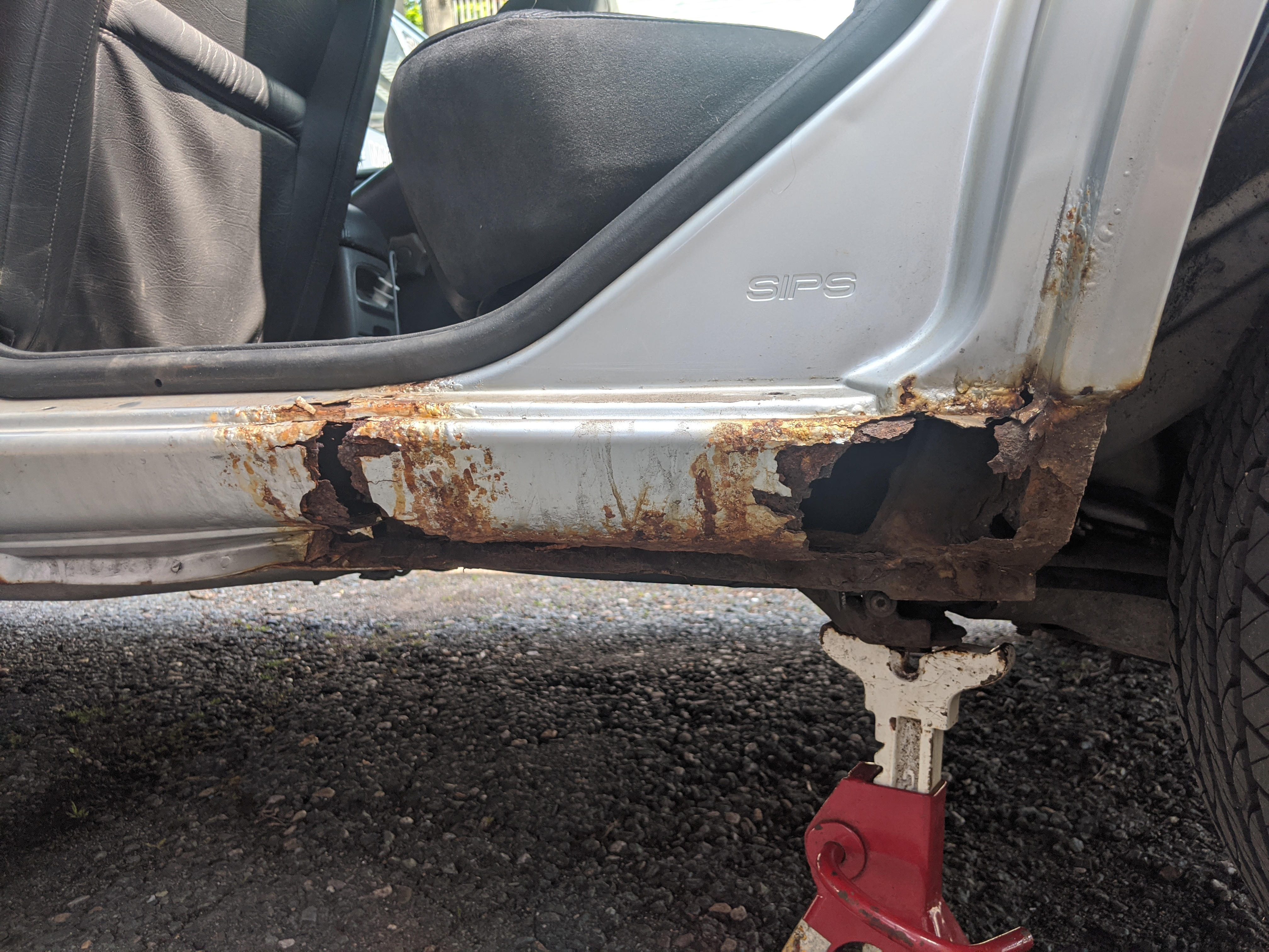

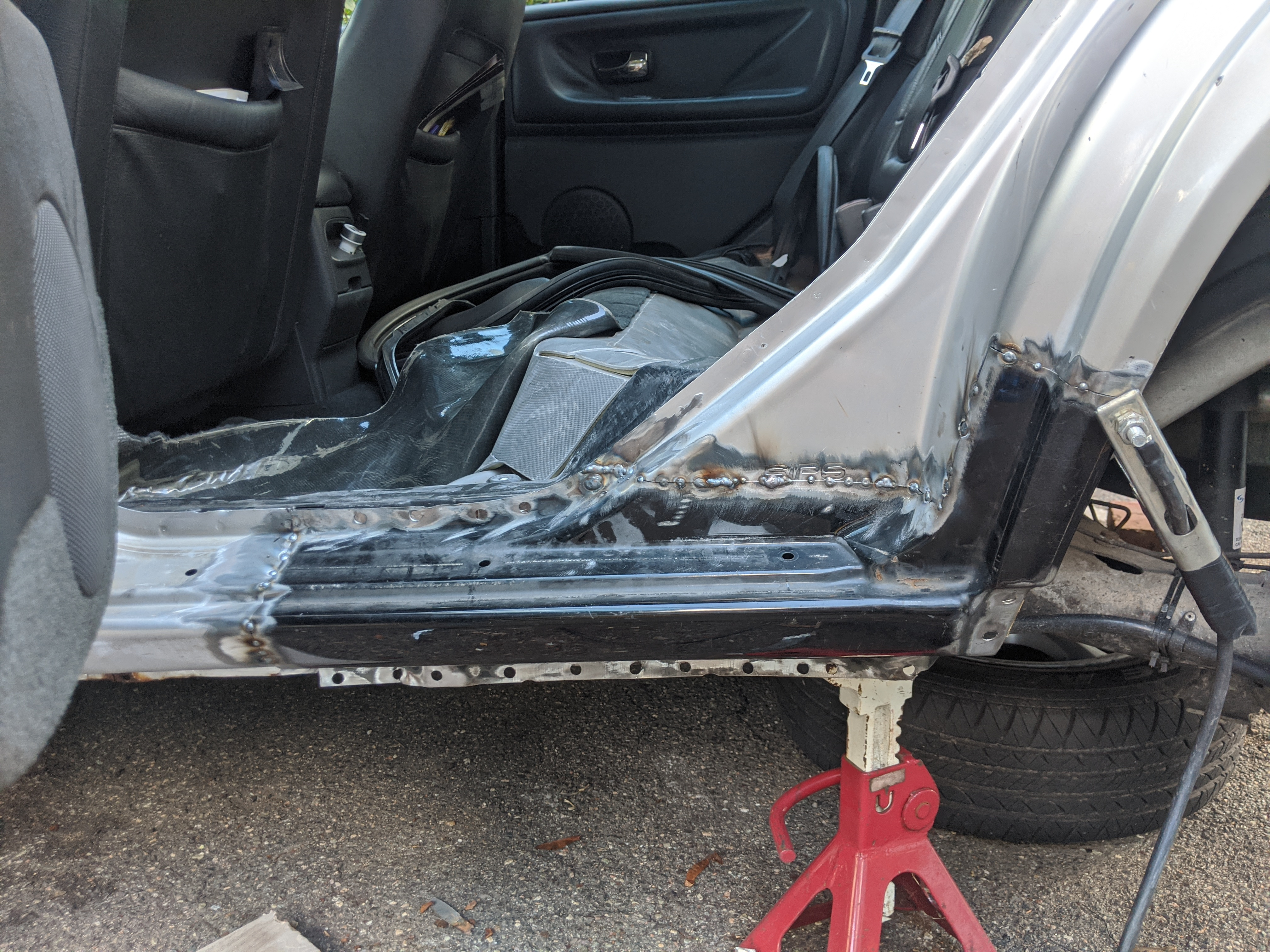

Rust Issues (at this point i found out the drivers side runner had rusted out, so i cut out the rust and grafted new metal in donated by abscate)
Along the Way (plenty of evap lines, little sensors, dealt with a ETS light which was caused by the brake pedal position sensor, couple junkyard starters, alternator, power steering pump, door switches, CV axles, resealed the oil pan, trunk struts, etc)

Head gasket (Volvo)
Valve stem seals (Volvo)
Surface Head
Intake, exhaust, coolant temp gaskets
PCV Kit (fcp)
Replace Dipstick tube and dipstick (updated model)
Front vaccum lines
Radiator hoses (Volvo + 1 aftermarket I forgot to buy)
Coolant Level sensor (FCP)
Cleaned throttle body (and new gasket)
Cleaned MAF
Negative Battery cable crimp
Vaccum hose behind the fuel filtel (fuel evap?)

Subframe bushings and IPD Poly inserts
Control Arms (Meyle HD)
inner trailing arm bushings (Meyle, FCP Euro)

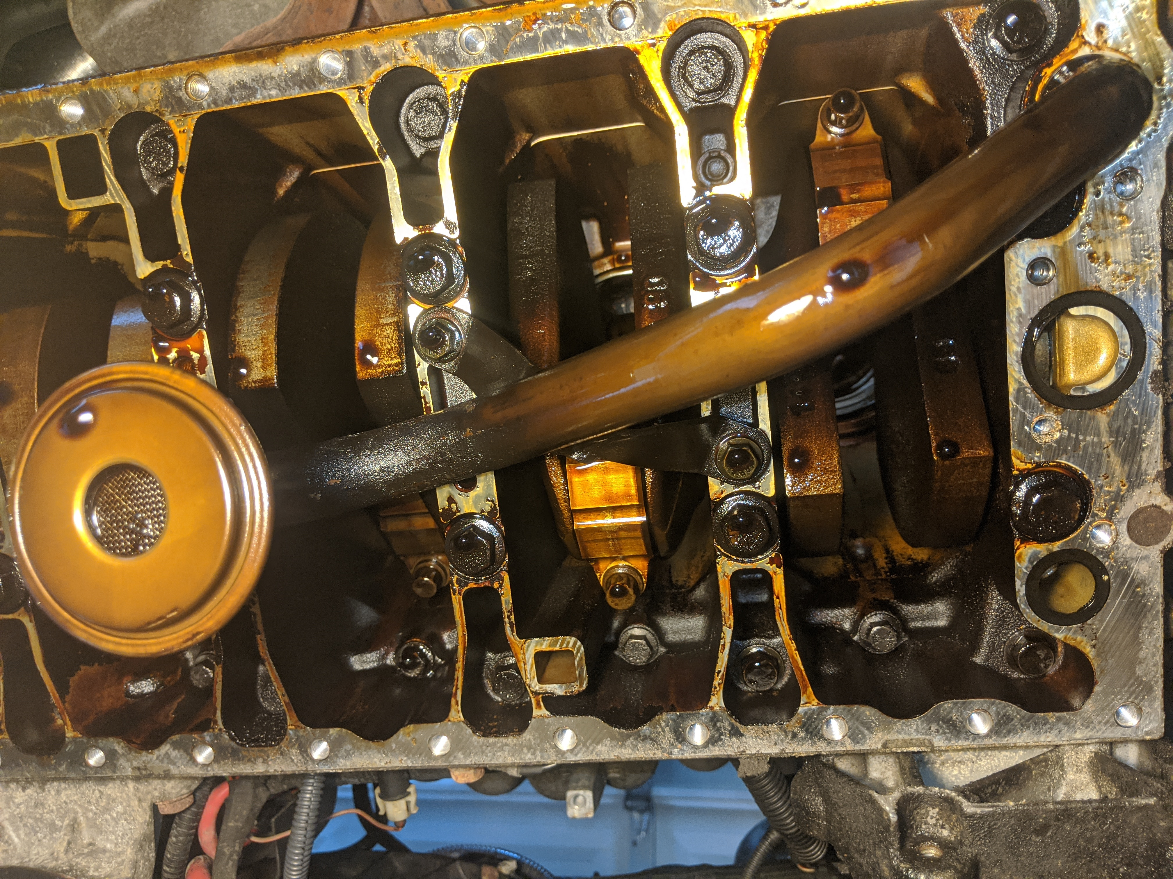

Oilpan - cleaned, new o-rings and resealed

Air conditioning:
-used Valeo compressor
-accumulator, condenser, evaporator, purge valve, new o-rings (FCP)
-flushed ac lines with solvent
Fixed dash tabs with 2 part epoxy
Driver's side window rail regulator tab
Rear driver's side window switch
Evap hose, (carbon canister to roll over valve)
Junkyard Throttle Body

Rear left rocker cut, replaced and painted
