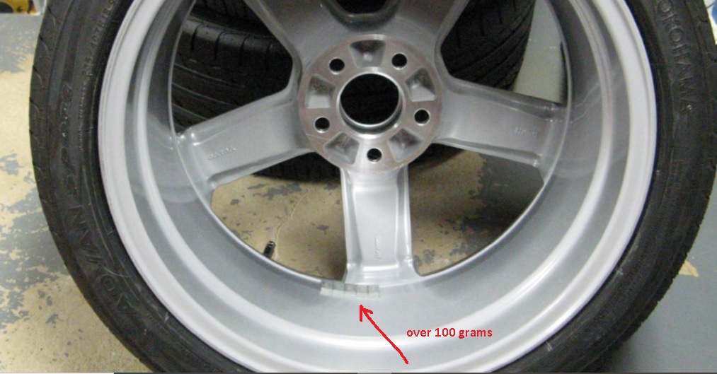

can you post a pic of how much weights were used for balancing, also get a volvo spacesaving spare to match
