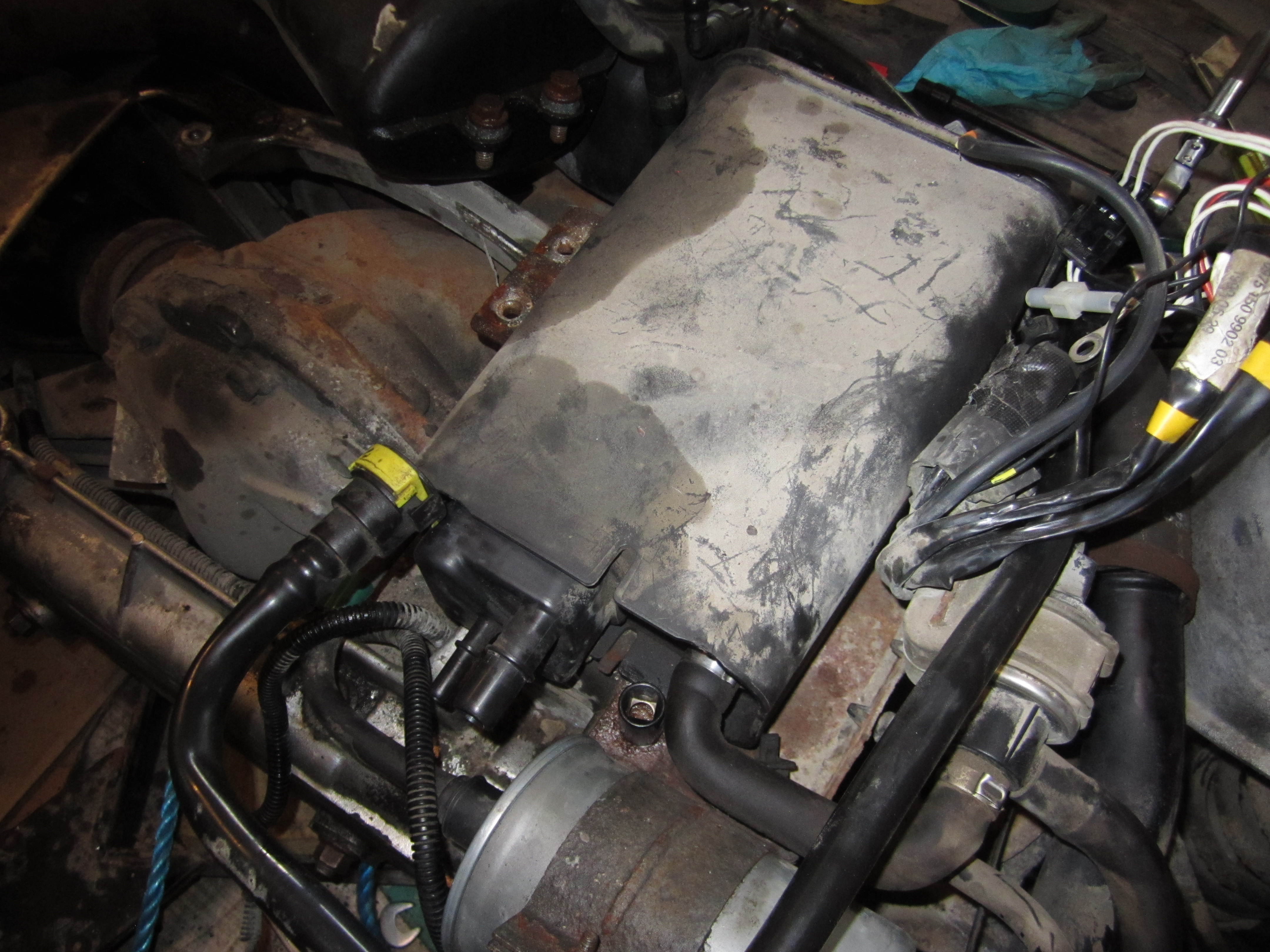

Yes. It is just forward of the fuel filter on the top of the rear sub-frame and just above the rear axles. The carbon canister (approx. 12" x 6" x 3" black box) is mounted on a securing plate, and on the rear of that is the fuel filter.
In the picture above you can see the carbon canister and fuel filter. The main pipe to look at is the one coming out of the rear right that is between the fuel filter and the canister. It is about 6" lone like a flattened 'U'. The other end goes to the roll over valve and you can see a pipe that runs out to the right. That runs up to the fuel filler. You really have to remove the pipes or the fuel filter to look properly at the pipe condition. Mine was of course split on the underside by the carbon canister.
Good Luck.
