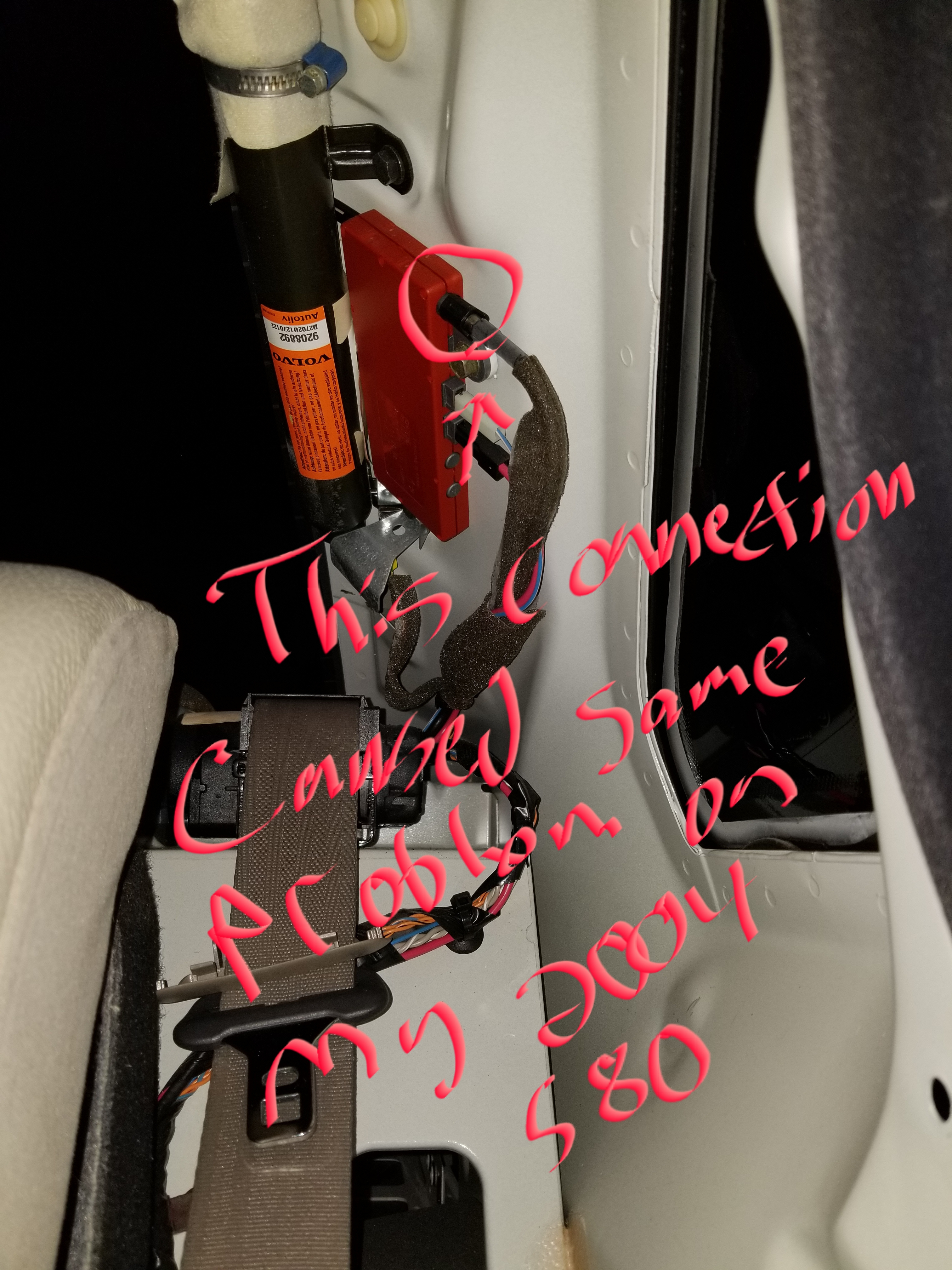

My radio FM is intermittent. Some times it works sometimes it doesn't. Am is typical static but goes away when i press rear defroster.
Realize there are hidden menu capabilities. Is there any adjustments I can make with the radio to resolve issue?

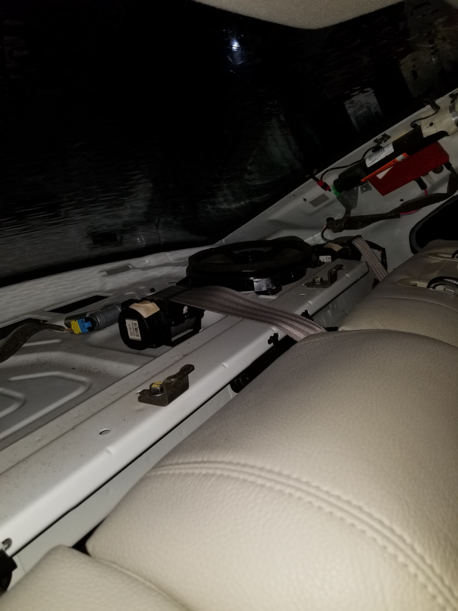

My 2004 S80 did the same thing. Then while the inner sail panels were removed i cleaned the antenna socket and plug on the amplifier. See marked photo below. I attached photo without my comments and one of the package shelf with the amplifier in the background to give you a reference to its location. June
