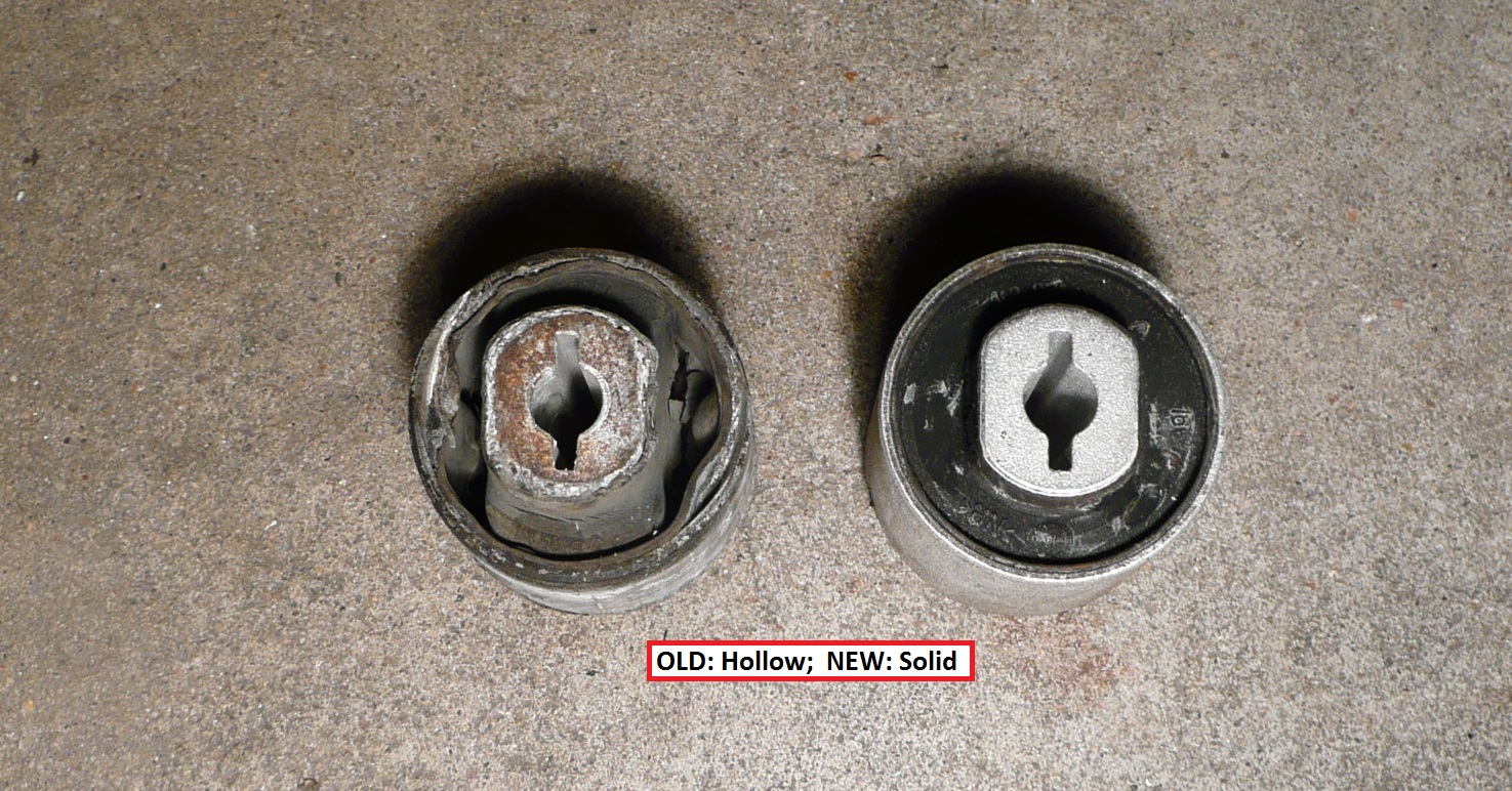

- I looked at all the REAR bushings. Only the Trailing Arm Bushing #3 is hollow from factory (it is now solid rubber). The rest of the bushings are solid rubber. So no need to worry about the rest until 250K or so.

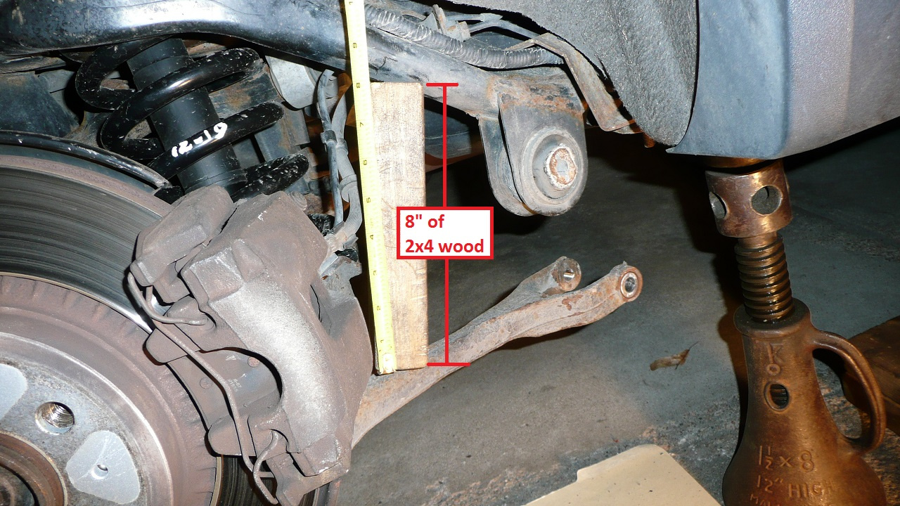

- A piece of 2 x 10 wood, about 8 inches long is very useful…

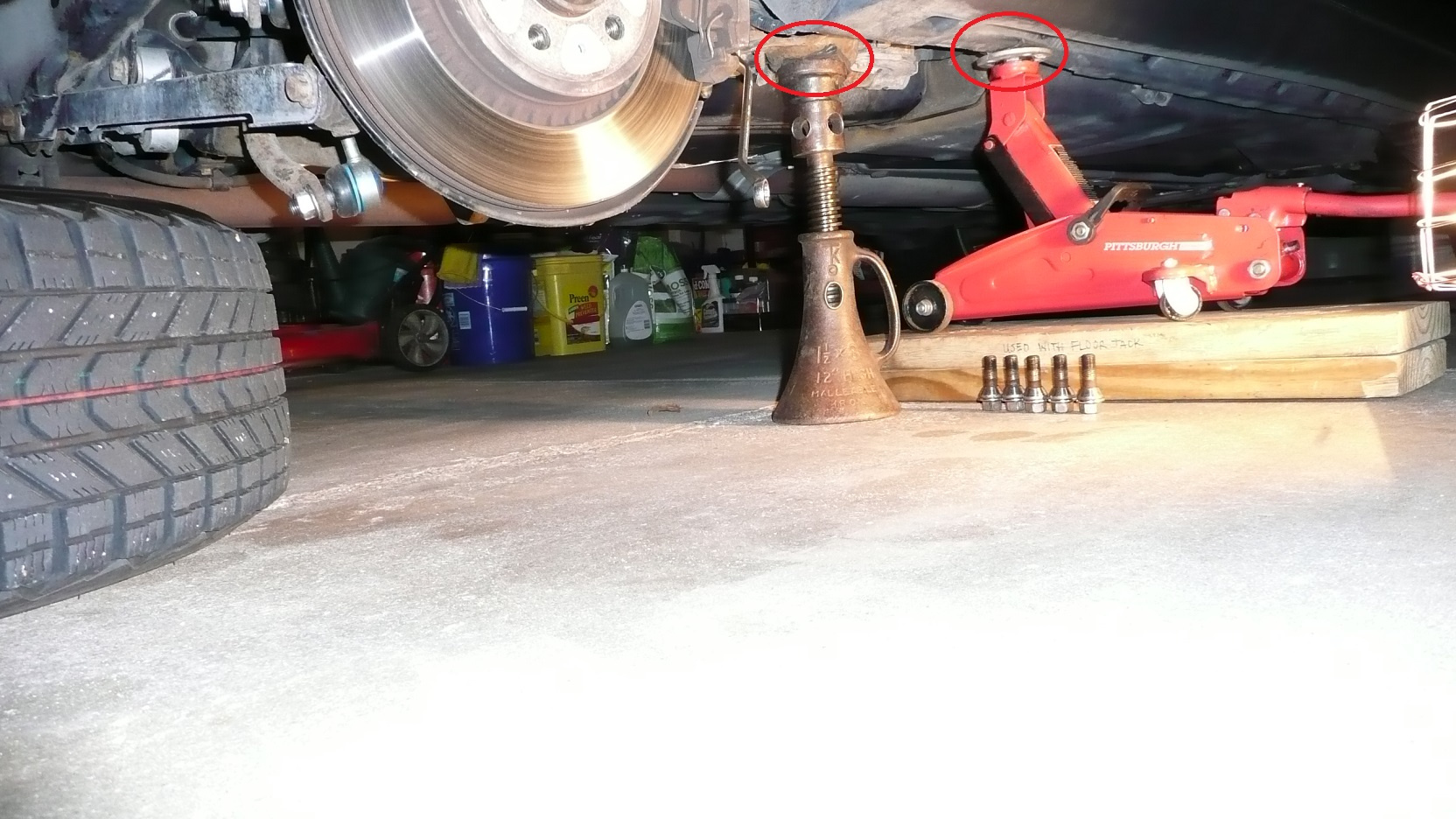

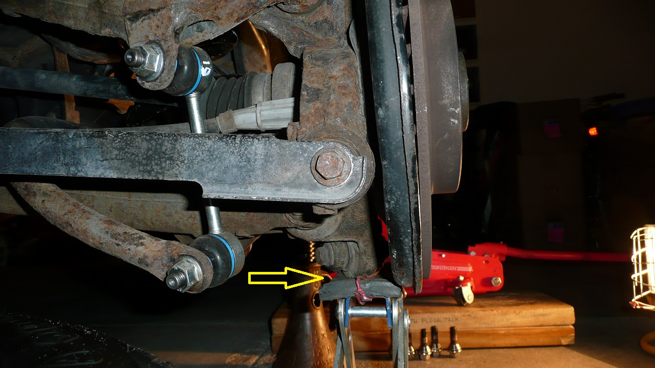

1. Safety first:
- Chock FRONT wheels.
- Lift the rear end, remove ONLY 1 rear wheel and support with jack stands as shown.
- For EACH side, I used 1 jack stand + 1 floor jack. No need to crawl under the car for this job.
- Tire + wood under the car.

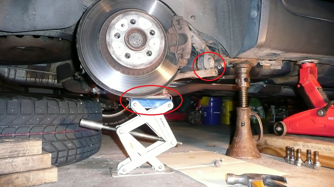

2. Once you have the car up with jack stand (note that I used screw-type jack for this), jack the control arm up a bit to allow you to remove the 15-mm bolt.

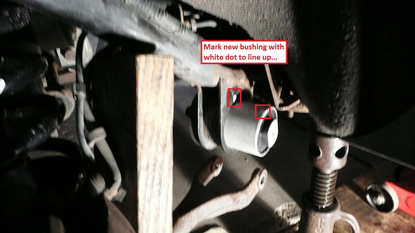

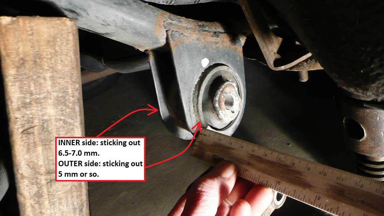

3. Piece of wood to create the space. Note that the factory bushing sticks out on both sides:
- OUTER side: 5.0-5.5 mm or so.
- INNER side: 6.5-7.0 mm or so.
Make sure you measured it.
- Also, the factory bushing used to be hollow on the fore and aft areas to allow the trailing arm to move back and forth. After thousands of cycles, the bushing cracks. The new Lemforder bushing is all solid rubber. But I line it up with the vertical slot as factory. So use liquid paper or white paint to mark it.

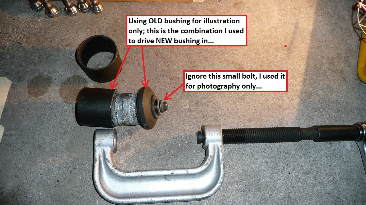

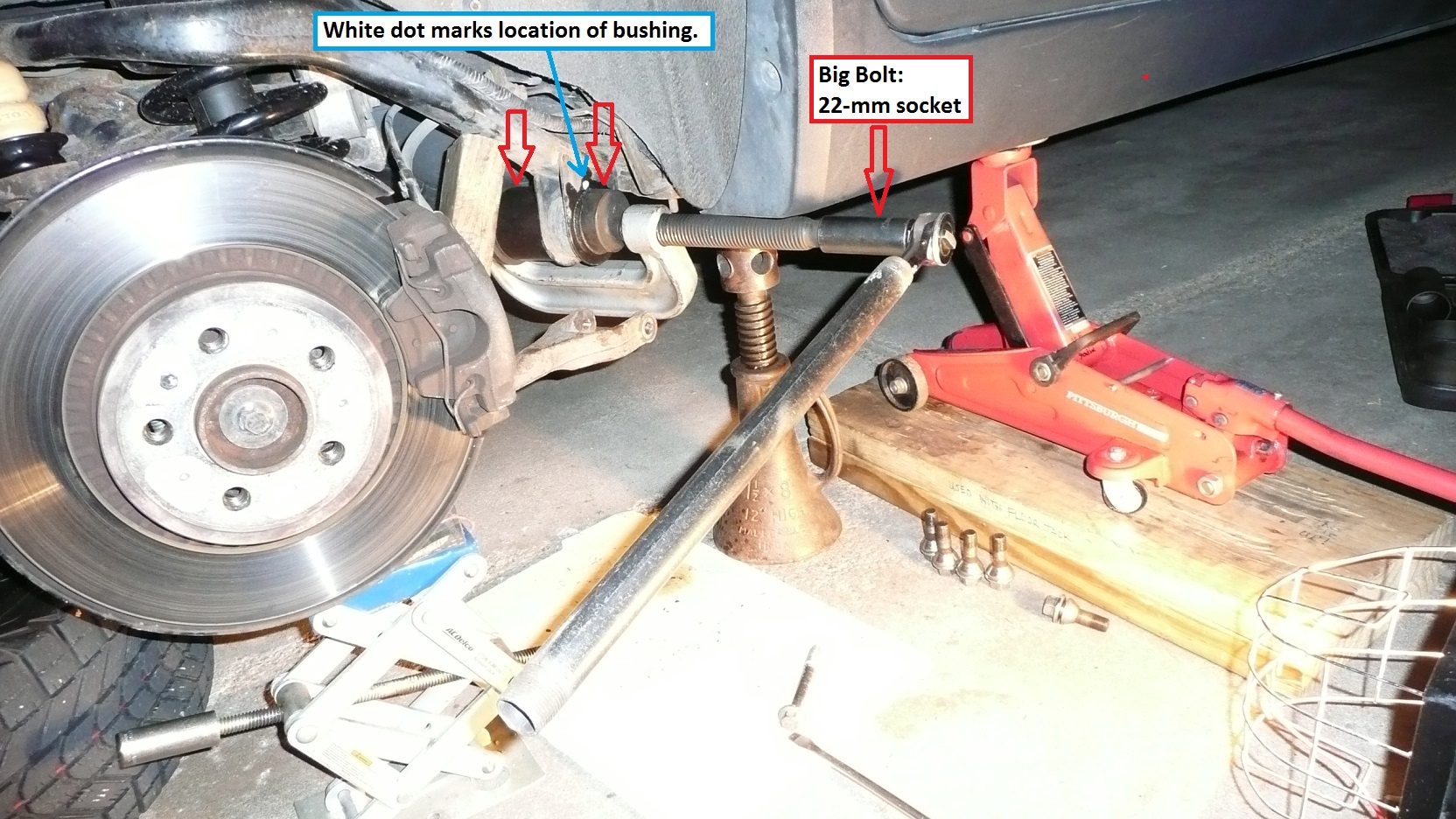

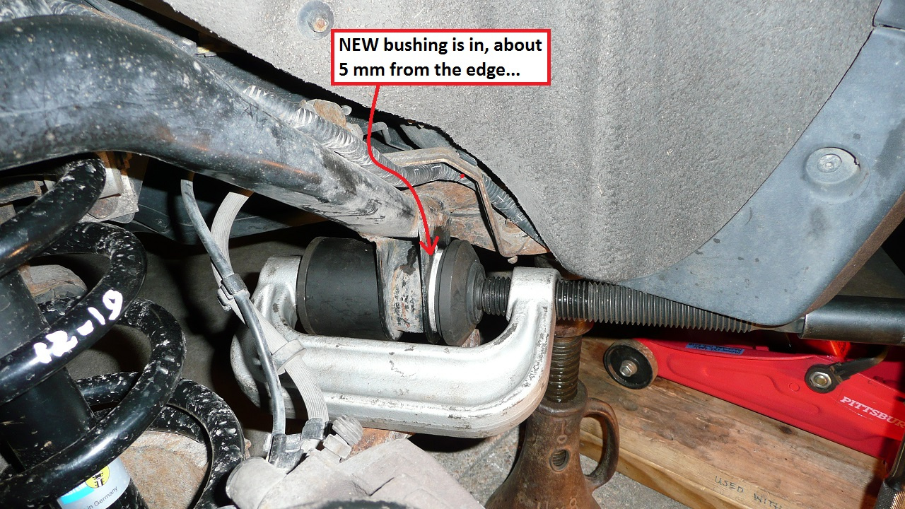

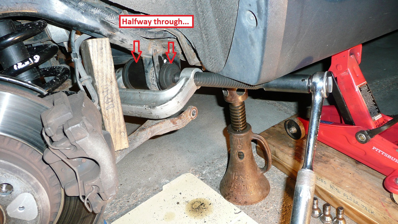

4. Various configurations of the "WMD" rental tool to show you how to remove/install bushing.
- Note that the rental tool is not Volvo factory tool, it is just generic bushing tool, so you will have to find the right combinations that work for you.

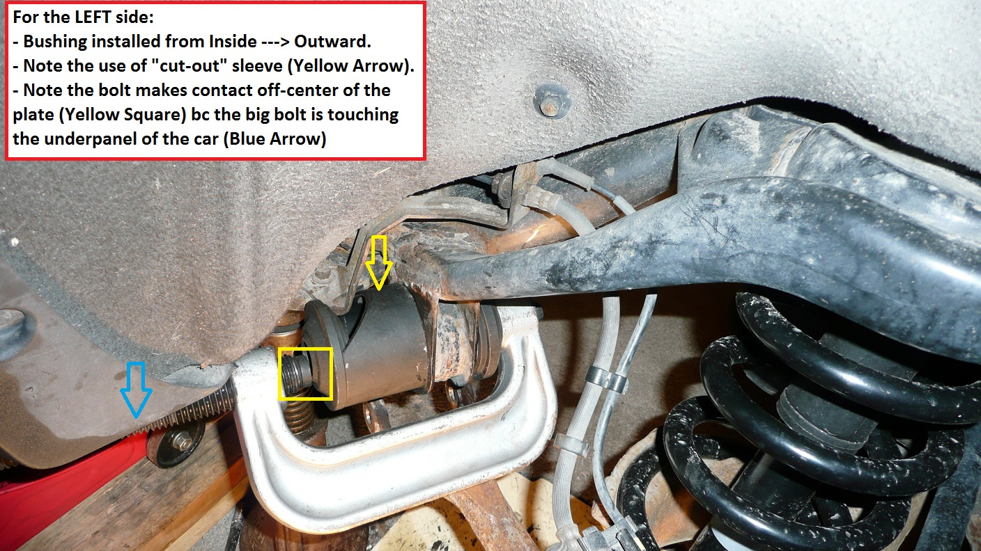

- Basic principle of any bushing: pressing a bushing against a hole. The idea is to press against the metal part of the bushing. Do NOT ever push on the inner section (where the bolt goes through), you will damage the bushing. Since I worked alone, it was difficult balancing act, so I used an M12 bolt to help hold the sleeve in place.
- On the “receiver” side, make sure the sleeve is large enough to accommodate the bushing. Sometimes when the old bushing comes out, it can hit the sleeve, causing the tool to bind, so be aware of this!
- When the old bushing comes out, it will create some loud bangs from the corrosion over the years. So be ready for this noise. Spray with PB Blaster to help lubricate it. The big bolt is VERY POWERFUL, you should be able to press the old bushing out (with some bangs). If the big bolt is stuck, something is messed up. STOP and verify before you damage the new bushing!
- The body underpanel partially blocks the big bolt, so if the bushing is slightly crooked, remove it and start again. I sprayed some lubrication to help it in. A bit of heat to warm the steel hole, plus frozen bushing helps reduce the force needed to press it in.
5. As mentioned above. Raise the control arm (watch exactly where to place the jack, it can slip any time!) to allow you to insert the 15-mm bolt. Tighten this bolt ONLY after the car is back on the ground.
PS: On the RIGHT side, I installed the new bushing from Outside ---> Inward. For the LEFT side, I installed the new bushing from Inside ---> Outward (because of tool clearance issue). Do what works for you.
