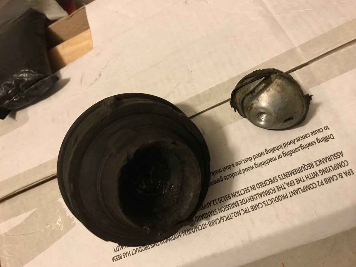

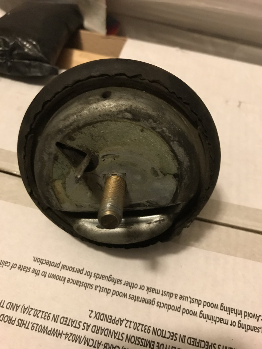

So the short story is the 2001 V70 NA AW55 does fit. The long story is it is not the same as the original mount which has a peculiar pin tab position that is clocked 45 degrees off from the normal position. There is also a half moon washer that fits between the mount and the transmission bracket that gets clocked 45 degrees off of the correct position when using the 2001 mount. However, these minor differences do not seem to add up to anything major. I did have to remove the bracket from the transmission because I could not jack up the engine high enough to get the new mount in, but that was a minor thing as well
Now I think the 2001 C70 rear mount for the AW55 5-speed auto looks to be the correct part even though it is catalogued as p/n 9434435 (which is wrong as that's the old standard mount) but the real part number Corteco 601775 (FCP SKU CTO-601775) appears to be the real deal.
Interestingly, the original mount had completely separated into 2 pieces so it was well and truly done and replacing it along with the front and passenger side mounts has resulted in an amazing reduction in vibration that we had all just gotten used to over the years.
