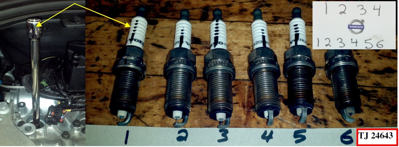

Start with the Spark plugs and PCV valve
If sparkplug #6 (the one closest to the AC compressor) is black and Spark Plug 1 isn't then the PCV is the likely culprit.
Also a misfire on #6 is likely due to a failed PCV
Note: if the sparkplug that is significantly different is 1, 2, 3, 4, 5 and its the only one then the root cause is likely not the PCV
From the TJ If Engine Control Module (ECM) DTC P030000 and/or ECM P030600 are
present and if spark plug # 6 and in some cases also # 5 show significantly more
deposits and have more soot than the other cylinders, it is very likely that the engine, at
some point, has been overfilled with oil or is consuming oil via the Positive Crankcase
Ventilation (PCV) system. The DTCs indicate that oil has been consumed in the engine
causing misfires (above mentioned DTCs).
These sparkplugs look normal

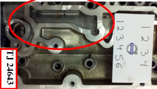

Broken PCV
If the PCV is broken then oil may be present in the location shown
When I replaced my PCV it looked more like this
Note: I replaced mine as part of my preventative maintenance plan.

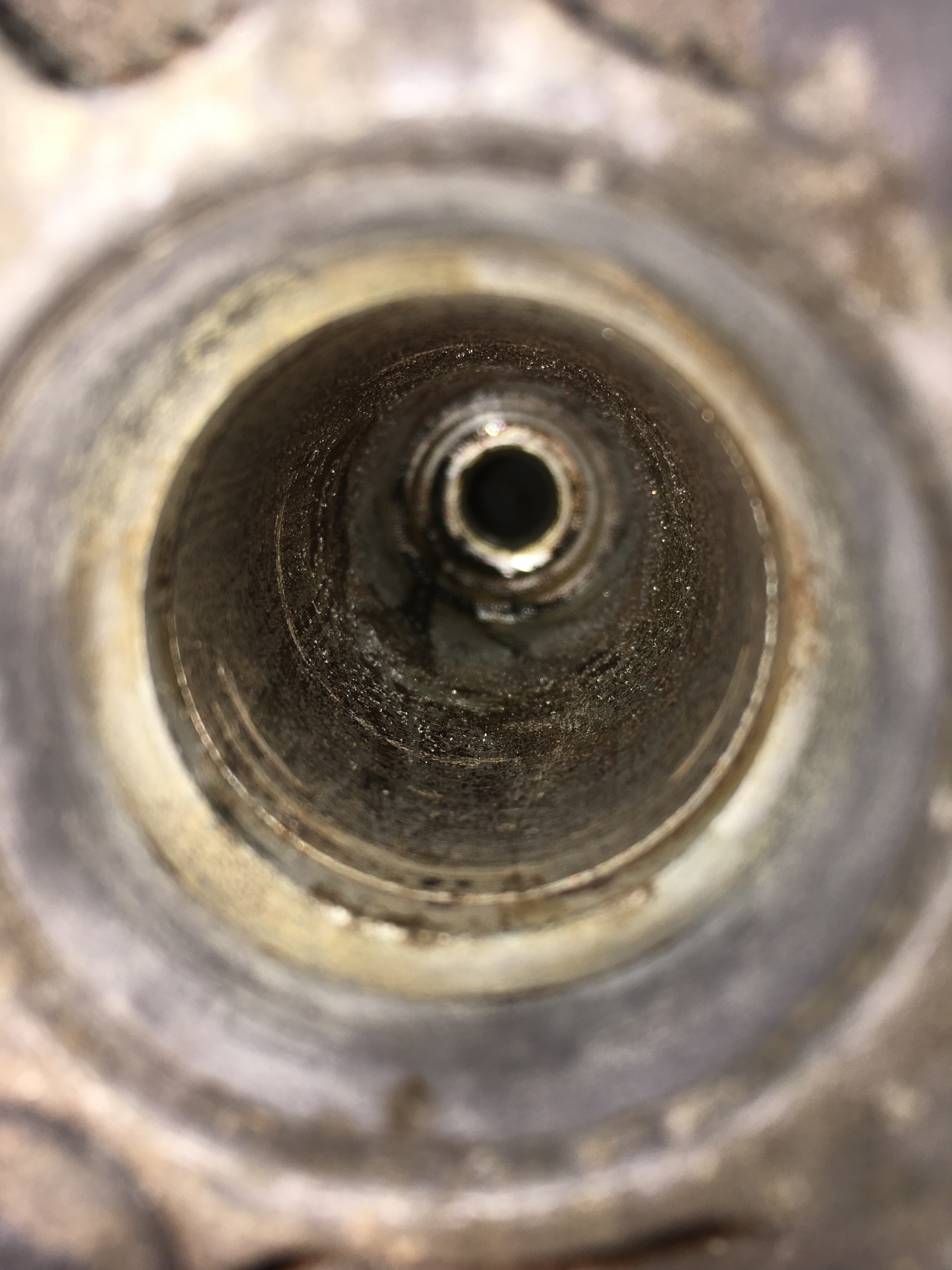

Pgill gives excellent advice. Pay attention to the condition of the spark plugs you remove. Also look down the spark plug well with a flash light and look at the piston tops. If you have an oil burn condition you will see oil fouled plugs and oily piston tops.

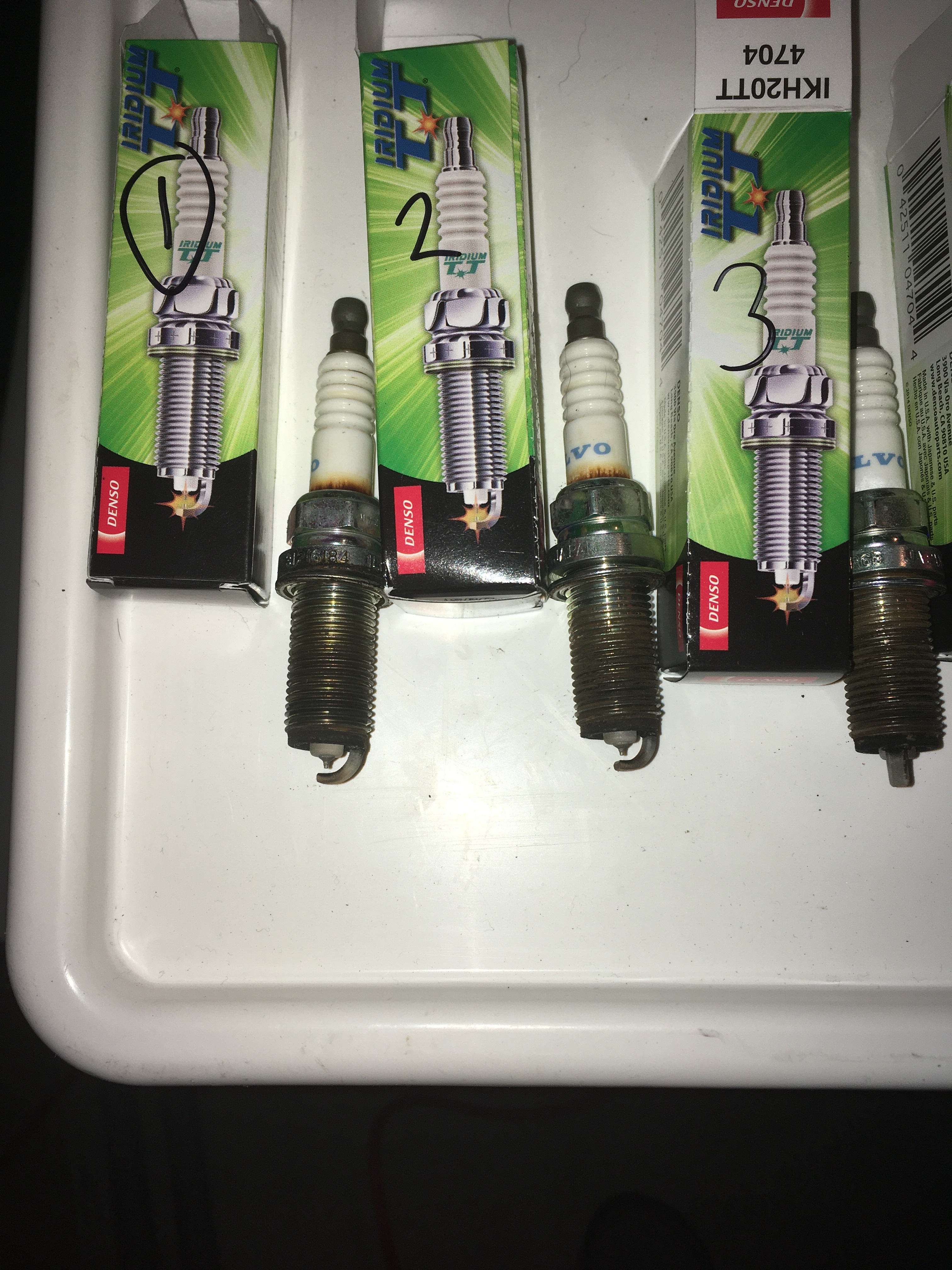

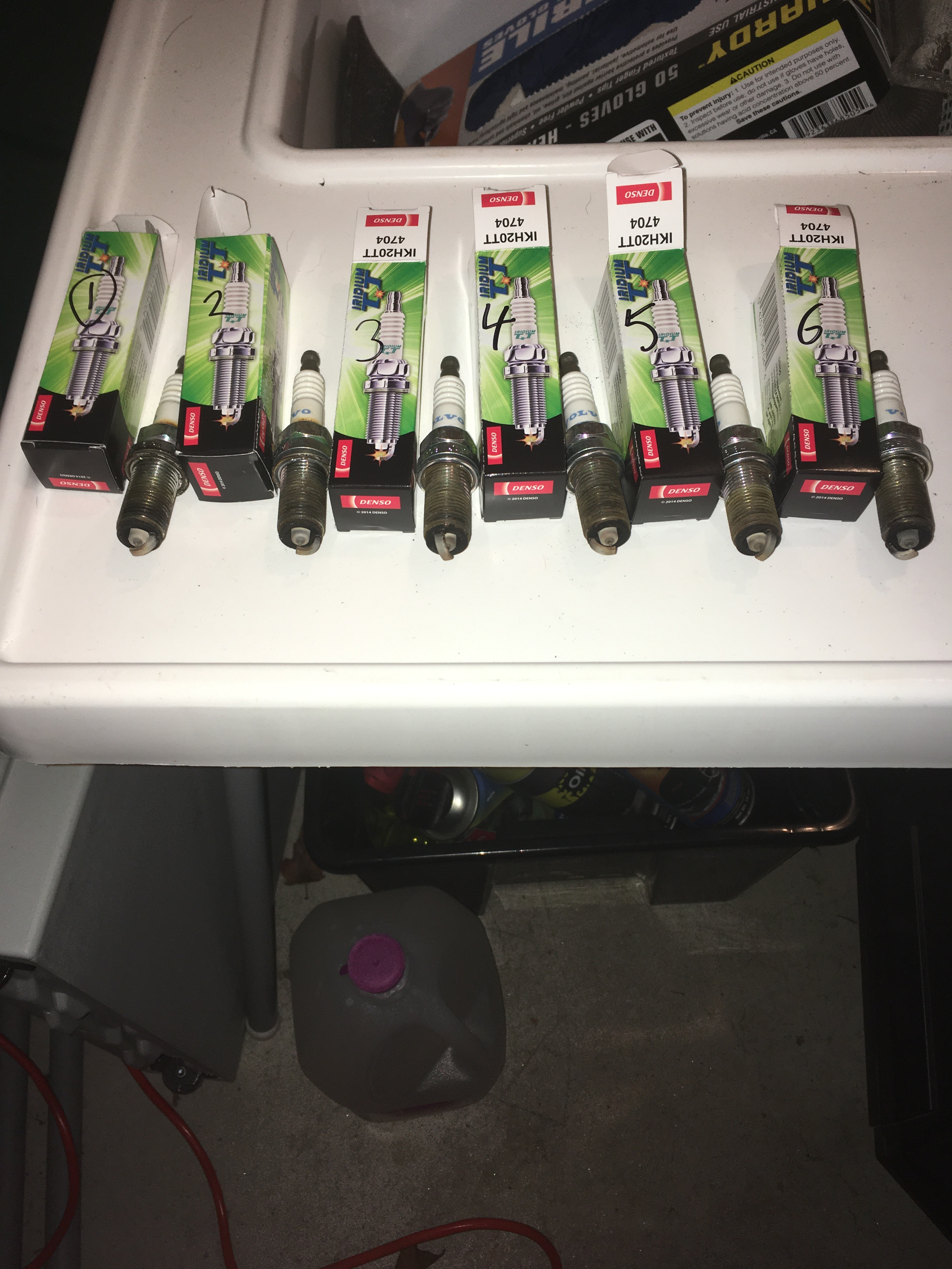

Finally found the time to start working on. Replace the spark plugs. Pretty shocked to see how they turned out, considering they were replaced with the coils approximately 1 1/2 years ago, when first one coil failed and then shortly after another one.
The photos show also the shaft of cylinder number one. The other shafts don’t look that bad.
Also, what I forgot to mention. The engine consumes quite a bit of oil, 0.5 to 1 quart per 1000 miles. The engine has done that for the last couple of years.

I did notice one difference between these sparkplugs and the other ones.
At the interface of of ceramic to the metal you have evidence of arcing on cylinder #1 #2
To prevent this I use dielectric grease on the top of the ceramic to improve insulation. (the coil boot will push the grease down during installation)
The grease is more protective than air for preventing arcing.
