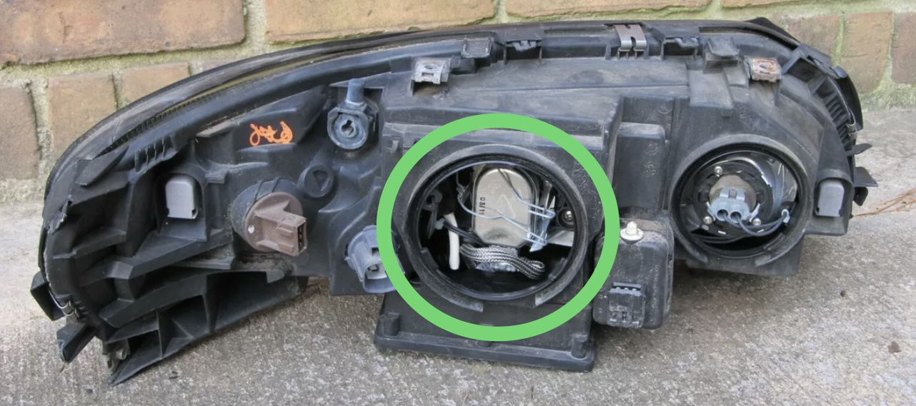

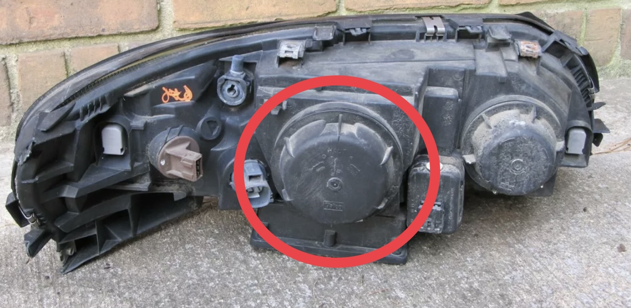

This sounds like the auto leveling HID’s that some XC70’s came equipped with. If the reflector tilts up & down it must be HID. Please correct me if I’m wrong.
There are 2 circular cups that you can remove for bulb access. I haven’t had to replace one of my HID’s yet (I’m literally knocking on wood) so can’t help you further than that. You may google search for ‘HID bulb replacement on S60R/V70R’ as they had very similar headlights to your HID’s.

The bulbs come out through the access door, the bumper does come off to remove the whole headlight, though.

The bumper comes off easily, there are 2 bolts in the front that are hidden behind 2 square trim pieces, then there are 2 screws by the fenders that remove the locking mechanism. Removing those 4 will let you remove the bumper. However, If you have skinny arms and long fingers, you can do it without removing the headlight.
