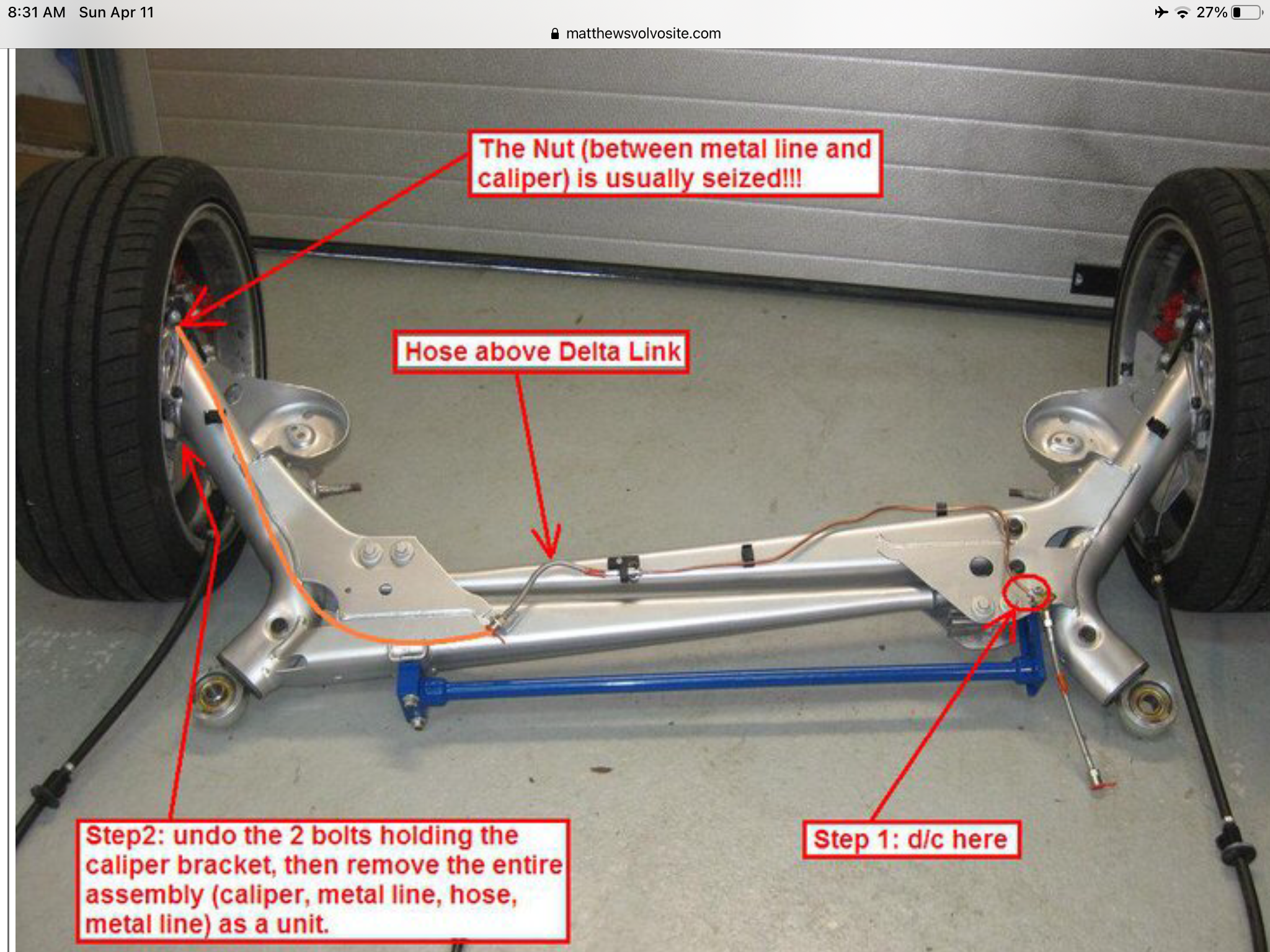

Reading this, I feel like I got lucky when I replaced my brake hoses--I managed to change both fronts and rears and bleed the system in a short afternoon.
The rear hose over the delta link was the most daunting. It was in good shape, and I approached it with a "what the heck" attitude. I had already ordered the part and figured I could just leave the old one in if I couldn't remove it. It did take some patience, and a good flare nut wrench, but I found it wasn't nearly as hard I was expecting.
One of the secrets to my good luck is having a Pacific Northwest car. There was practically no corrosion on any of the fittings. If rust or the need or great leverage had been involved, I suspect I would still be running the old delta link hose, or still be under the car...

I agree, it's going to vary car by car, some may be impossible some pretty easy, you won't know until you try.
Last fall when I dismantled the rear brakes on my parts car while it was in the driveway, I did not have much trouble with the brake hose above the delta link so I was able to just remove it all piece by piece, from caliper to metal lines to hose (I threw out the hose, kept the lines and calipers). I think it took about an hour and a half to remove everything, including the rear hubs.

cn90 wrote: 17 Apr 2015, 08:58 Further to what I said above...
I "borrowed" this photo from the web to show you how I'd approach the hose above delta link.

Eddystone wrote: 08 Apr 2021, 10:05 I would never allow my rear suspension to get into the deplorable sort of condition this one pictured is in.
Some people just don't maintain their Volvos.
Look at the grease stains on those delta links....horrible
