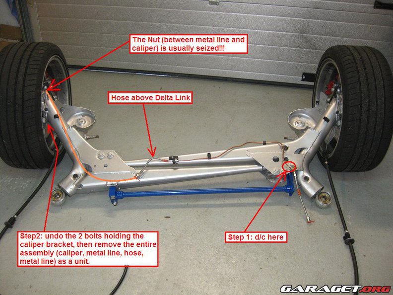

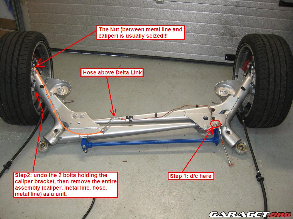

Further to what I said above...
I "borrowed" this photo from the web to show you how I'd approach the hose above delta link.
This particular hose is impossible to replace in situ.
Since the nut that connects the metal line to the caliper is usually seized over the years of service, the best approach is as in the photo below:
- Step 1: d/c the metal line at the Y-connector (LEFT REAR side).
- Step 2: undo the 2 bolts holding the rear caliper and remove the whole thing (caliper ---> metal line ---> hose ---> metal line) as a unit.
- Then deal with the hose once it is out of the car. You still need to use heat (propane torch etc.) to undo the hose.
