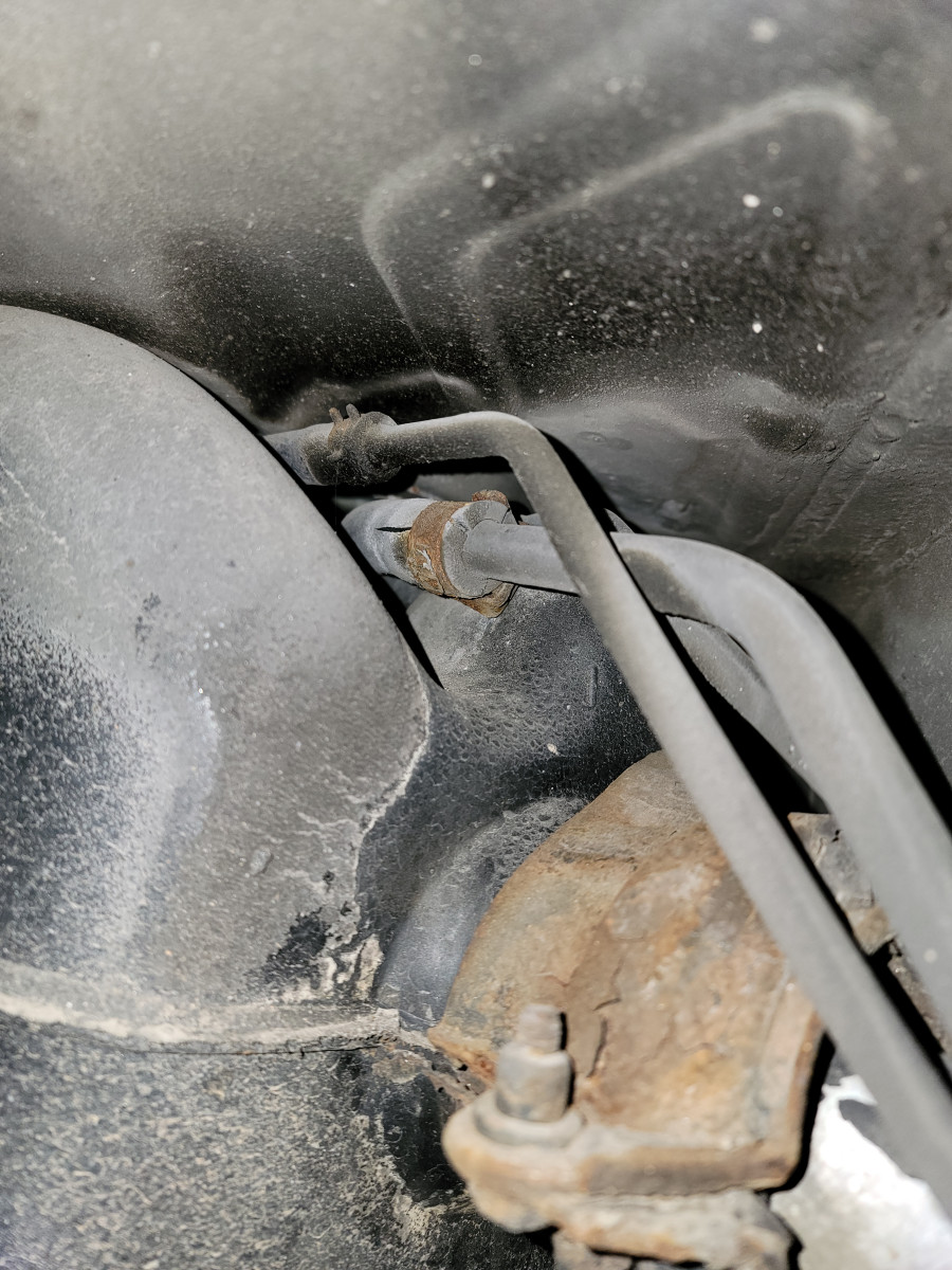

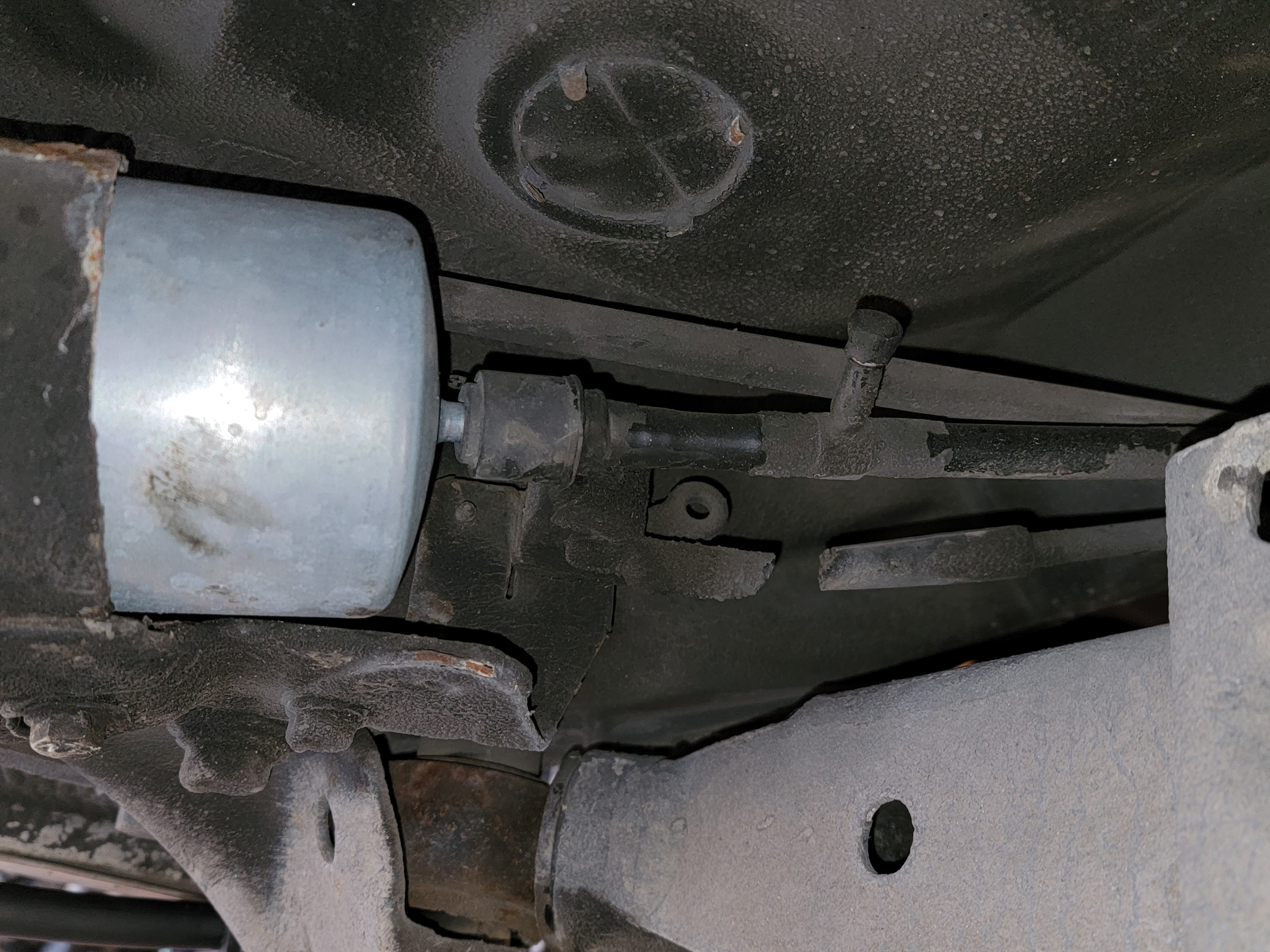

Hello, hopefully someone more knowledgeable than me will make quick work of this:

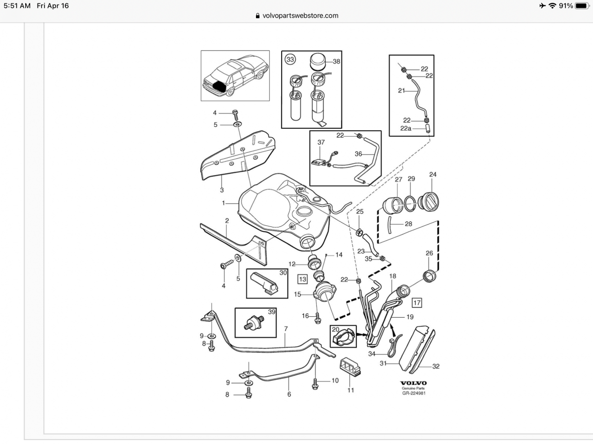

#1. The larger hose with the crack is the fuel tank vent hose right? (Part #: 3531434). I can't quite find the smaller one, though it seems like it may not be available. Looks like it goes into a metal line a short ways down and may be able to be replaced by a generic fuel hose? Also, yes, I am also replacing the filler neck clamps.
#2. This broken one right next to the fuel filter. I'm not having luck tracking this one down. Surprisingly between these two hoses, I have no CEL (light isn't burned out!).
I may end up dropping the tank to fix these and anything else up in that area. Open to suggestions on any additional parts to gather if I were to do that. I'm kind of assuming that basically everything on this car is broken.
Thanks!

I know that on my ‘94 some of those hoses above the tank have a different diameter at each end, so a generic hose won’t work. I would double check that.
- Posts: 35267
- Has thanked: 1497 times
- Been thanked: 3810 times
I think 23 is the only gotcha part there, with a 19x 13 ID size change

I've replaced the hose shown in image #2... More detail available here:
viewtopic.php?p=369977

Luckily I think that hose is still available. As for the others, not sure but I'll let you know, thanks!abscate wrote: ↑16 Apr 2021, 03:56 I think 23 is the only gotcha part there, with a 19x 13 ID size change
Ed.. as payfoward for recent sheparding duties , let me know if you need Gates barricade fuel line for any of this work. I bought rolls to redo the S70 so have it in ample sufficiency. It’s expensive, like $6 a foot in short pieces, but it’s the stuff of Champions
That's what I needed! Today I learned what the roll-over valve is, thanks. I guess in my 2000 XC it's a bit more sophisticated, but this one seems mechanical and pretty simple. I'll yank it out and replace the hoses.jreed wrote: ↑16 Apr 2021, 05:34 I've replaced the hose shown in image #2... More detail available here:
I'm assuming it's possible to replace the length of the hose without dropping the tank or anything?
