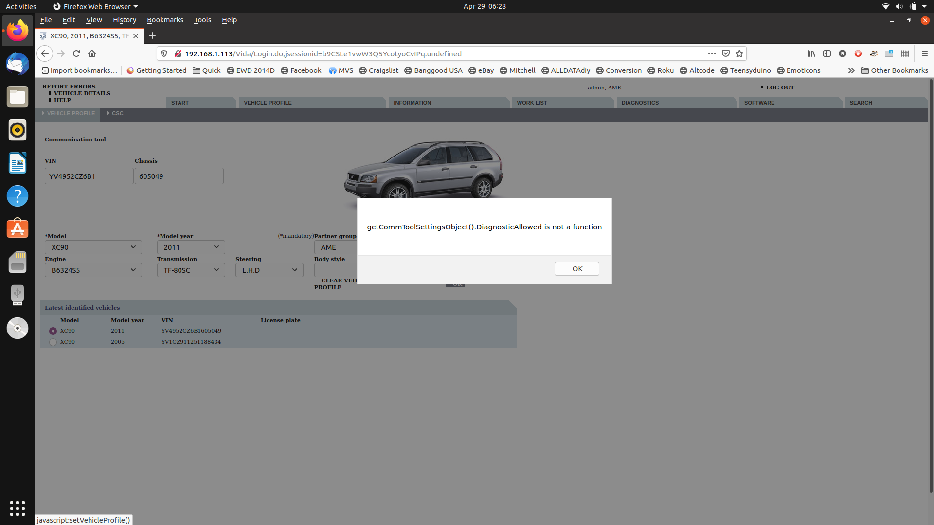

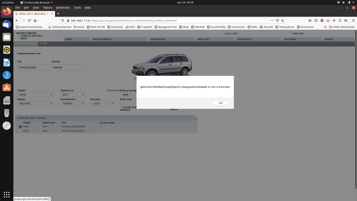

I tried to install VIDA in a VM today. VIDA install failed in a Virtualbox VM. Then I got a crackpot idea for another solution .. Getting close as you can see in the screenshot.
I recall running Internet explorer in Linux a few years back with a wrapper. If I can find that again, I might just pull this off. I really don't need all of IE11. Just the IE11 rendering engine for the ActiveX.

VIDA 2014D works very well for me in Linux -> KVM -> Win7.

vtl wrote: 29 Apr 2021, 06:27 VIDA 2014D works very well for me in Linux -> KVM -> Win7.
My hardware does support virtualization. KVM might work out better.
I changed the VIDA/Jboss Application Server's public interface on a different machine so that it could be accessed remotely ( Look at the ip address ). Not quite working because a Linux client has no ActiveX. It will work Windows to Windows.
I did something like this before useing remote desktop and it worked because everything is running on the server side.

5ft24 wrote: 29 Apr 2021, 10:11 has a plugin "IE Tabs" running it on chrome in Windows 10 for VIDA
It was IE4linux. A open source script that allows running Internet Explorer using Wine. No longer in development and only goes up to IE6.
IE Tabs in Chrome is what I use on my Windows machine. IE Tabs makes use of the IE rendering engine. You still need IE installed.
There is now a IE Tabs extension for Edge. Vida runs better in Edge or Chrome with IE Tabs. There was a IE Tabs for Firefox long ago but it not compatible with the current versions of Firefox.
Got switched to KVM ... much faster. Think I will forgo installing Vida in the VM and use Edge with IE Tab to access the VIDA server on the other machine. That should keep the load on the VM light.

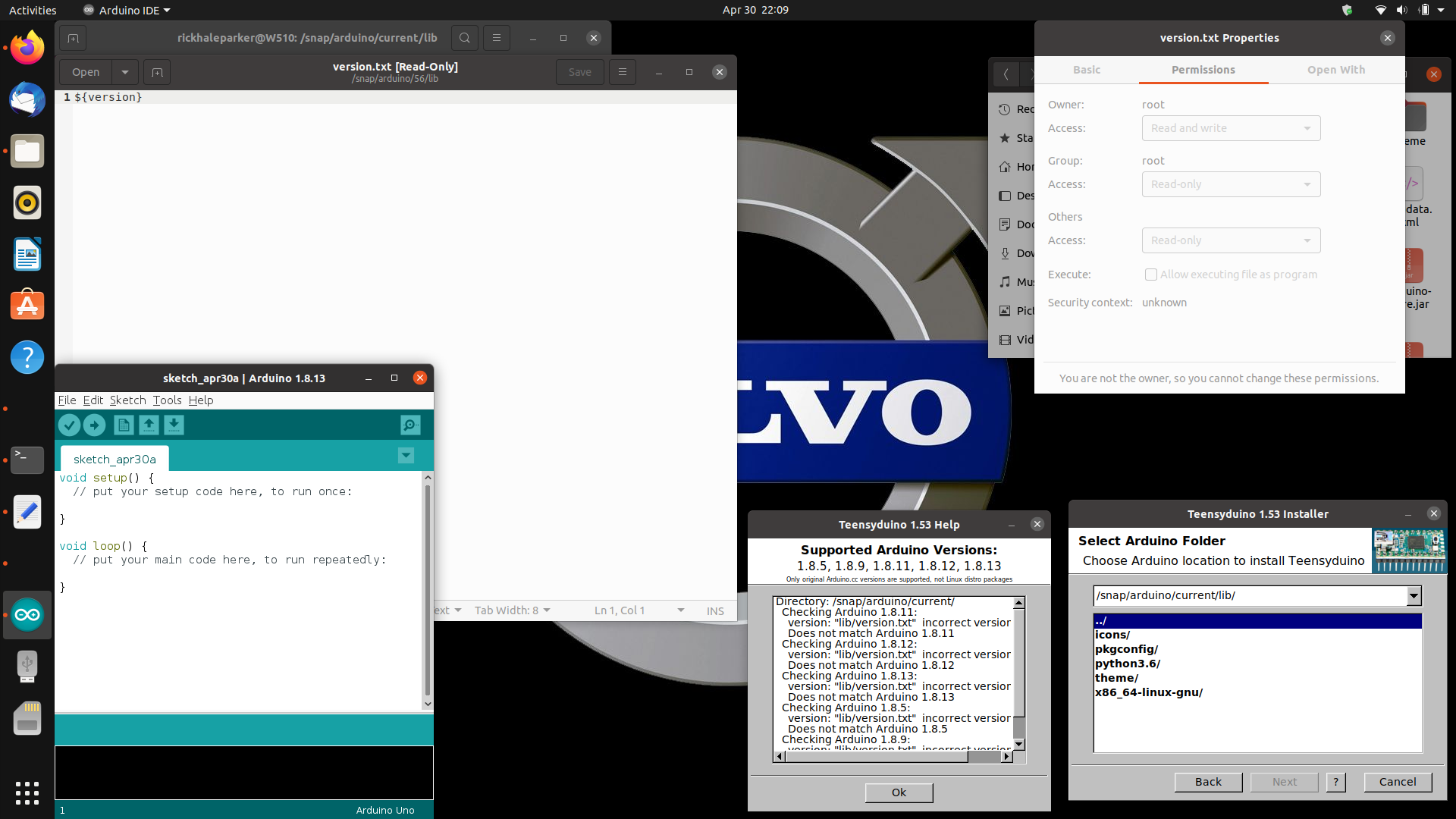

Trying to install Teensydino in Ubuntu. The version is missing from the version.txt file. Version.txt is read only cannot edit and add the version number. How do I work around this?

Post by vtl »
Don't use Snap, take IDE from arduino.cc and install it somewhere in your home folder. Snap not gonna work for Teensyduino, it wants to write into Arduino IDE installation directory.

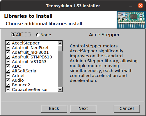

Post by RickHaleParker »
vtl wrote: 30 Apr 2021, 21:13 Don't use Snap, take IDE from arduino.cc and install it somewhere in your home folder. Snap not gonna work for Teensyduino, it wants to write into Arduino IDE installation directory.
Thanks!
Screenshot from 2021-04-30 22-30-46.png (62.03 KiB) Viewed 1357 times
