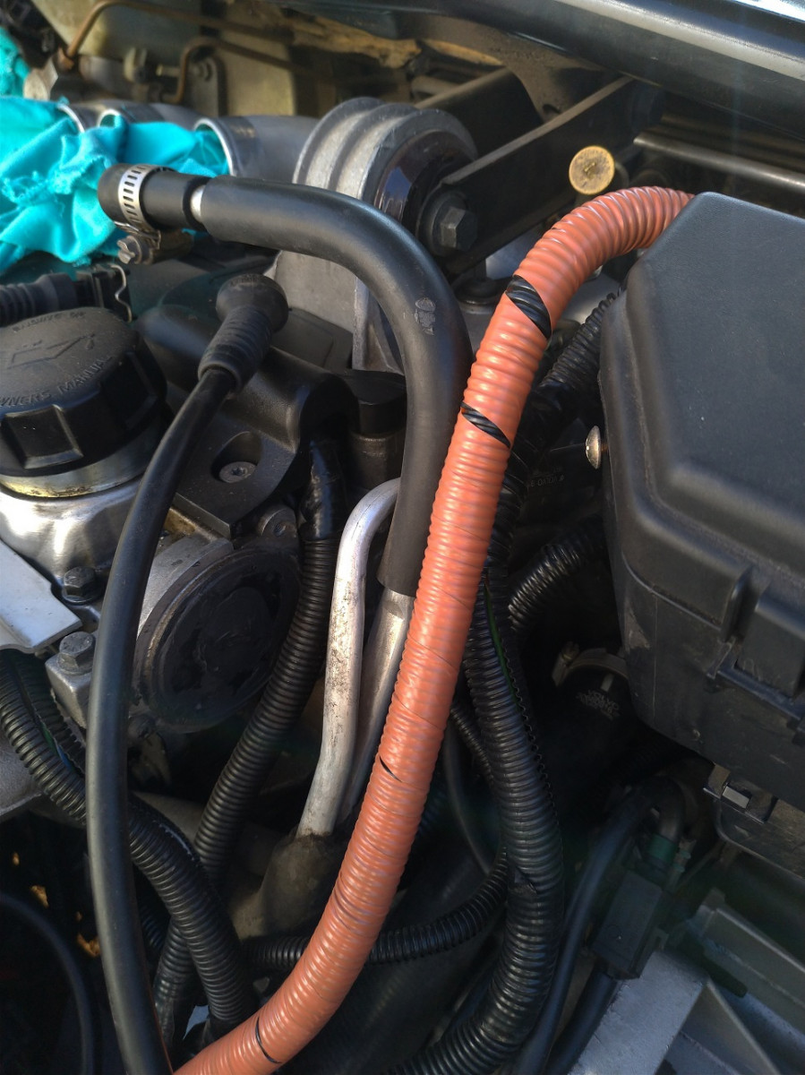

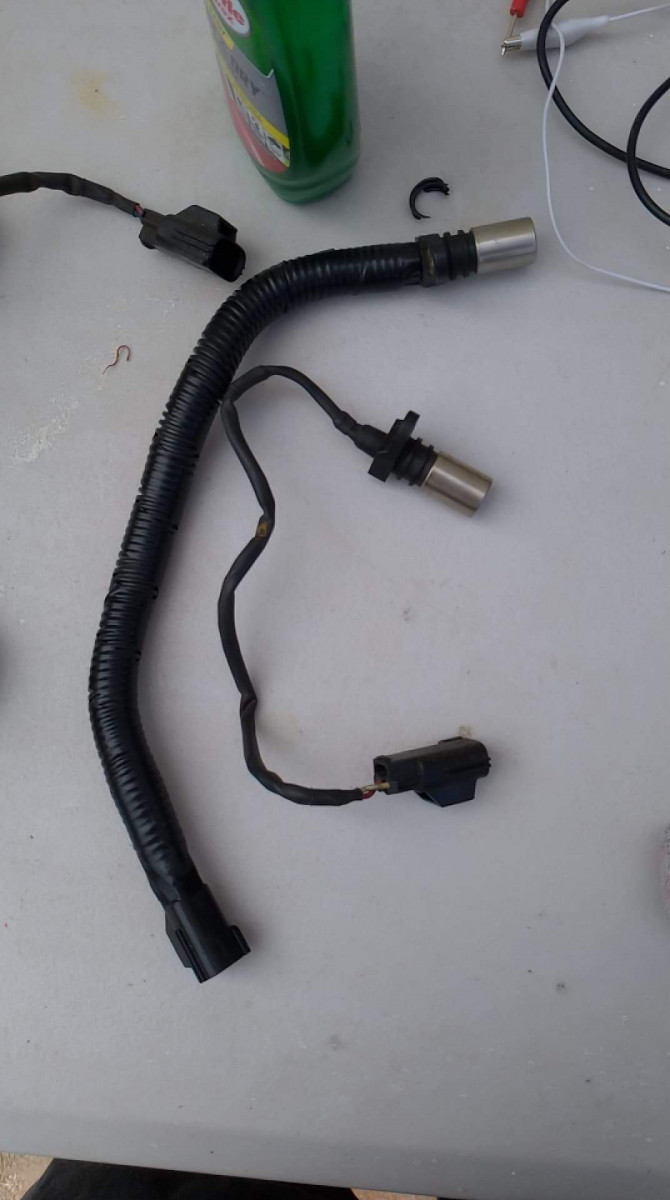

On the left is what the crank and cam sensors looked like after I wrapped them. What they look like normally on the right.
Starter cable wrapped.

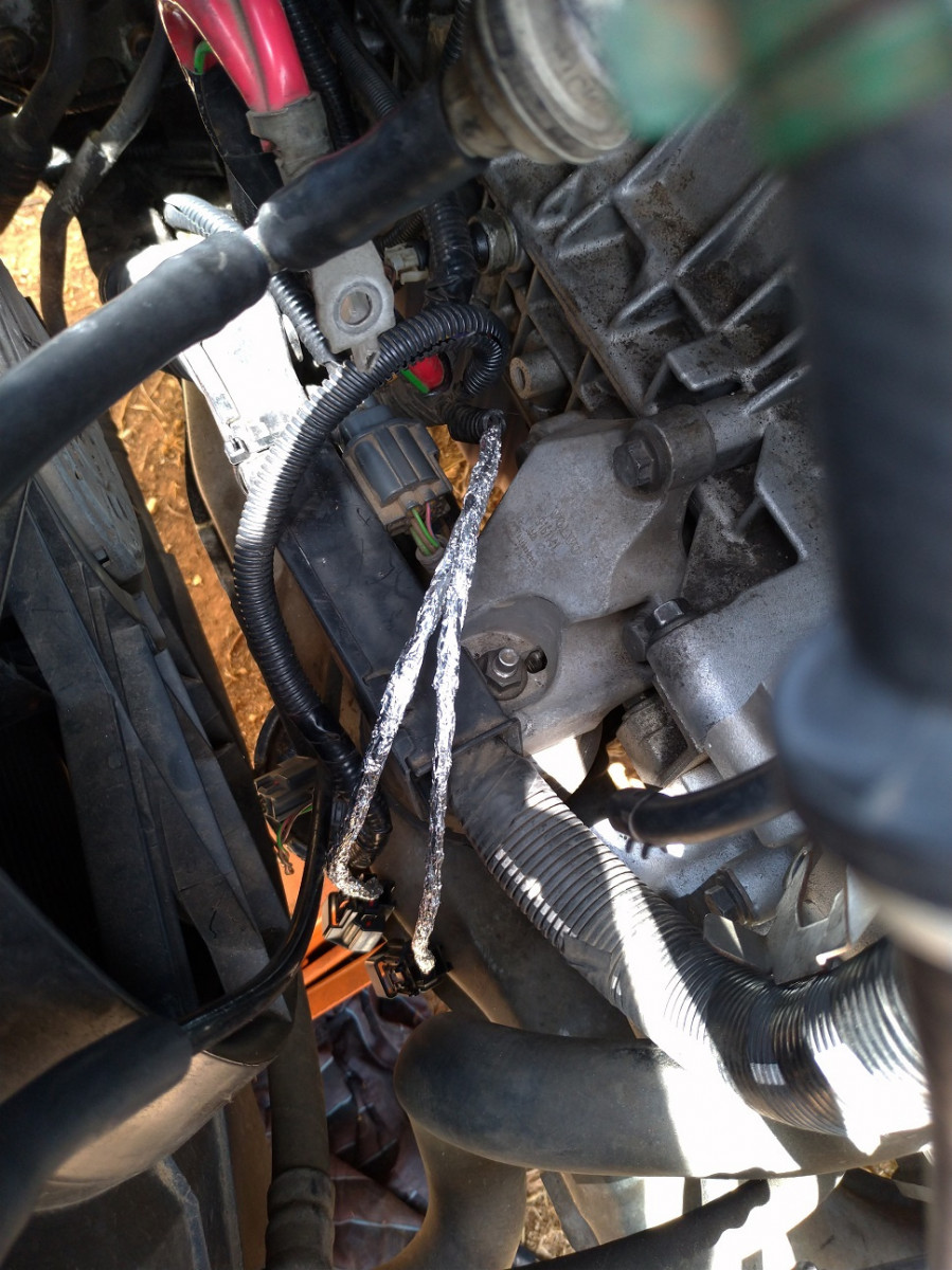

Crank and cam sensor wiring that goes behind/near the starter.
Shot of the starter shows the wrapped starter cable and the crank/cam sensor wires behind it wrapped.
